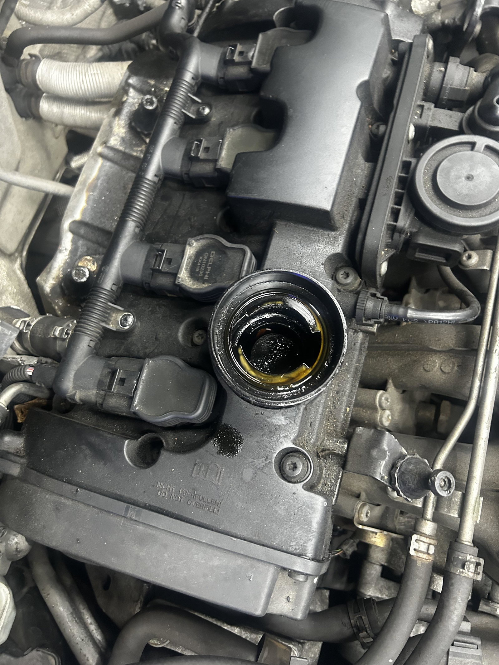

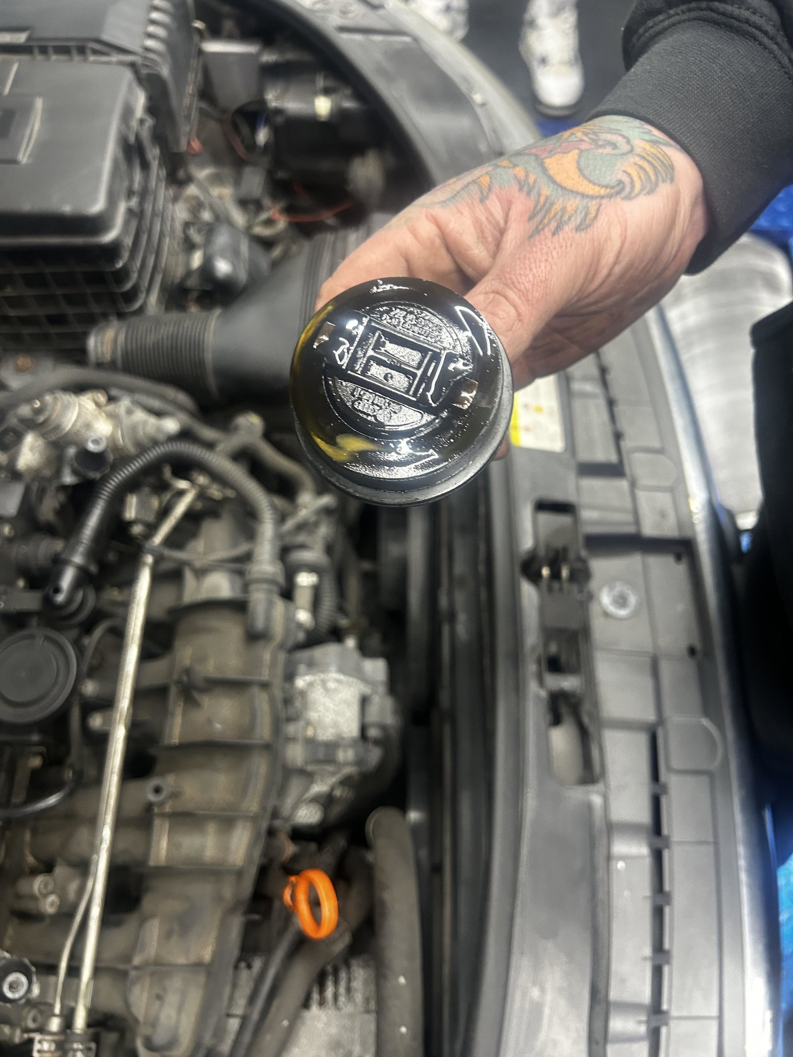

Highforce Posted March 2, 2024 Author Posted March 2, 2024 Hi all, so my mechanic would not touch it due to the map. Went to a pro map company who was going to put back to standard and dyno it. But as soon as he got in the car he mentioned a buzzing noise. Which i had also heard on the way there. he said its the low pressure fuel pump and he wont dyno it but he put it back to stock. We also found out it was mapped twice.. he conducted a smoke test, looks like engine cover was glued on… smoke test found pcv breather pipe had a split on it. So he reckons that could be the no boost detected fault. However i spoke woth the guy who got the fault codes and he is saying that surely it would be a different code if it was the fuel pump. Ive been advised to get head gasket pressure checked and if there gone im fighting for a full refund. Before i start buying parts. However in the mean time im ordering a carista gonna re check and see faults etc. kinder stuck now. As pressure test is gonna cost god knows how much. Its no got no map which is annoying. Trying to avoid a mobey pit like before. As already up to 230 to get to this stage. 😞 1
Highforce Posted March 3, 2024 Author Posted March 3, 2024 Thanks remebering my days studying motorcycle mechanics. I will ineed pressure test it myself simple device. i thought that maybe the case the tuner just put me to stock and now im at square one. I give up ahah. To my local mechanic this week now its stock, more money down the pisser but hoping to claim it all back from the seller. Looks like ill defo be going court on this one
