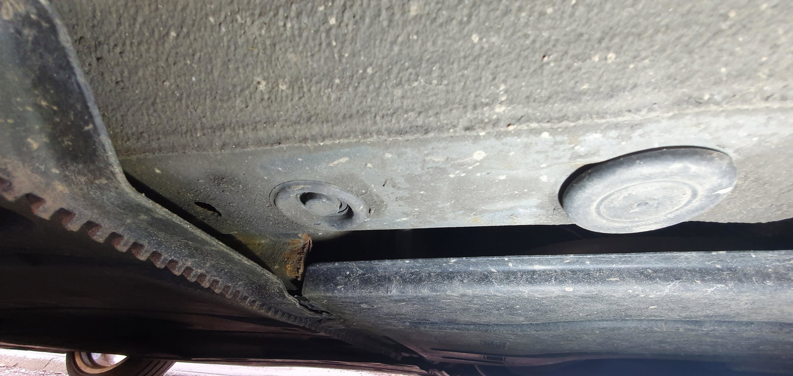

Malcs Posted February 29, 2024 Posted February 29, 2024 Hi folks, looking at getting the back of the a3 8va sportback on stands, but not 100% sure on location as always jacked up on the seam, however I need to the shocks so need to right under the car! Seen some 8V with blocks here for jacking (behind the reinforced lip) for jacking etc, but think I might be missing them, can anyone shed any light on the matter please.
Stevey Y Posted February 29, 2024 Posted February 29, 2024 3 hours ago, Malcs said: Hi folks, looking at getting the back of the a3 8va sportback on stands, but not 100% sure on location as always jacked up on the seam, however I need to the shocks so need to right under the car! Seen some 8V with blocks here for jacking (behind the reinforced lip) for jacking etc, but think I might be missing them, can anyone shed any light on the matter please. Hi a couple of six inch lengths of 4x2 wood between the axle stand and the cross member the stands dig in to the wood thats good for movement protection the other side spreads the load across the member.
Malcs Posted February 29, 2024 Author Posted February 29, 2024 13 minutes ago, Stevey Y said: Hi a couple of six inch lengths of 4x2 wood between the axle stand and the cross member the stands dig in to the wood thats good for movement protection the other side spreads the load across the member. Cheers for that, I've thought about that, might use that for jacking and use the "hockey puck" on the stands at the sill jacking point, going to be doing springs too so will need to drop the cross member. The joys of dependent axles and needing to get under the back of car. Other option is see if I can hire a bay with a lift for a day.
