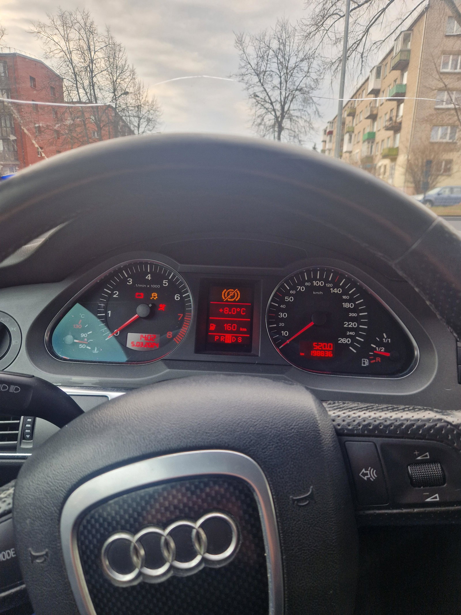

califford Posted March 6, 2024 Posted March 6, 2024 (edited) hi i have these weird problems when I try to turn on the ignition, only the mmi turns on and the steering wheel unlocks, the car won't start and nothing lights up on the dashboard ( but after few or more key turns dashboard lights turns on and car works as it was ) other problem happens that when I drive it throws a parking brake malfunction and sometimes it shuts off because of that other problem happens that when I start the car, it shuts off immediately or it shuts off while standing still. Do you have any advice for me? car is audi a6 c6 2004 2.4 automatic Edited March 6, 2024 by califford

califford Posted March 6, 2024 Author Posted March 6, 2024 On 3/6/2024 at 4:15 PM, jasonj said: Hi Vilius , You have to then Clear the Fault Code on OBD reader . The Parking Brake Malfunction Code has to be Cleared, could be ? ( 00526 or 17087 ) this code has to be cleared . So 1: Do the switch Ignition OFF for 5 seconds then switch ON again . with OBD Reader plugged in . And Then Clear all the codes . Unplug OBD . Start car and then see if any codes are showing . By doing another Reading with OBD. Jasonj Expand after clearing all codes ( there was only one 0003 ), it shows nothing now. Im starting to think about ECU, ECM. Because there was water in this sector when water channels was clogged. I will try to remove it and inspect it, and update it here. 1
califford Posted March 6, 2024 Author Posted March 6, 2024 On 3/6/2024 at 4:34 PM, jasonj said: Hi Vilius , Have all the codes disappeared ? If so it tells me ECU is ok as it recognises the removal of the code . The way it works is the Instrument Control Module Locks the Codes into its Memory . If this has now been cleared . Current Status 1: Have all the codes gone Now ? 2: Does the Car Start without any problems ? 2A: Is there any warning lights on the Instrument Cluster ? Jasonj Expand 1. Yes 2. Yes 3. No after some time its gonna happen again. Now the fault codes are cleared its going to be ok i think. 1
