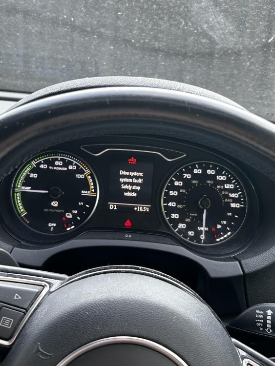

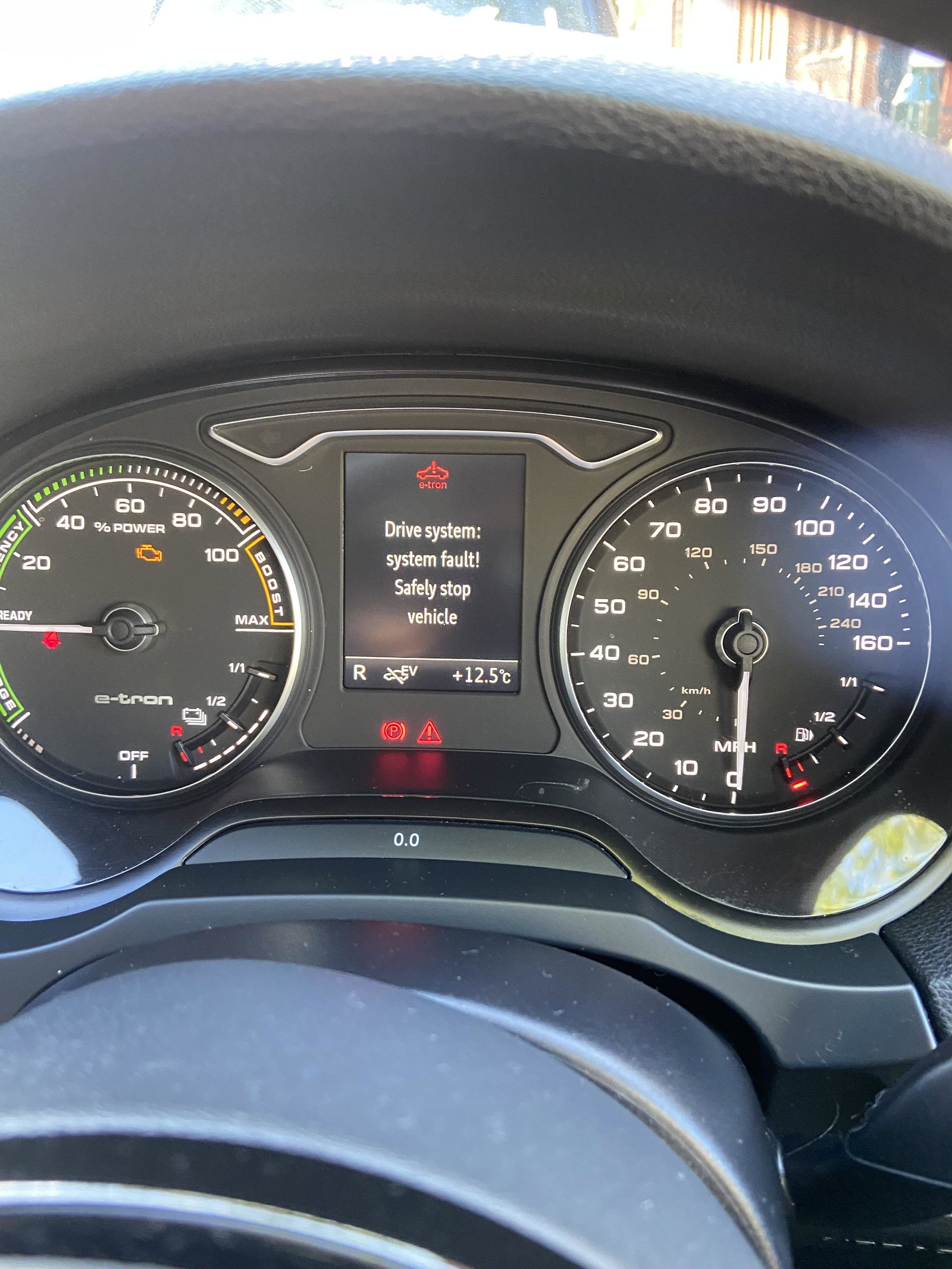

markymarkmck Posted April 19, 2024 Posted April 19, 2024 Hi, This is my first post on here but I was hoping someone could help me with a couple of issues. 1. I was driving long distance and about 90 mins in I received a red error saying "Drive System: system fault! Safely stop vehicle". I managed to pull over at a garage where a mechanic kindly plugged in a diagnostic but it showed no issues. I am still getting the error system every time I turn on the car though. And it drives as normal. No issues at all. It was spilling rain so I do wonder if a sensor got damp somehow. But I can't figure it out. 2. A long standing issue, the MMI randomly pops up and down every 2nd or 3rd time I start the car. Sometimes the radio won't engage when this happens. About the rest of the time, it works perfectly. 3. Final issue I'm having, the rear wiper fluid no longer pumps out water. I wonder if it's a blockage or just a faulty pump. Anyway, the first issue is the main one. Has anyone experienced this before and it is a simple reset fix? Thanks.

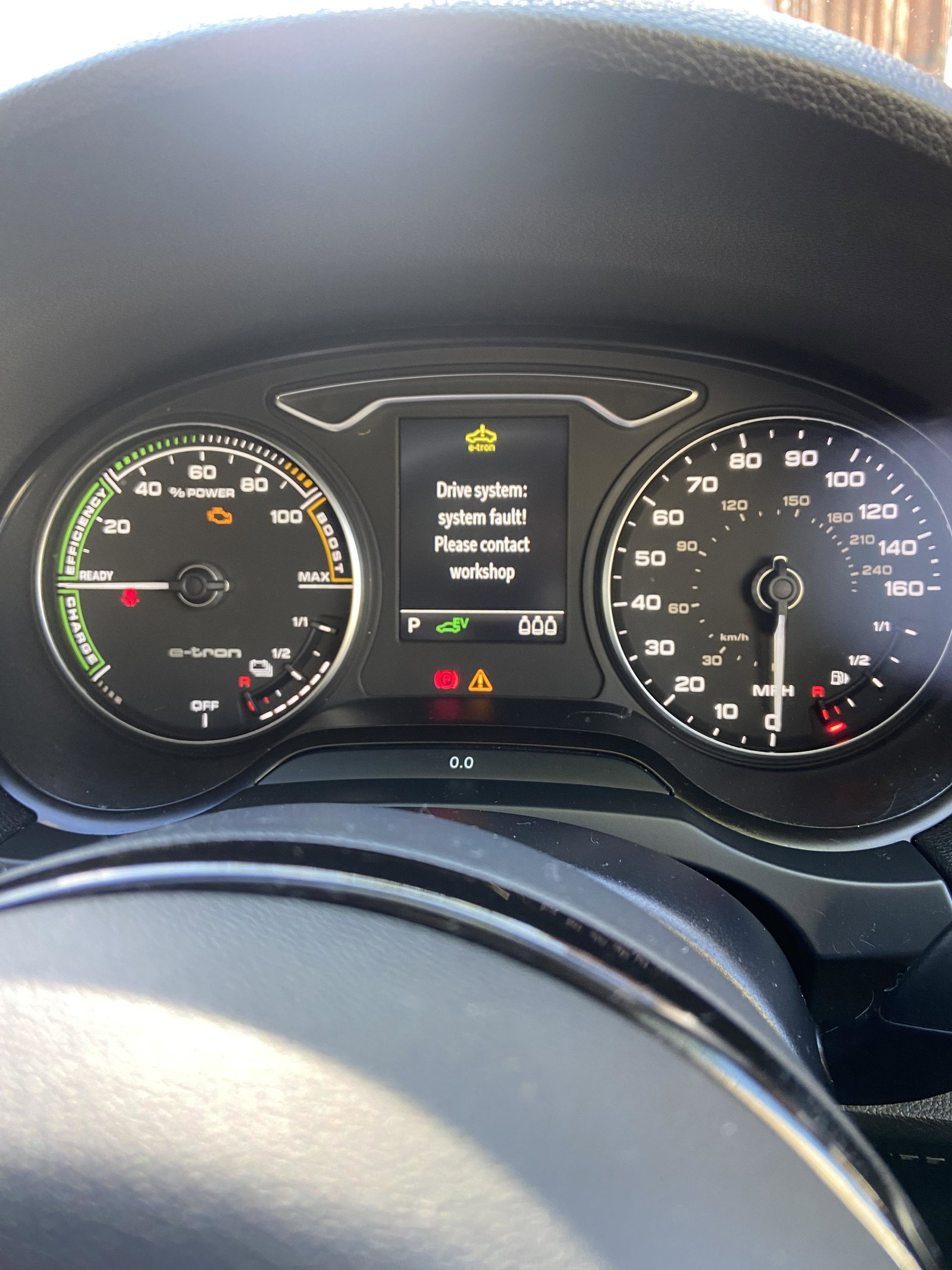

Frankstewart Posted May 27, 2024 Posted May 27, 2024 Hey, any update on this initial issue? Just had the exact same on my 2016 a3 etron. Very concerned!

Frankstewart Posted May 27, 2024 Posted May 27, 2024 Mine is in with Audi now, they advised me to tow it over so I towed it over last week. They said they need to take 5 battery readings across 5 days to determine the issue and rang me today to confirm there’s a genuine battery issue. I checked and there’s an outstanding campaign on the battery in my car for seals on the hybrid battery which may warrant new casing on the battery or a full battery replacement depending on the damage once they open it up (if corrosion present they replace) however they can’t confirm to me whether this will be valid on my car due to the length that this recall is open (I bought the car in apr 2021 without realising it had an open campaign from 2020) so it could be out of pocket for me which at that point at 8k or more for a battery it’s not worth it as the car is valued at €10k. I’ll be devastated if that’s the case, I was never made aware of the recall and now may be majorly out of pocket!

Frankstewart Posted July 25, 2024 Posted July 25, 2024 Hey, my car is still in Audi over 2 months later. They need to replace the hybrid battery, issue with the seals and water has gotten in to the battery. I’m hopeful because my car battery was never replaced that it might be covered. No confirmation and if not, the cost is 15k for parts and labour
markymarkmck Posted July 26, 2024 Author Posted July 26, 2024 Ours has been a nightmare. Same issue, the casing has come away from the hybrid battery and moisture got in there. Car is atill at Audi Watford and has been for nearly 2 months. Sounds like an identical issue to some of you. Audi have said that as my battery warranty is up (6 months ago). There’s nothing they can do and to fix it will cost £32,000. Crazy stuff. We’re now in a battle with our finance company to pretty much prove this isn’t our fault and that they need to replace our car. They are currently refusing and expecting us to just keep paying them, with the written off. I don’t believe our fully comp insurance covers it either. 1

Tigermaul Posted July 26, 2024 Posted July 26, 2024 I do think Audi are hiding behind ‘out of warranty’ to disguise what is a known issue with Etron plug-in hybrids. What I would recommend is you go to an independent EV mechanic - the one I used is ex Audi West London. He says all EVs are prone to water ingress because of aluminium which as it corrodes expands (?) thus the seals fail. And there was a recall in the US for exactly this issue. Anyway mine had water dripping out of the EV controller (which is considered part of the battery). Audi themselves claimed out of warranty, not interested in even any goodwill. EV battery repair kits exist but Audi main dealers won’t work with them. My independent man ordered and fitted a new EV controller and with labour that was £2k - but afterwards the car worked better than new, with a greater EV only range with the new software. However after all this I’d lost faith, and traded it in for a 12-month-old (non Audi) full EV which still had seven years of battery warranty left. Huge depreciation on EVs (50% in a year for the one I bought) meant I could afford the finance. I’d never buy a hybrid or EV again without a long manufacturer’s warranty - the cost of EV battery replacement is obscene.

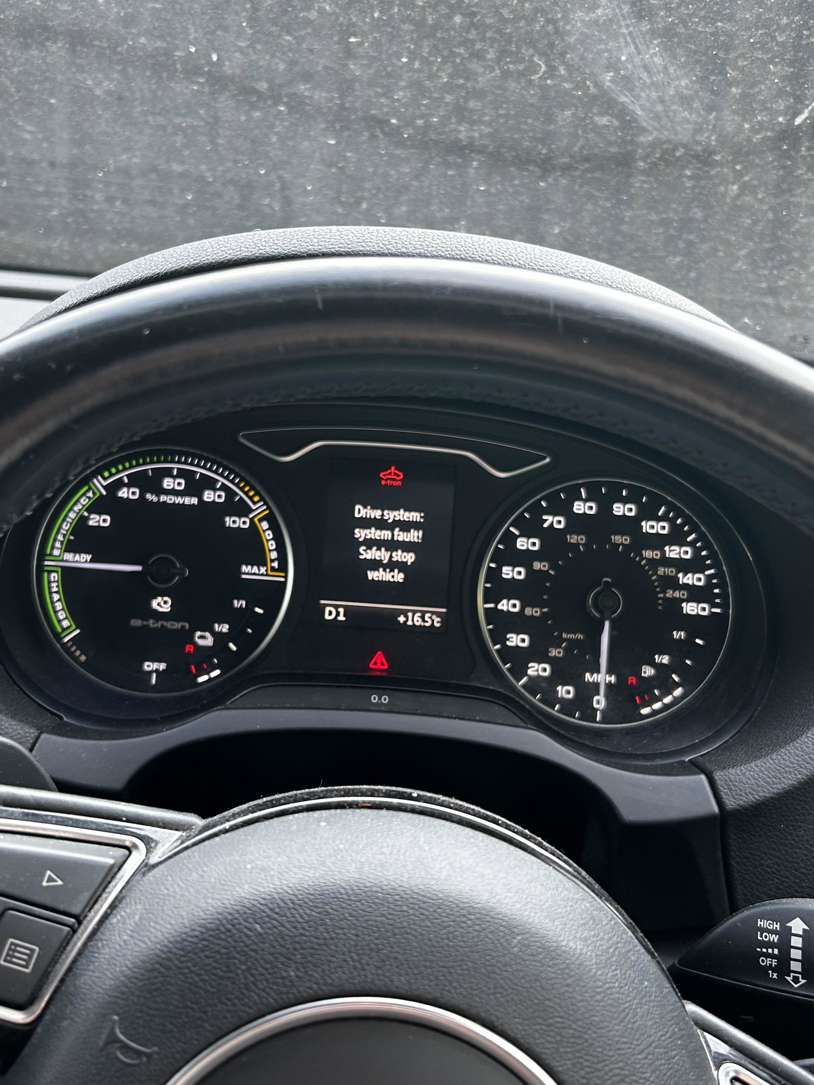

oohmsjones Posted October 8, 2024 Posted October 8, 2024 Same thing has just happened to me! Driving in heavy rain on the dual carriageway, got the same message. No loss of power, driving fine. Also a 2015 A3 E-tron. Currently waiting for RAC to check it over, hoping I can at least get it home as I’m 30 miles away! I’ve got a really good local independent mechanic who works with EVs and hybrids so hopefully he can sort it.

Tigermaul Posted October 8, 2024 Posted October 8, 2024 Hi all. I got mine fixed via Dan at MMS Technik mmstechnik.co.uk. He’s excellent, cheap and ex Audi West London. His workshop is at Ranmore Common, Effingham, Dorking but he also offers a mobile service in London and Surrey area and is loosely attached to a garage in Hampton Hill. Water had got into my EV controller, out of warranty. Audi wouldn’t help in terms of goodwill even though it’s a known issue but Dan sourced a new EV controller, reseated the battery properly, and afterwards was working better than new with a better electric range. I think it cost me around £2k. He took a video showing water literally dripping out of the EV controller.

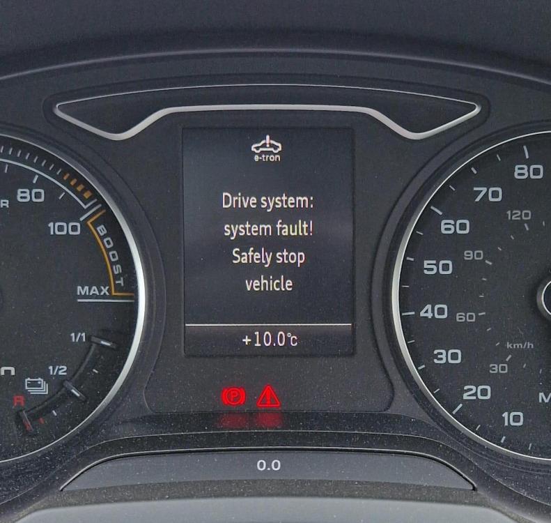

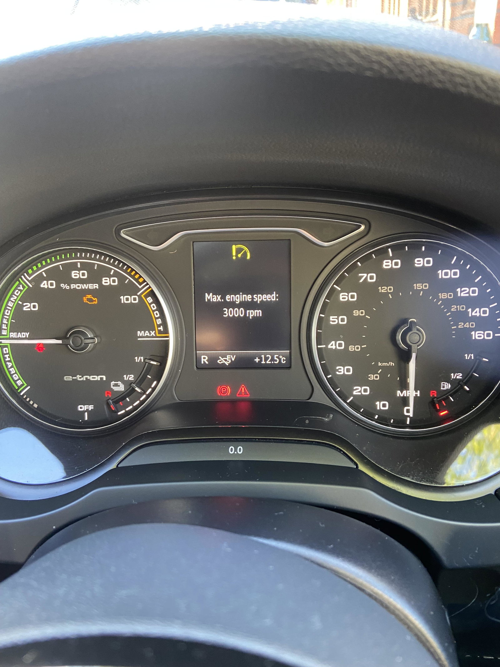

Heal34 Posted December 29, 2024 Posted December 29, 2024 (edited) Hi guys, any further update on this issue? I almost brought an Audi 67 plate A3 e-from hybrid today, at the last moment I saw the red “Drive System Fault: Safely Stop” and the “Max RPM 3000 error and stopped the purchase process. I don’t know what the issue is, or if the dealer knew about this but “cleared” the error code before the test drive. Do you think the battery is still under warranty? It was registered 8th September 2017. Do you guys advise against buying this car? Even if Audi fix this issue? I love the car and how it drives, so gutted this issue has come up. Edited December 29, 2024 by Heal34
Frankstewart Posted December 30, 2024 Posted December 30, 2024 Hey, my advise is don’t buy it, not worth it!! Lots of hassle and while Audi did cover my repair, I think it seems to be rare that they did.
