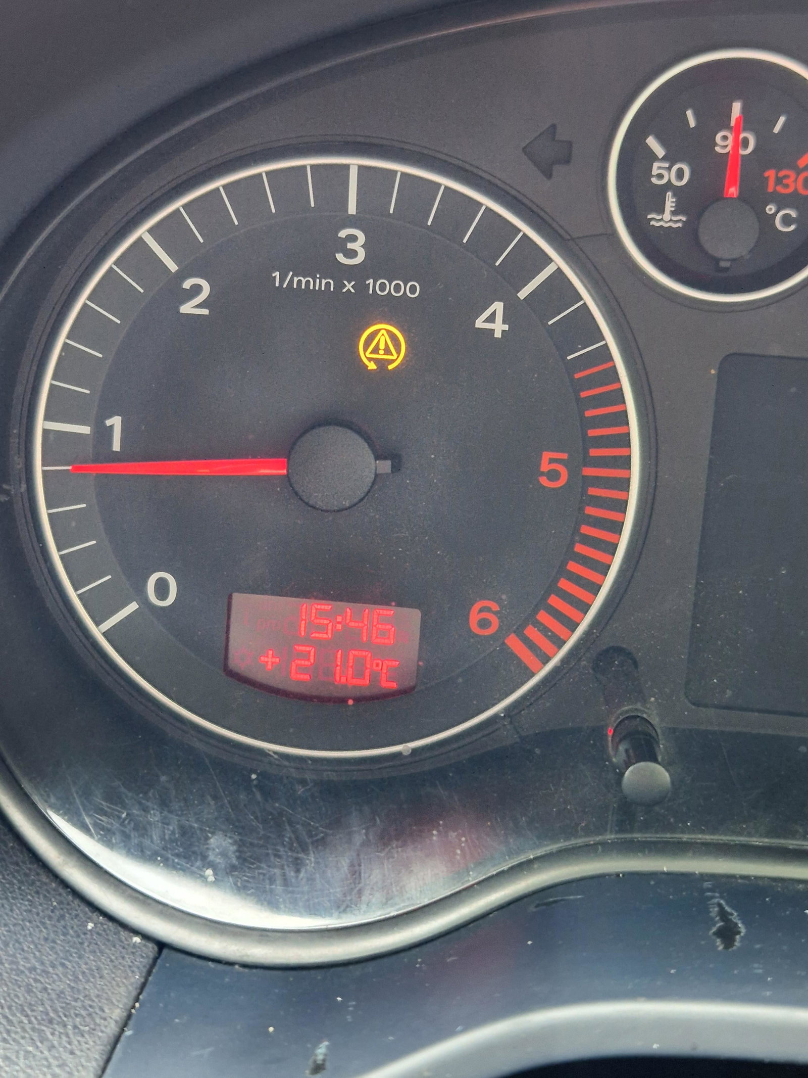

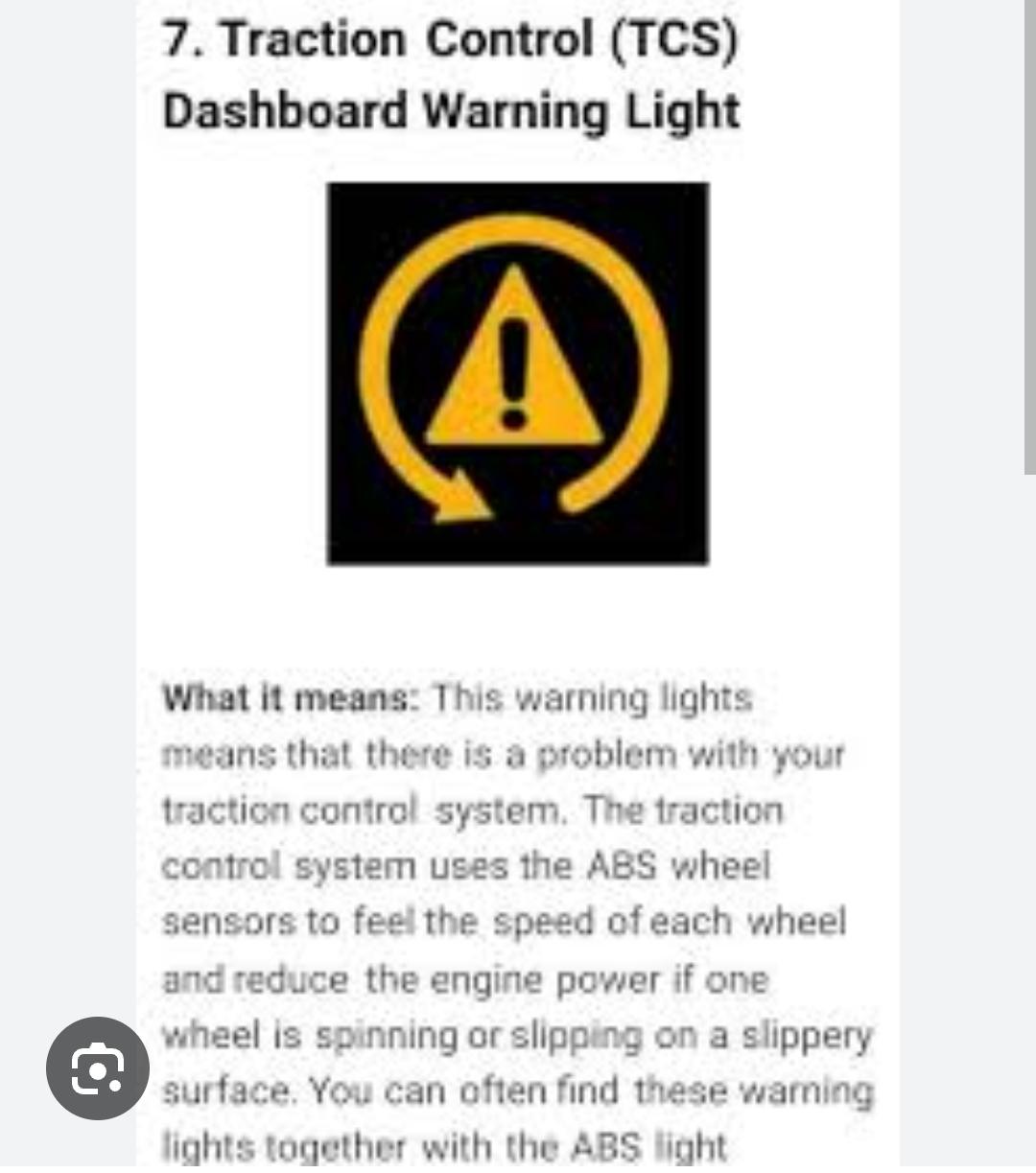

Hi mate, No I don't think so, ESP is a car with squiggly lines, and my ESP switch will not do anything?

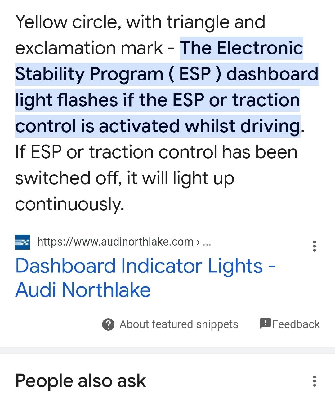

It's the power speed triangle
Hi Rybrook.
So that light is on all the time and ESP will not do anything, so what are you recommending to get the light off, replace abs sensors on every wheel?
You need to see which sensors aren't working, if you have the car plugged in you can monitor the abs sensors, they should read the same or thereabouts.
Is the abs light on at all?
Hello Matt,
Replacing the ABS sensors on all wheels is not the way to go.
Getting it plugged in to diagnostics is - to home in on the offending component.
