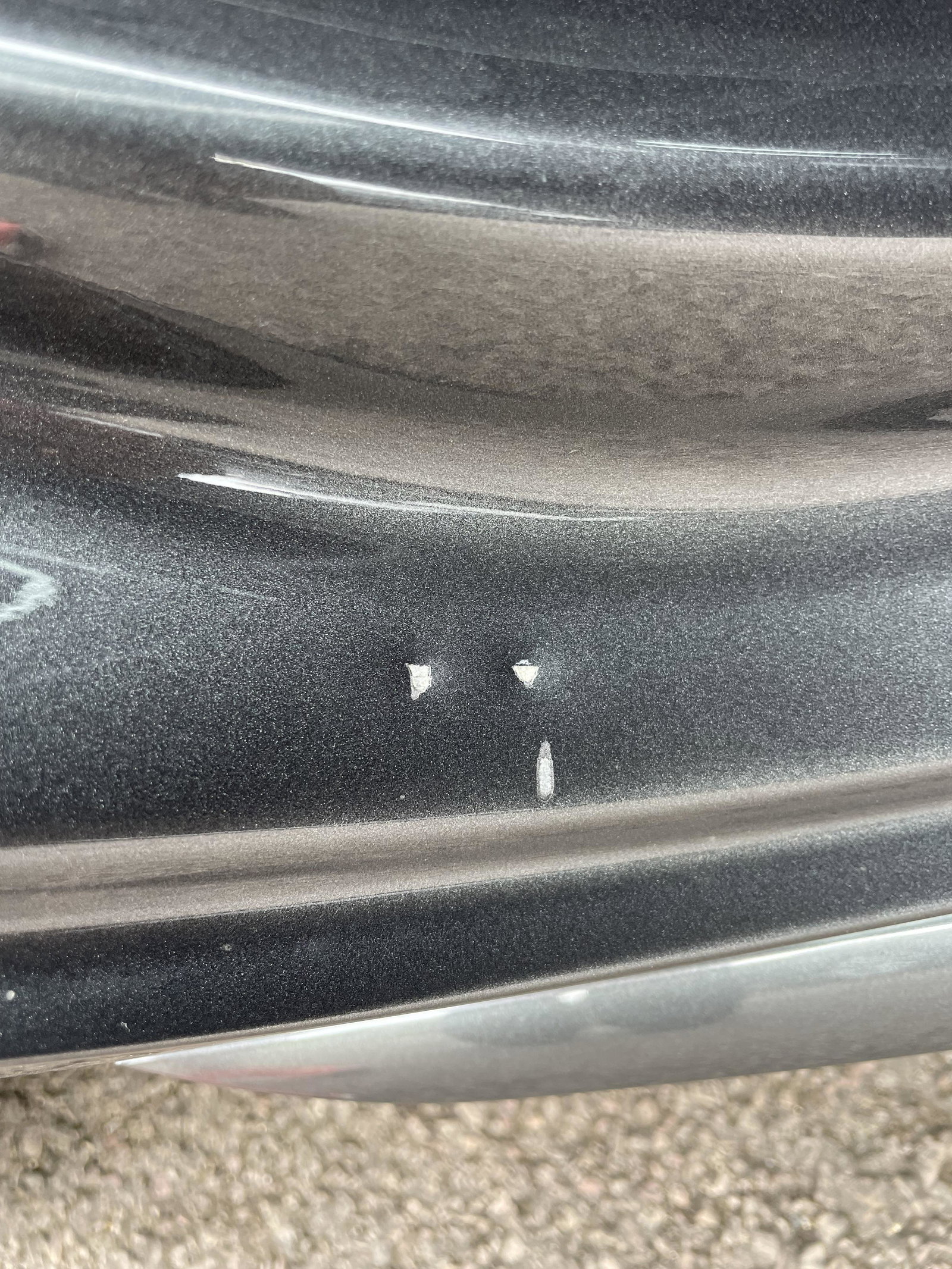

Shells Posted June 13, 2024 Author Posted June 13, 2024 I received a reply, they have declined my rejection stating that the workshop has assessed the whine as a characteristic of the car and as a result no fault was found. He apologised for the damage caused and is checking CCTV and if confirmed caused by them, will offer to repair it free of charge. I have cancelled the appointment I had tomorrow for the vibration/rumbling issue to be diagnosed and repaired, after seeking advice from the consumer rights helpline and I have booked the vehicle in for a second opinion with another dealership, but not until 2nd July! Another mechanic friend of mine has suggested the noise sounds like a bearing in the gearbox or driveshaft/differential bearing. This is what my gut is telling me too! I would not expect a 4 year old Audi to make such a loud noise from a mild hybrid system that isn’t even working throughout the speeds that I’m experiencing the noise. The consumer rights helpline has suggested I formally write a letter using their templates and send by recorded delivery, which I will draft tonight, giving them 14 days to respond. Despite this taking me outside of my 30 days short term right to reject, this should still be honoured as I am making the rejection within the first 30 days. This is going to be a big battle, wish me luck. I have lost all confidence in the dealership now. 1

Shells Posted June 25, 2024 Author Posted June 25, 2024 Well, finding someone to take ownership of this issue at Heritage has been and continues to be challenging. Nobody has got back to me about the damage caused when it was with them on 11th June. I requested copies of the diagnostic paperwork they completed on 11th June and got no reply. I followed the advice of the consumer helpline and sent a letter recorded delivery to my dealer and it was returned as ‘addressee gone away’. I then sent the letter attached to an email of complaint to the sales manager and the after sales manager. The complaint was: 1. The car being faulty with two problems and wanting to reject it for a full refund under consumer rights 2. The damage caused to the car when it was with them for diagnostics I got a reply yesterday saying that he would be in touch today. I have also filed a dispute with my credit card company over a week ago and am still awaiting the paperwork for this, I am holding them jointly liable for the whole amount as I paid the deposit on credit card. meanwhile, I am paying to insure a car that’s been sat on my driveway for over two weeks waiting for someone to take ownership and resolve this matter.
