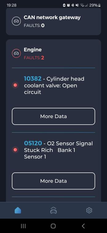

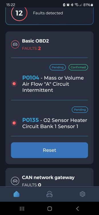

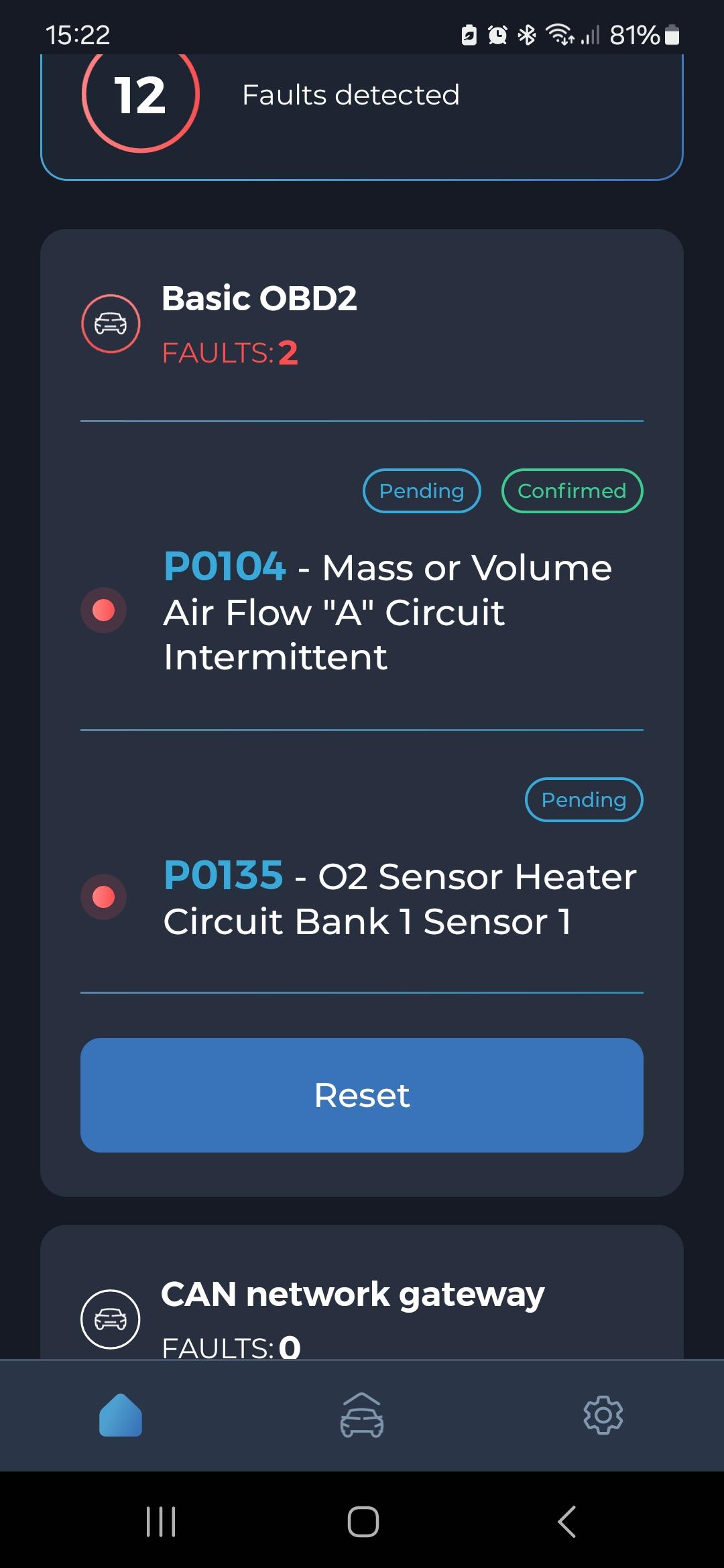

a6blacked007 Posted June 3, 2024 Posted June 3, 2024 (edited) Hi guys looking for some help with my 2010 3.0 tdi getting code p0104 replaced maf with my friends a7 3.0 tdi but fault still won't clear there's also a fault for oxygen sensor which has been there since I bought car eml is on immediately starting car it will go once reset but returns next start fault on carista won't reset though...fault started abput a month ago Not sure we're to look next .... Edited June 3, 2024 by a6blacked007
Steve Q Posted June 3, 2024 Posted June 3, 2024 From the lok.of it Yiu need to replace the maf sensor. Is it running rough? 1
a6blacked007 Posted June 4, 2024 Author Posted June 4, 2024 9 hours ago, Steve Q said: From the lok.of it Yiu need to replace the maf sensor. Is it running rough? No, Steve is running perfectly, tbh I thought by trying me friends, maf, yesterday fault would clear as he has same engine but it never cleared with carista
Steve Q Posted June 4, 2024 Posted June 4, 2024 5 minutes ago, a6blacked007 said: No, Steve is running perfectly, tbh I thought by trying me friends, maf, yesterday fault would clear as he has same engine but it never cleared with carista Good way of diagnosing it. Shame it's not maf then.

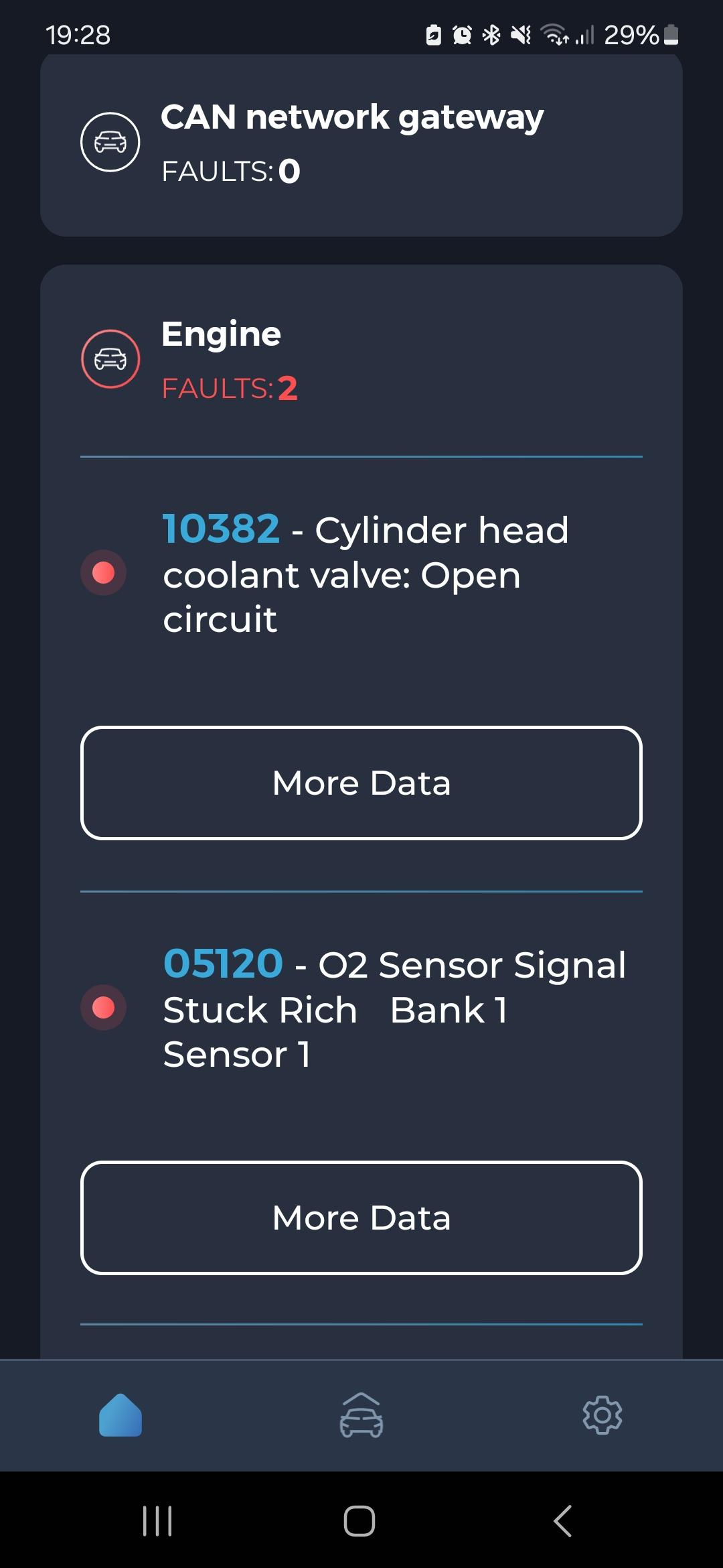

a6blacked007 Posted June 4, 2024 Author Posted June 4, 2024 (edited) Cleaned maf and map with brake cleaner along with no1 02 sensor Steve don't want to go throwing parts at it as these sensors are expensive but sure where too look next. Wondering if maf needed a drive to confirm flow as I just fitted and started car then removed ... Edited June 4, 2024 by a6blacked007
Stevey Y Posted June 4, 2024 Posted June 4, 2024 5 hours ago, a6blacked007 said: Cleaned maf and map with brake cleaner along with no1 02 sensor Steve don't want to go throwing parts at it as these sensors are expensive but sure where too look next. Wondering if maf needed a drive to confirm flow as I just fitted and started car then removed ... Hi its most likely the oxygen sensor, problem being when you put the other MAF on it will need re adaption and cleaning both with brake cleaner wont help, contact cleaner is better as it wont strip the coating off the MAF diode, the o2 sensor is the same as its coated inside with palladium and other precious metals but if the heater is going no amount of cleaning will cure it, with regard to throwing money away a new sensor is not that expensive but still needs adaption when fitted. Steve.
a6blacked007 Posted June 4, 2024 Author Posted June 4, 2024 (edited) Ho Steve thanks for your reply that code only came up because a ran car with sensor unplugged and removed from exhaust off car cleared after reinstalled but 02 sensor running rich has always been there since I have owned car ... Do you think replacing o2 sensor would be best to do 1st Regards mark Edited June 4, 2024 by a6blacked007

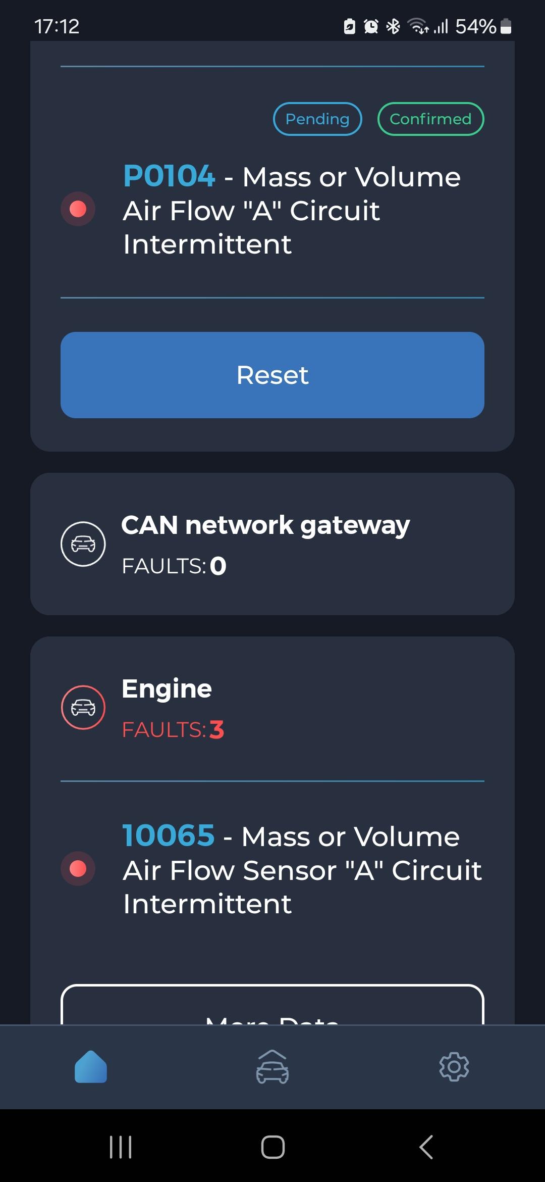

a6blacked007 Posted June 4, 2024 Author Posted June 4, 2024 Hi going through carista air mass value is stuck on 249.99
Stevey Y Posted June 4, 2024 Posted June 4, 2024 40 minutes ago, a6blacked007 said: Hi going through carista air mass value is stuck on 249.99 Hi if both items have been on the car since new it might be worth changing both for Bosch units, O.E. on average most oxygen sensors and MAFs only last about 80k or three years and gradually go what's known as blind the o2 sensor especially, the MAF heats up and measures how long it takes to cool giving a raw value of the speed and ambient air temperature coming in, the 02 sensor does exactly the same thing but because of the precious metal coating inside it only measures the oxygen level in the exhaust gas stream, both are easy to change but will need re adaption to learn new values. Steve. 1
