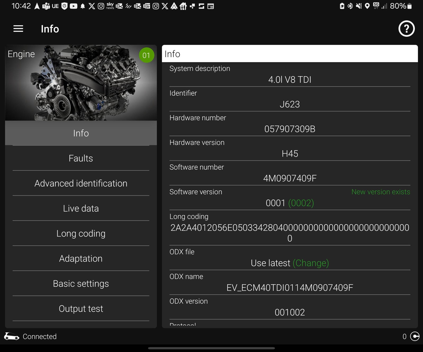

scottiecb19 Posted November 13, 2024 Posted November 13, 2024 9 hours ago, peetee7 said: Hiya mate yes! All solved update the ECU software from 1004 to 1005. That’ll fix the cold start issue. Join the SQ7 UK & Europe owners Facebook group I've got an OBD11 scanner - is there any way to see the software version on that. I had a stage 1 on mine recently, and the garage said they always flash to the latest firmware. However I'm still getting the judder, so feel a little sceptical.

peetee7 Posted November 27, 2024 Author Posted November 27, 2024 On 11/13/2024 at 9:31 AM, scottiecb19 said: I've got an OBD11 scanner - is there any way to see the software version on that. I had a stage 1 on mine recently, and the garage said they always flash to the latest firmware. However I'm still getting the judder, so feel a little sceptical. Hiya mate. Yes your OBD11 scanner should tell you the ecu software version. It'll be either 1004 or 1005. If you've got 1005 and still getting the judder then the issue is more than likely carbon build up in the intake manifolds and other components. Thanks to the emissions hardware! Take care.
scottiecb19 Posted November 27, 2024 Posted November 27, 2024 (edited) Thanks for the reply. I've looked everywhere in OBD11 and can't find the software version - even noting the link above. I've got a Topdon AirDiag 600, might have to try that, but if it is 1004 then I don't know how to get it updated other than to take it back to the tuners. I'm worried they did nothing with the car, the Stage 1 resulted in no 0-60 improvement (not a boy-racer I'd add, but it's a good metric to test). Edited November 27, 2024 by scottiecb19
peetee7 Posted November 27, 2024 Author Posted November 27, 2024 The app I use is OBDeleven VAG on my iPhone. Its a black colour app icon with a white colour animal with the text 'for VAG' on the bottom Take a look, its definitely in one of the sub options. If you struggle happy to meet up at a services nearby and check for you. No bother at all 1
scottiecb19 Posted November 27, 2024 Posted November 27, 2024 THat's very kind of you. I'll have to have another look - it's the app I'm using and I've unlocked the ultmate sub or whatever they call it. Just checking engine info (as per the above pic) I saw the info breakdown but software version was not on it. Puzzling.
peetee7 Posted November 27, 2024 Author Posted November 27, 2024 (edited) Looks like i took a screenshot on the app. See if you can get to the following screen .. Edited November 27, 2024 by peetee7
scottiecb19 Posted November 28, 2024 Posted November 28, 2024 Hi @peetee7, just wondering if you've got any ideas on the above? Do I need to take it back to the tuners to get them to upgrade again?
scottiecb19 Posted December 9, 2024 Posted December 9, 2024 Does anyone know what software version 0001 means in relation to others which say 1006?
