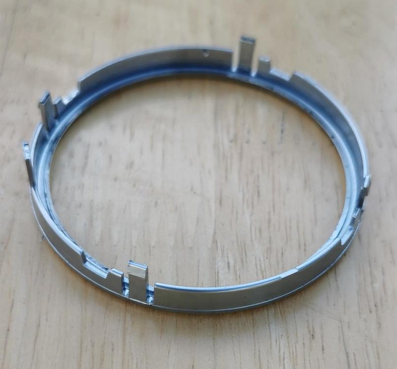

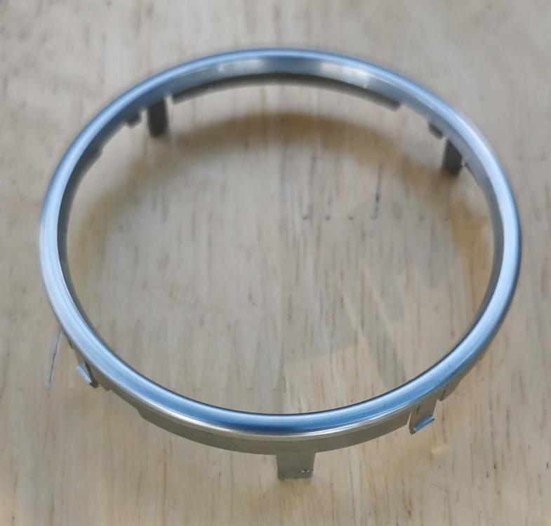

Stvn66 Posted June 7 Share Posted June 7 Hi, Can anyone please explain how to re-align the metal ring surround on the air vent. It has many tabs and slots and I can't figure out how to re-engage it? Thank you Quote Link to comment Share on other sites More sharing options...
Solution Stevey Y Posted June 7 Solution Share Posted June 7 10 hours ago, Stvn66 said: Hi, Can anyone please explain how to re-align the metal ring surround on the air vent. It has many tabs and slots and I can't figure out how to re-engage it? Thank you Hi pretty straight forward if you look at the second picture the tab in front of you has no locking hook, that is the position tab which is lower and wider than the rest so if you find the reciprocal slot on the vent once located it should just push in. Steve. Quote Link to comment Share on other sites More sharing options...
Stvn66 Posted June 7 Author Share Posted June 7 Thank you, done it 🙂 Quote Link to comment Share on other sites More sharing options...
