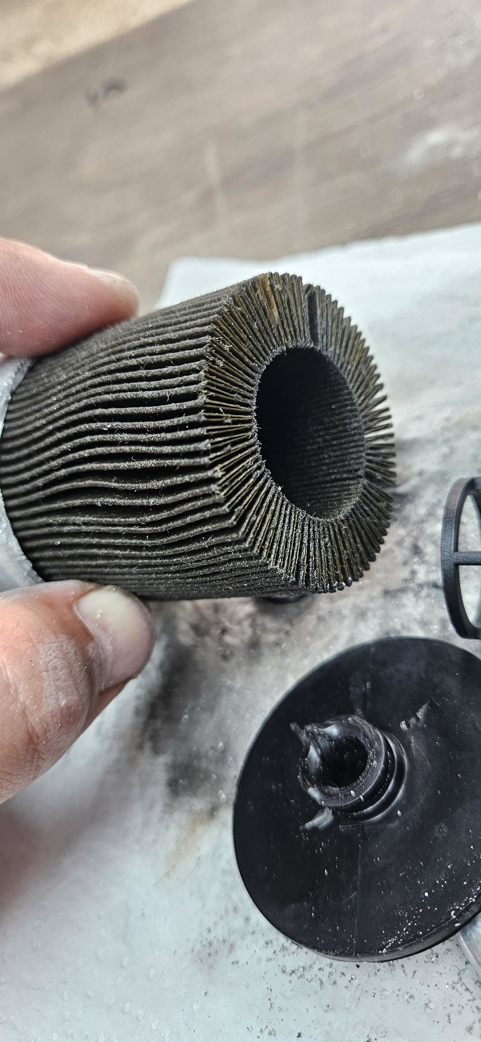

Rybrook Posted June 10, 2024 Posted June 10, 2024 Hi My recent purchase has been ace to drive, then the offside rear wheel bearing decided it didn't want to have abs anymore, and promptly despatched the sensor with the magnetic ring. Now I have a couple of lights on the dash, standard abs and traction lights which is understandable. Also the headlight range adjuster is on and the eml with p1617 code which is a glowplug short circuit to ground. Only things done to the car is a full service including all filters and I fitted dry induction kit. Car hadn't been serviced since 2017. Fuel filter was cut open and looked like it had fungus growing like the junk on diesel filters from biodiesel. Just can't work out the p1617 code. Cheers
