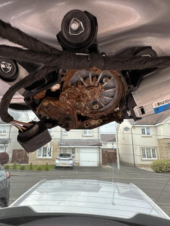

Davidacarrick Posted June 17, 2024 Author Posted June 17, 2024 @Stevey Y not having much look at minute. Rear wiper packed up earlier….that’s a mess in there
Davidacarrick Posted June 17, 2024 Author Posted June 17, 2024 And clutch release bearing is sticking it sounds like too now!
Steve Q Posted June 18, 2024 Posted June 18, 2024 12 hours ago, Davidacarrick said: @Stevey Y not having much look at minute. Rear wiper packed up earlier….that’s a mess in there Common issue on vag cars unfortunately.
Stevey Y Posted June 18, 2024 Posted June 18, 2024 15 hours ago, Davidacarrick said: @Stevey Y not having much look at minute. Rear wiper packed up earlier….that’s a mess in there Hi they fail because the water for the washer flows back down the spindle and through the rubber grommet in the window, took me a while to work that out, so when you replace the motor also replace the grommet with a liberal coating of silicone grease, grommet is about £16.00 on eBay, had three motors on mine but the last one was still good when the car went so the grommets definitely a winner.
Davidacarrick Posted June 18, 2024 Author Posted June 18, 2024 Cheers have picked up the full unit to replace
