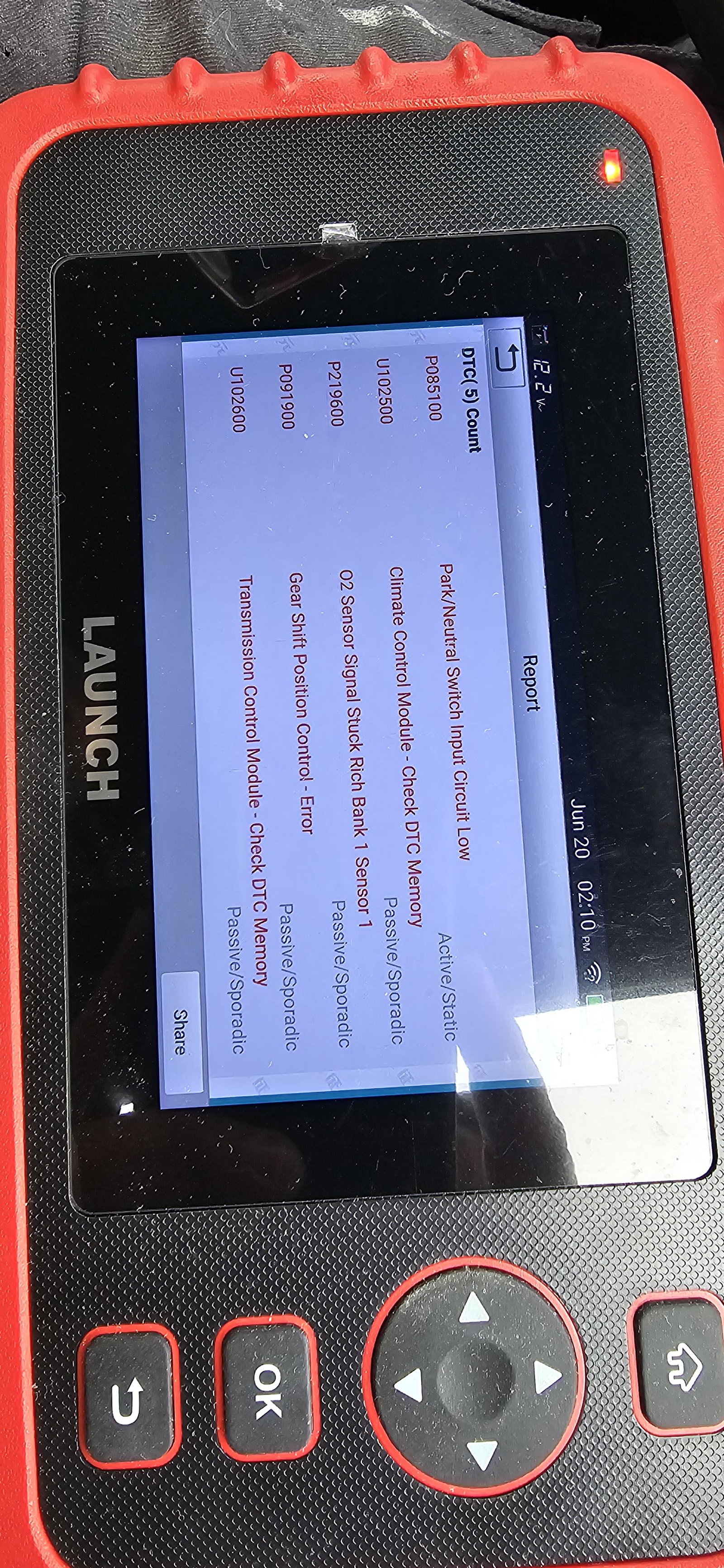

Cdobbie Posted June 21 Share Posted June 21 Hi new member here 馃憢.聽 Yesterday started having issues with my 2010 3.0 Q7. When going to N the dash shows R and the coil light flashes, move it to D and the dash shows S. Mate plugged it in and the following codes appeared. He reset the gearbox and all was good for around 24hrs. Any ideas what this could be?聽 Quote Link to comment Share on other sites More sharing options...
Stevey Y Posted June 22 Share Posted June 22 22 hours ago, Cdobbie said: Hi new member here 馃憢.聽 Yesterday started having issues with my 2010 3.0 Q7. When going to N the dash shows R and the coil light flashes, move it to D and the dash shows S. Mate plugged it in and the following codes appeared. He reset the gearbox and all was good for around 24hrs. Any ideas what this could be?聽 Hi sounds like you need a service on the gearbox or the Mechatronics unit is on itsway out, you also need a new oxygen sensor. Steve. Quote Link to comment Share on other sites More sharing options...
Cdobbie Posted June 22 Author Share Posted June 22 馃槱 Mechatronics unit sounds expensive? 馃槀. When it's going through the gears it's still smooth聽 Quote Link to comment Share on other sites More sharing options...
