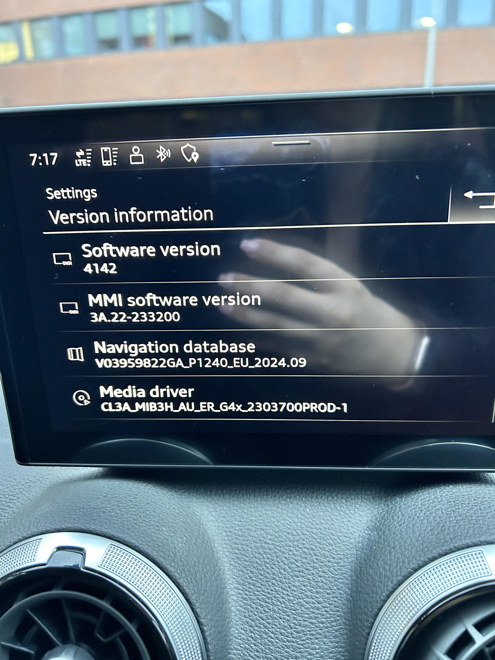

The MMI software version seems to be the same as yours across all models. The overall software version is 4142 on a Q3 and 4143 on an A3, I think. Your media driver seems to be slightly later than mine here:20240923_155252.thumb.jpg.24992565f62d781f447b8ca59af0e0d2.jpg
Thanks Gordon & Mick.  There appears to be no reason it should not work on mine too

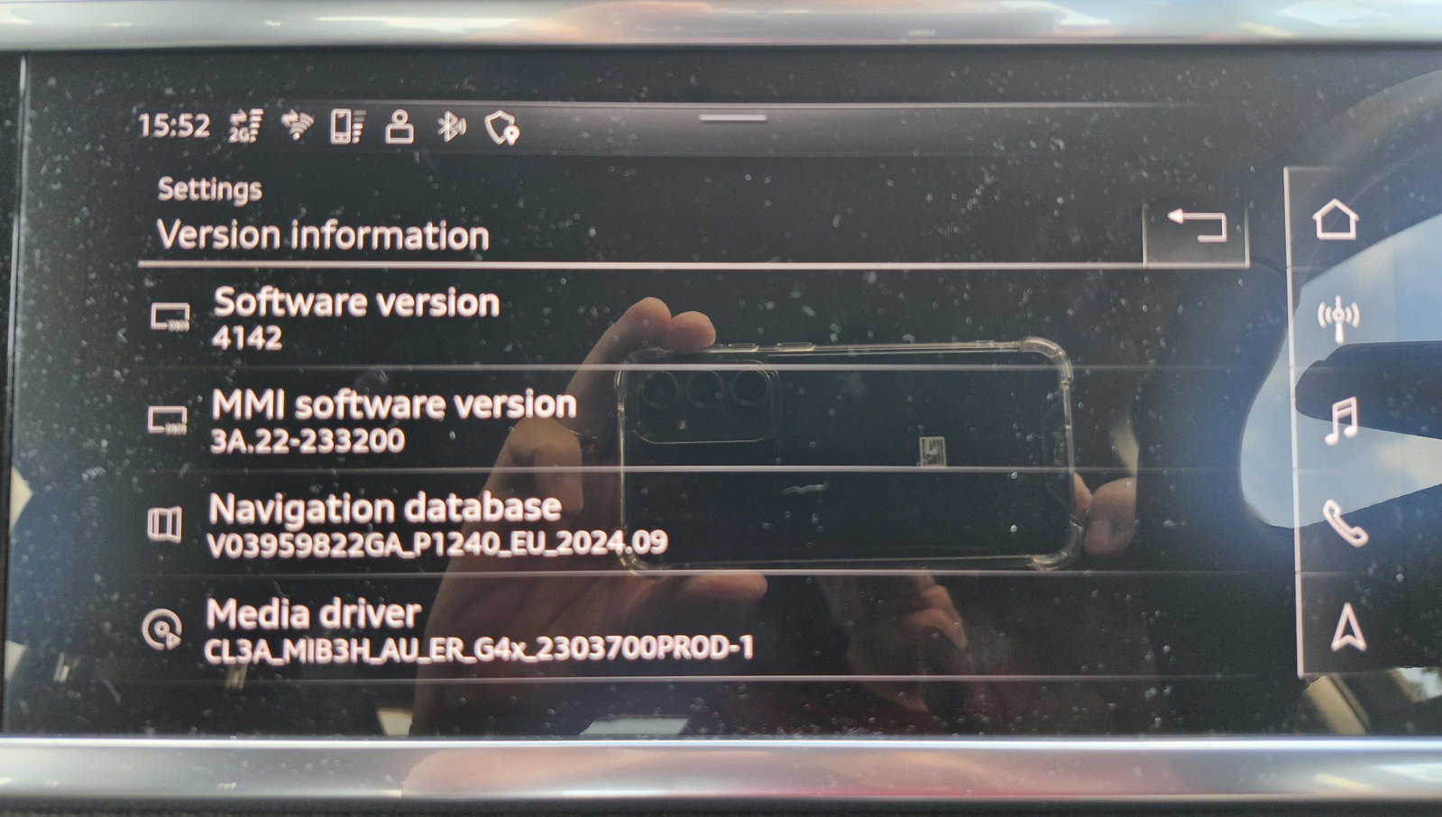

This is my software on my Q2, it’s been two weeks for car and it’s still working great.
