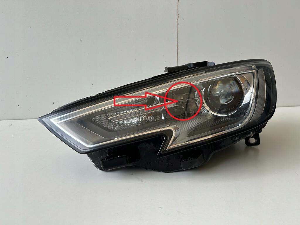

Mr G Posted July 23 Author Share Posted July 23 It's the bulbs in this picture that isn't working (both sides). That is the sidelight bulb, right? Quote Link to comment Share on other sites More sharing options...

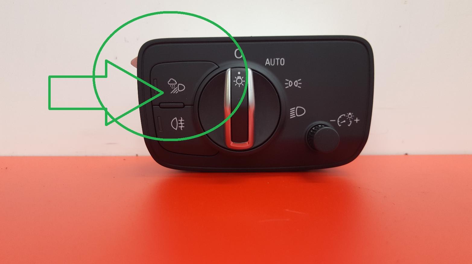

Mr G Posted August 22 Author Share Posted August 22 6 minutes ago, cliffcoggin said: So did you get the sidelights to work? I've never heard of rain lighting. Can you explain further? I am new to A3's, so this is the button I refer to.... . Quote Link to comment Share on other sites More sharing options...
oake Posted August 23 Share Posted August 23 Apparently, the button you've indicated applies only to cars with LED headlights. Quote Link to comment Share on other sites More sharing options...
Mr G Posted August 23 Author Share Posted August 23 Interested, thanks Steve. So do I just put them on during night and rain? Quote Link to comment Share on other sites More sharing options...
oake Posted August 23 Share Posted August 23 57 minutes ago, Mr G said: Interested, thanks Steve. So do I just put them on during night and rain? I don't have LED headlights, and my button therefore doesn't do anything, so I can't really help you. I just quoted the relevant passage from my handbook. If you have LED headlights, I guess you could experiment to see what they do. 1 Quote Link to comment Share on other sites More sharing options...
