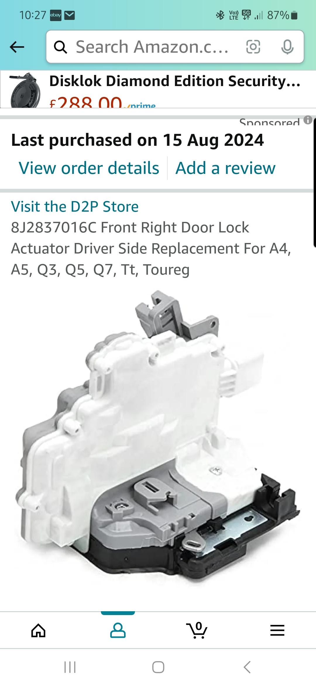

neil993 Posted August 20 Author Share Posted August 20 Thanks for that Gareth, I have changed the drivers lock yesterday thinking that would solve it but it hasn't. I will.get it plugged in and see it that shows anything. Thankyou again 1 Quote Link to comment Share on other sites More sharing options...
cliffcoggin Posted August 20 Share Posted August 20 56 minutes ago, neil993 said: I have changed the drivers lock yesterday thinking that would solve it but it hasn't. Did the new lock have an integral switch, or did you attach the old switch. The other thing to look at is the wiring between door and pillar. The wires had a habit of breaking in the older A3s. 2 Quote Link to comment Share on other sites More sharing options...
neil993 Posted August 22 Author Share Posted August 22 Morning Clifford, I bought a new Actuator and had the mechanics at work fit it for me, sorry i don't know what the integral switch this is what i bought. Thankyou Quote Link to comment Share on other sites More sharing options...
cliffcoggin Posted August 22 Share Posted August 22 Neil. I imagine that has all the necessary connections. The next step is to inspect and test the wiring harness to the door. Quote Link to comment Share on other sites More sharing options...
neil993 Posted August 22 Author Share Posted August 22 Hi Cliff, I will have a look at that this weekend and see if anything stands out to me. Thankyou for you help. Quote Link to comment Share on other sites More sharing options...
