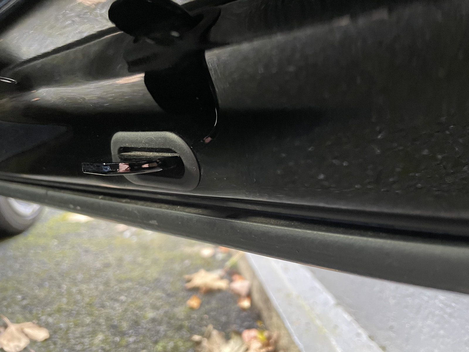

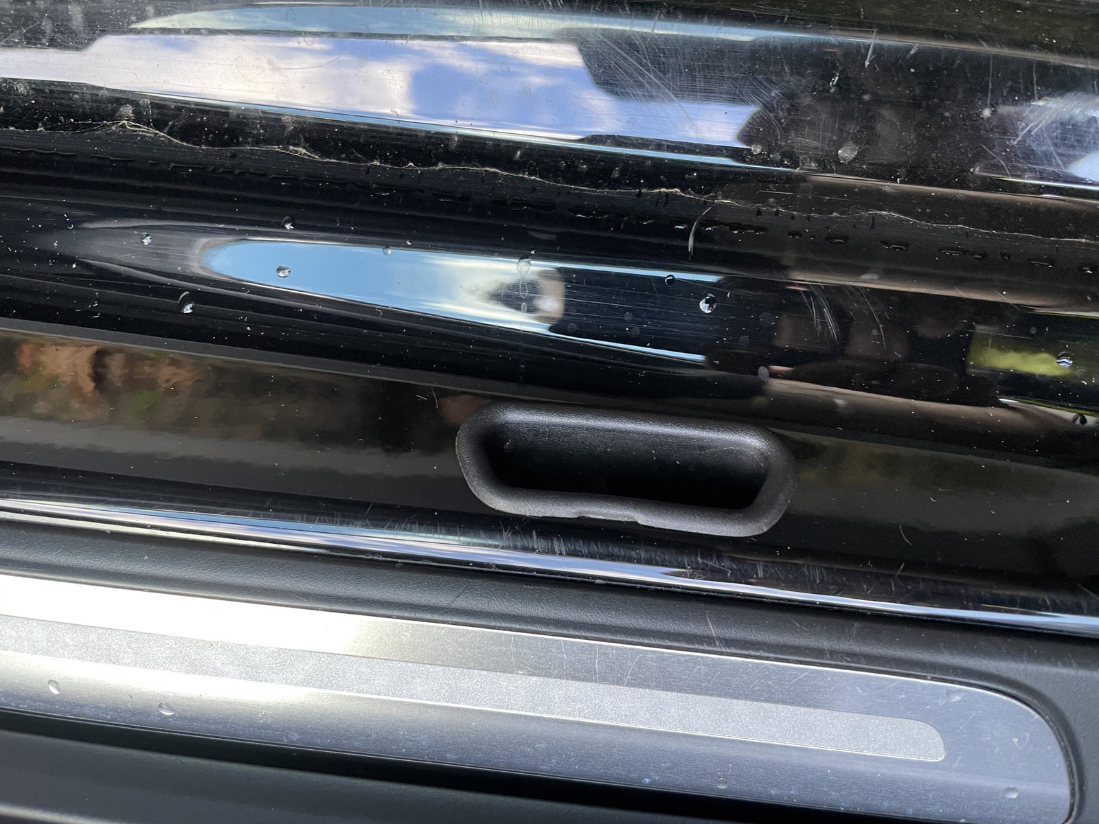

enc Posted October 17, 2024 Posted October 17, 2024 (edited) in previous cars, I’ve had hard to trace rattles and clunks, it’s a million mile long shot but worth checking anyway on drive take up, I’ve had issues with noise from door hinges and check straps where they mount to the A pillar, also movement where the door latch engages at the B pillar. it’s always handy to apply a little lube at these points. On the A3, on the underside of the front doors, thwre is a bar which inserts to the sill, maybe worth applying a little lube/light grease here also. As said, a long shot but can’t do any harm Edited October 17, 2024 by enc
Mr G Posted October 17, 2024 Author Posted October 17, 2024 1 hour ago, enc said: in previous cars, I’ve had hard to trace rattles and clunks, it’s a million mile long shot but worth checking anyway on drive take up, I’ve had issues with noise from door hinges and check straps where they mount to the A pillar, also movement where the door latch engages at the B pillar. it’s always handy to apply a little lube at these points. On the A3, on the underside of the front doors, thwre is a bar which inserts to the sill, maybe worth applying a little lube/light grease here also. As said, a long shot but can’t do any harm Hi, the hinges and check straps I have lubed already. Which is this bar you mention to the sill? I have not seen this, do you have any images please?
enc Posted October 17, 2024 Posted October 17, 2024 16 minutes ago, Mr G said: Which is this bar you mention to the sill? I have not seen this, do you have any images please? Open the door look along the flat of the bottom edge. you’ll see a metal bar protruding. It slots into the upper sill. There’s a plastic grommet where they contact. It’s part of the crash protection system.
Mr G Posted October 17, 2024 Author Posted October 17, 2024 5 minutes ago, enc said: Open the door look along the flat of the bottom edge. you’ll see a metal bar protruding. It slots into the upper sill. There’s a plastic grommet where they contact. It’s part of the crash protection system. Interesting, I will go have a look shortly.
Mr G Posted October 17, 2024 Author Posted October 17, 2024 32 minutes ago, enc said: Open the door look along the flat of the bottom edge. you’ll see a metal bar protruding. It slots into the upper sill. There’s a plastic grommet where they contact. It’s part of the crash protection system. Cannot see anything.... Or am I looking in the wrong place?
enc Posted October 17, 2024 Posted October 17, 2024 That is the correct location. mine is a 3 door hatch. Possibly a 3 door hatch thing !?
Mr G Posted October 17, 2024 Author Posted October 17, 2024 Strange, would've thought it would be the same concept. Back the the drawing board.......😩
Mr G Posted October 18, 2024 Author Posted October 18, 2024 Never seen that before, got to be a 3-door thing then.
