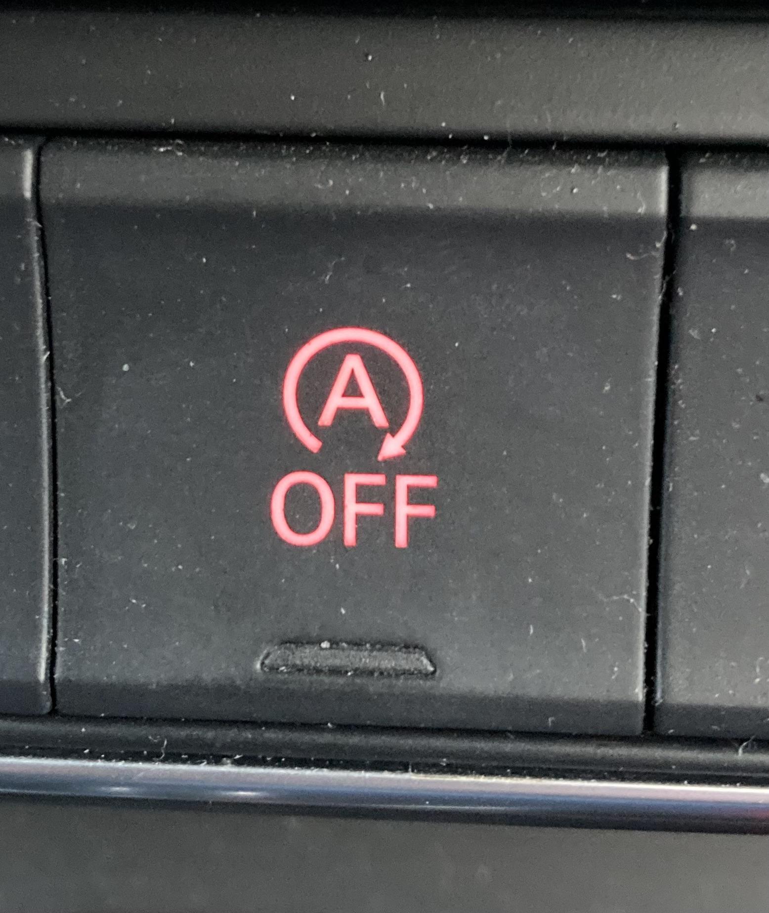

Toby56 Posted January 27 Posted January 27 Does your car have one of these buttons? It is used to activate or deactivate the stop start.
Magnet Posted January 27 Posted January 27 Thanks Graham, but I don’t think it’s an activator. Believed to be a de-activator, which is used to deactivate an active Stop/start , every time the car is reused.
