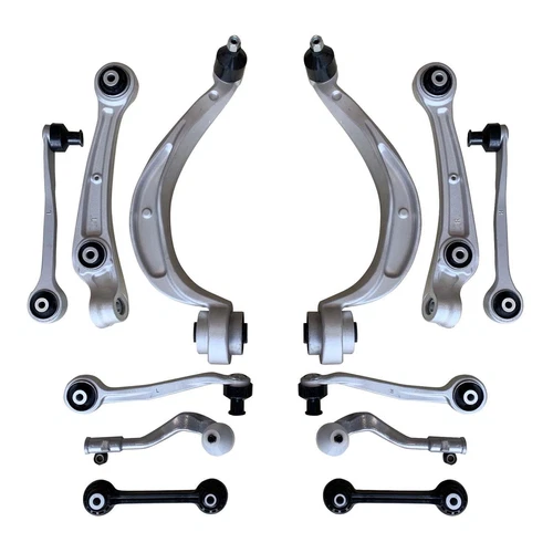

mobotho Posted August 30, 2024 Posted August 30, 2024 @Dvy I agree with Magnet. I would definitely seek a second opinion and a another quote, I find it highly unlikely a) all of the arms need changing and b) all will be changed. Personally I would double check exactly which parts they are changing and then I'd ask for all the old ones back. FYI below is the kit if all arms were changed both sides. (It also includes tie rod ends and anti roll bar links). Good luck with it and I hope your other half enjoys the car! 1
