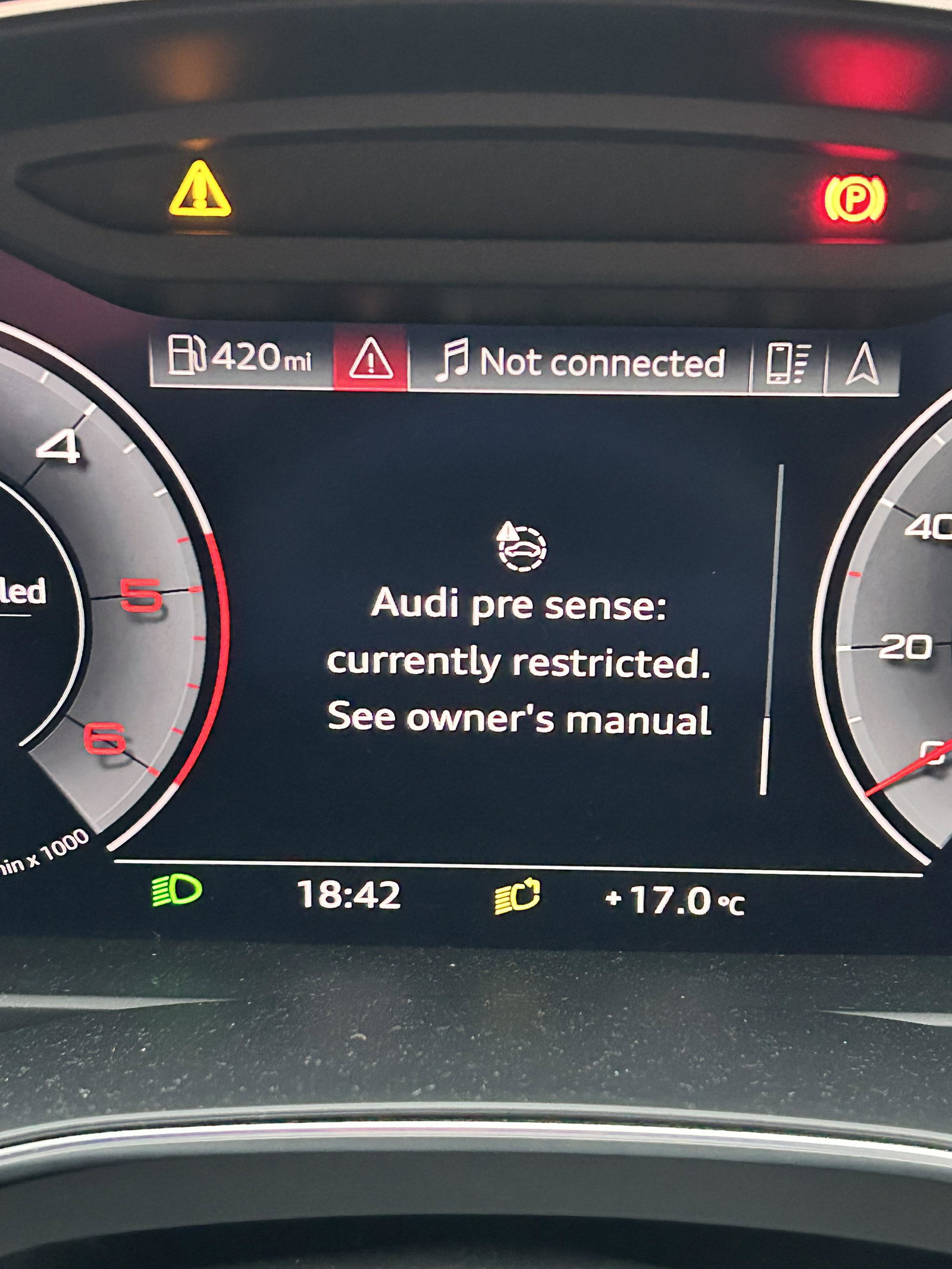

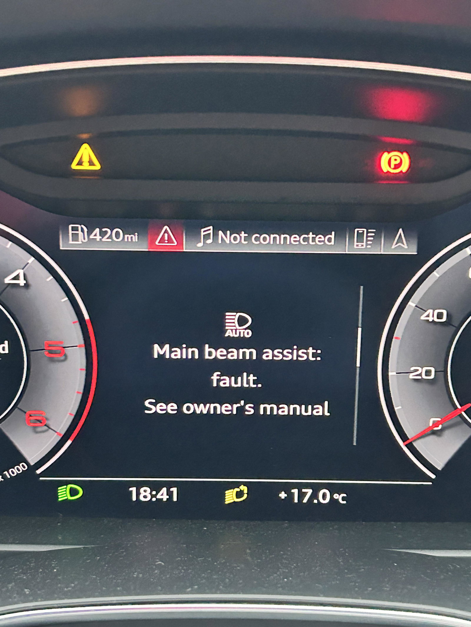

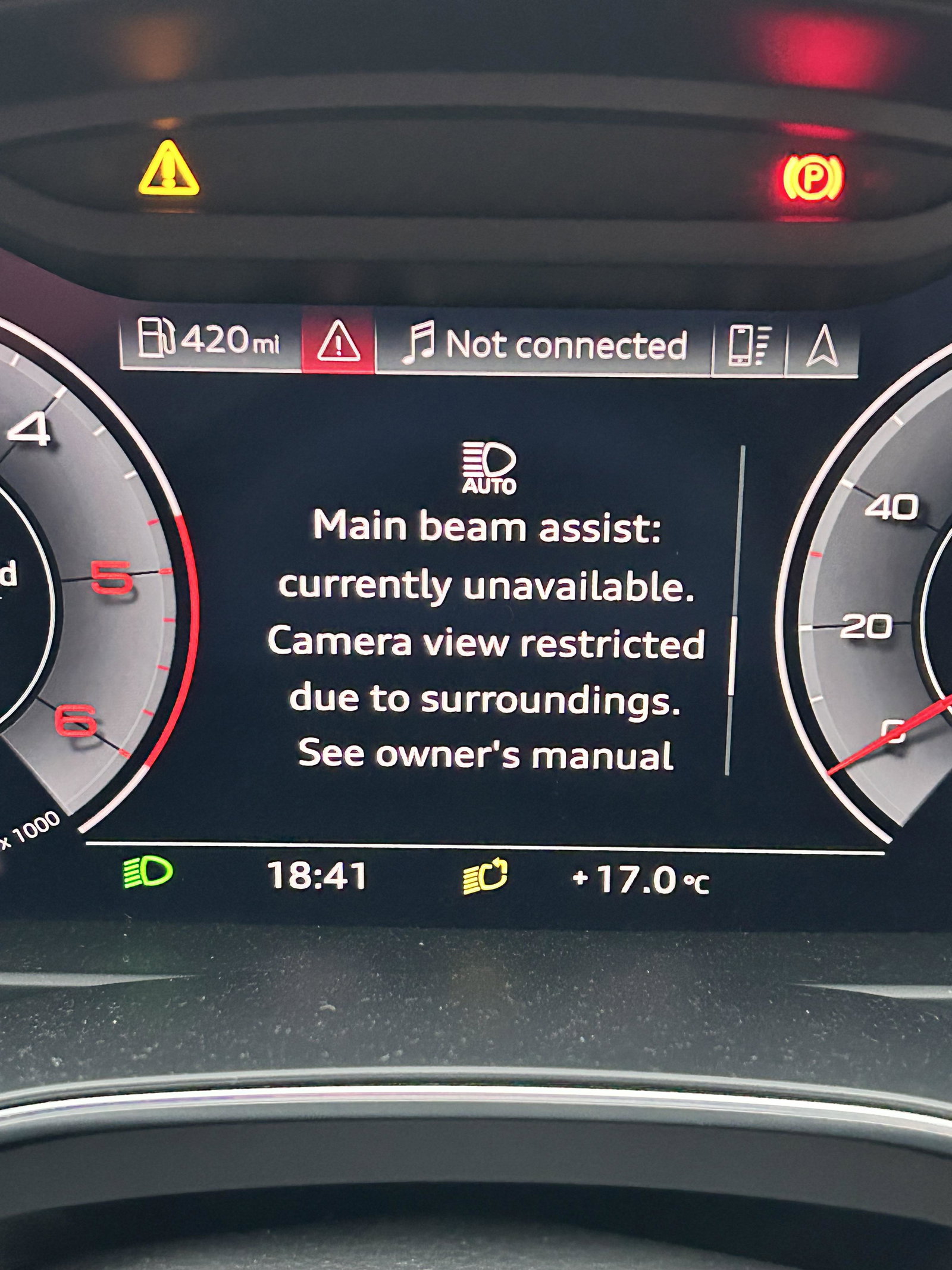

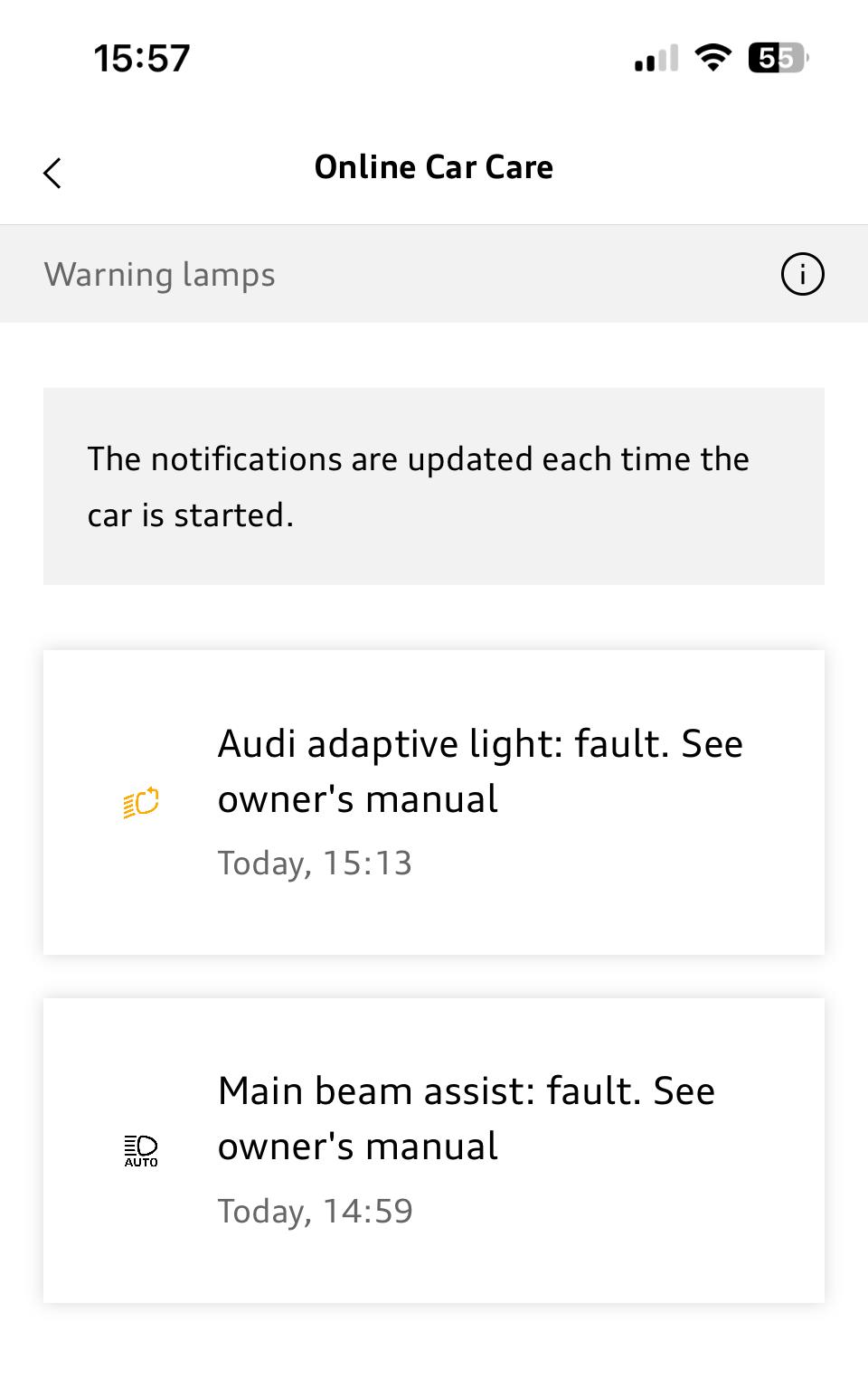

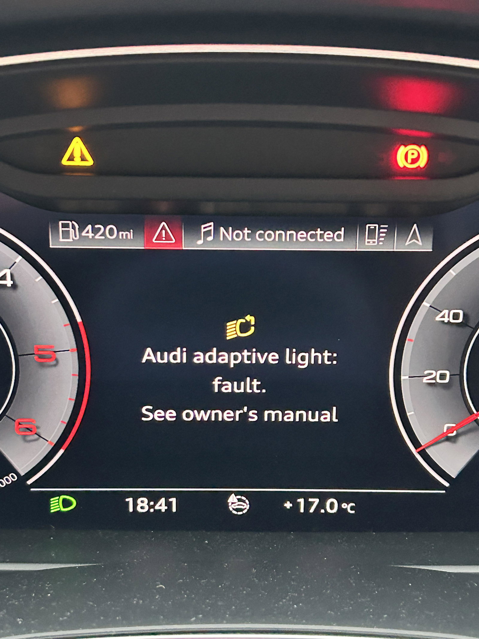

Keith f Posted September 5 Share Posted September 5 Hi I have had my Audi a6 (2019) for a year and a half now. Iv just had up 4 warning messages up on the dash and I'm just looking forward abit more info because the hand book isn't the best. Just says take it to a local dealer. Any help would be appreciated Quote Link to comment Share on other sites More sharing options...
