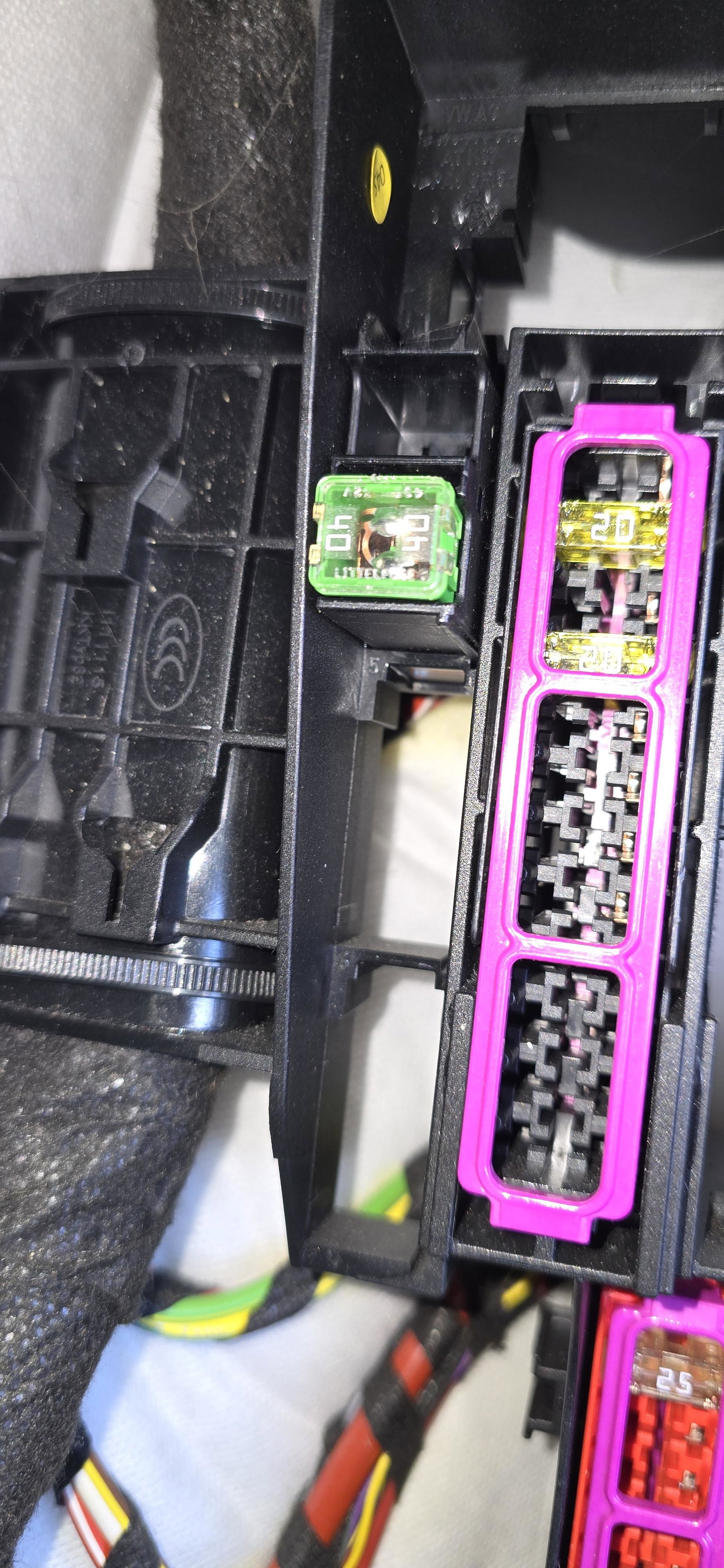

Corbo36 Posted September 10 Author Share Posted September 10 Sorry fellas, just home from work. Had a look in passenger footwell fusebox as well, couple of 30amp and 40amp fuses in there but look to be ok. Dont have a fuse puller so dont want to use pliers to pull out the fuse. Have attached photo to show 40amp fuse in boot Quote Link to comment Share on other sites More sharing options...
Corbo36 Posted September 10 Author Share Posted September 10 Just had someone check all fuses with a meter and all seem ok. Also checked the connections at the window on each side but nothing when heater was turned on. Also didnt hear any click from the relay in the boot when heater was turned on Quote Link to comment Share on other sites More sharing options...
cliffcoggin Posted September 10 Share Posted September 10 While you still have the meter there are two further tests worth doing: /1 Measure the continuity through the element at its terminals with electrical power turned off. No continuity means the element is broken. 2/ Measure the voltage at the element terminals when it is switched on. No voltage confirms no supply. That means you need to work back to the relay, the fuse, and the switch. 1 Quote Link to comment Share on other sites More sharing options...
