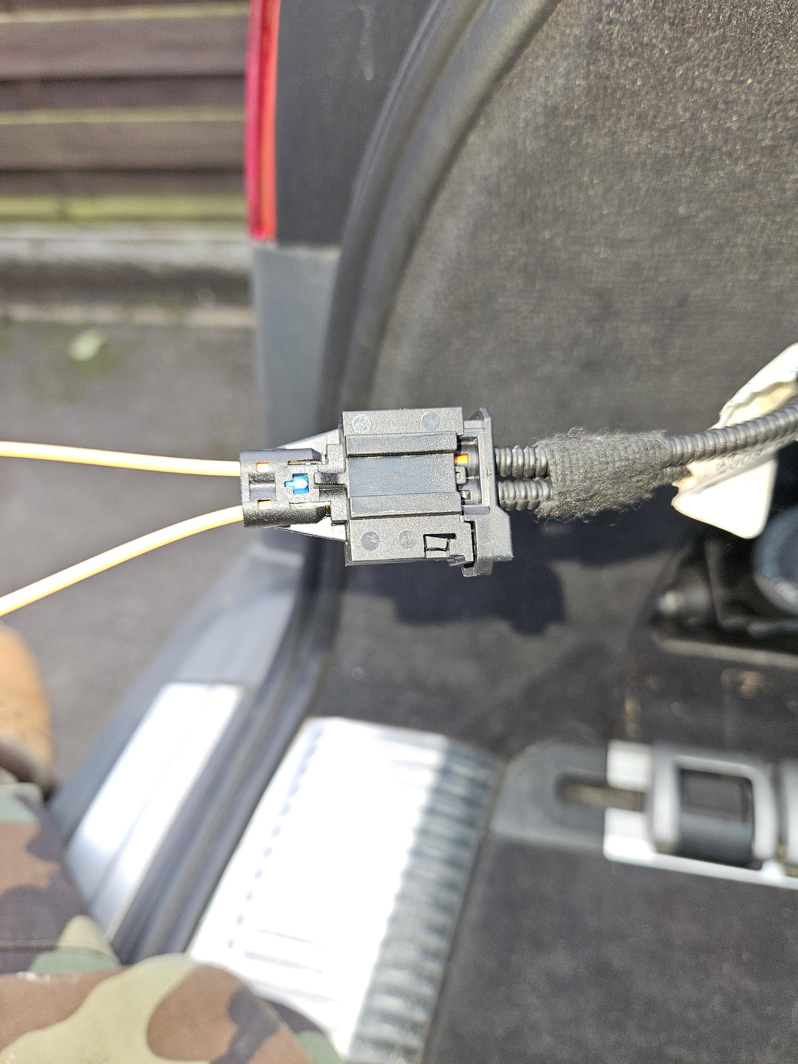

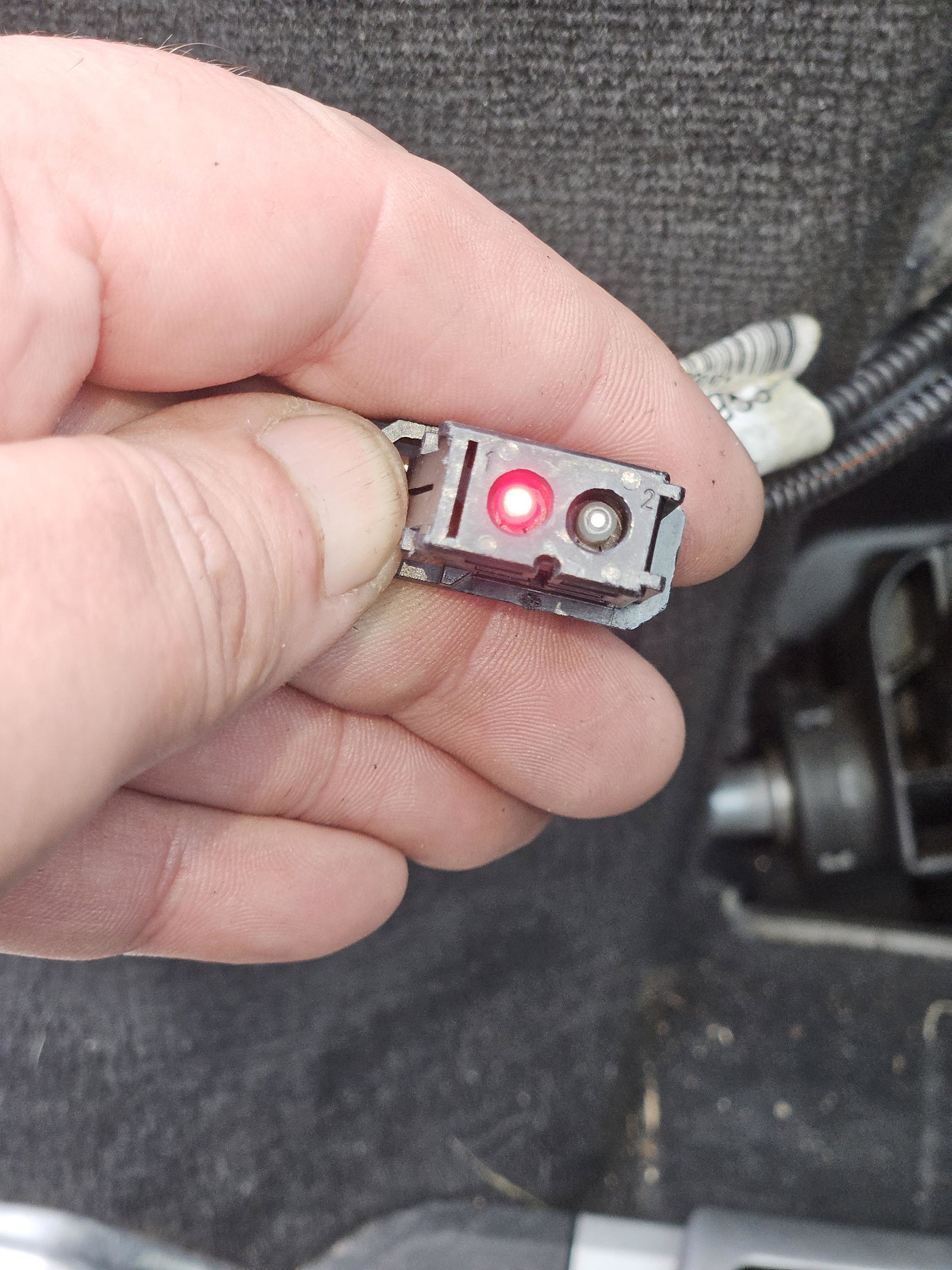

Richard1967 Posted October 21, 2024 Author Posted October 21, 2024 I had a look in the rear panel and yes, there is the amplifier. There is one large connector, held in place with the clip and......... There is a socket on the Amp for a connector, but no connector visible. I have found two brown wires, with a connector which could fit the amp, but, they are currently connected together with what looks a professional loop loom. When I disconnected this, one of the pins started flashing red at me. I decided that the car is haunted and put the connector back in lol. I'm going to have a better look, as there are a few bolts missing - as if the whole rack has been removed and there is a connector hooked down the back of everything. I have an Amp arriving on Wednesday.....

Richard1967 Posted October 21, 2024 Author Posted October 21, 2024 One picture (162932) showing the connector which could fit in the amplifier, with the loop fitted and the other picture (162951) shows the pin flashing red. I got brave and plugged it in to the Amp and absolutely nothing happened - blank screen! I will watch the video you have kindly sent later. I do have an issue with water - the rear window seal above the quarter panel is damaged and the sound proofing in the well of where all of these gizmos live is damp. Lol - the washer bottle does empty itself, but I have no smell of washer fluid in that area.
