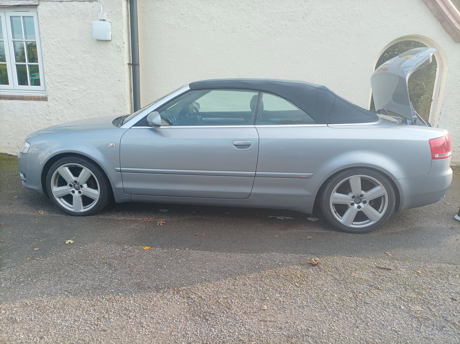

I suspect this is a simple answer but wondered has anybody else changed the rear springs on their convertible? I ask as I notice that mine sits lower at the rear albeit level. Now I appreciate it has all the weight of the mechanism for the roof in the rear. Is this just a case of the springs being old.? They aren't fractured as I've checked.
Any help/experience would be appreciated

Ah right 2 years + pretty much always been like it although it does seem to feel a bit worse IMO
I can send a photo. I've seen a few like it on my travels. I just wondered if I got the springs replaced if it would add a bit of height.
Rear both sides 645mm
Os front 660mm
Ns front 655mm

Thanks Magnet, I genuinely felt the photo explained my point. I also didn't have a tape at that point so wanted to give context to my question.
