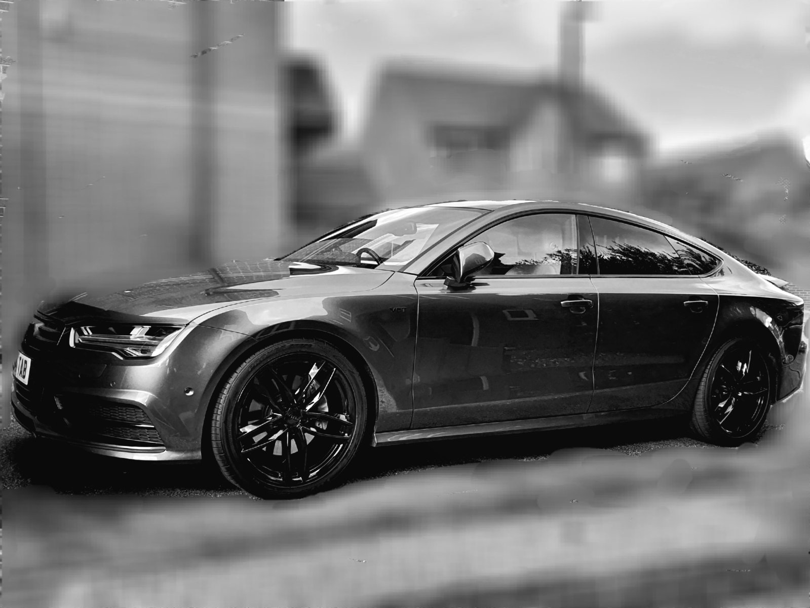

SETAB Posted Thursday at 04:52 PM Share Posted Thursday at 04:52 PM (edited) Hi, just joined being an Audi fan and hoping for feedback. My stunning A7 has developed an intermittent rough idle which settles once driven. No lights on, diagnosed with no finding. OmG what's wrong with it. Edited Thursday at 04:57 PM by SETAB Added pic Quote Link to comment Share on other sites More sharing options...
