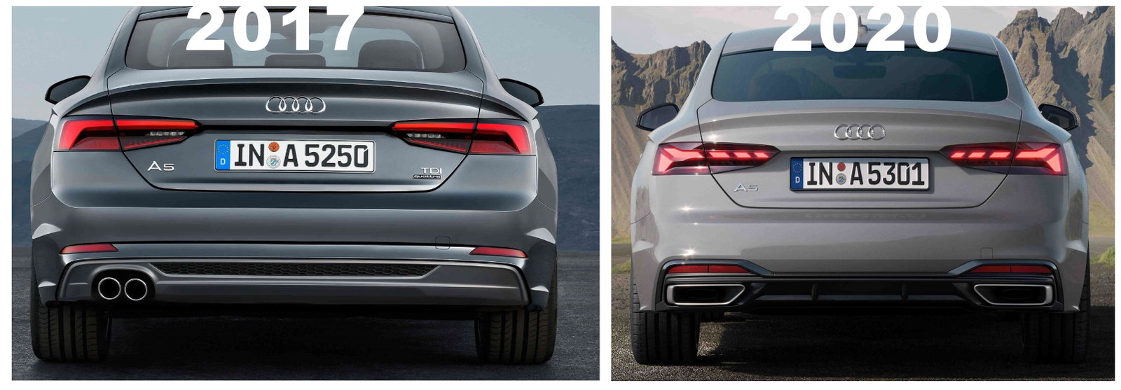

sashabcro Posted October 31, 2024 Posted October 31, 2024 Hopefully I can get some answers here so I finally own A5 2017 Sportback and I really love my car but if I miss one thing it's the rear bumper, I have a little bit of OCD and new one is perfect for that below is mine and new one, my question is am I able to do this upgrade on mine? And if yes, can someone point me in right directions where to start? I'm from Europe, Ireland. Thank you.
Stevey Y Posted October 31, 2024 Posted October 31, 2024 1 hour ago, sashabcro said: Hopefully I can get some answers here so I finally own A5 2017 Sportback and I really love my car but if I miss one thing it's the rear bumper, I have a little bit of OCD and new one is perfect for that below is mine and new one, my question is am I able to do this upgrade on mine? And if yes, can someone point me in right directions where to start? I'm from Europe, Ireland. Thank you. Hi its doable but you will have to buy a new rear bumper, lower bumper trim and lose the existing rear box for the exhaust, all big money items the bumper skin itself is over £500 without the lower trim and new fixing brackets, can't see why you want to change it when you can't see it while you are driving and I am sure the driver of the car behind wont care either. Steve. 1
