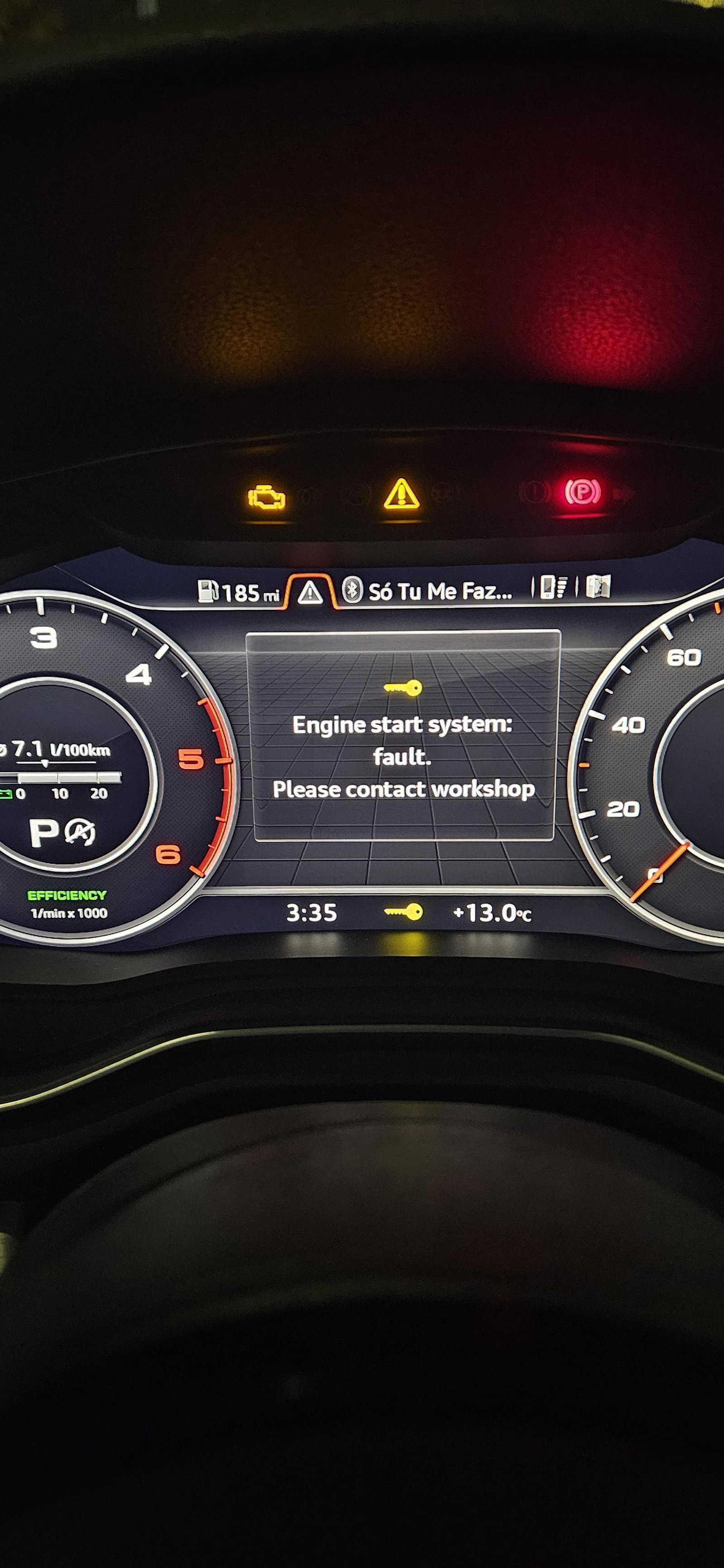

Jose R Posted November 2, 2024 Posted November 2, 2024 Hi,I'm new here in this forum as I just bought a Audi A4 2016 2.0 TDI QUATTRO and this warning appeared on the screen. I took it to mechanic and no errors appear in the diagnostic software machine but when he press reset errors the light disappeared for a few days but come back again. Anyone know what can be the problem? The car starts and drives fine without any noises. Thanks
cliffcoggin Posted November 2, 2024 Posted November 2, 2024 It is possibly the battery starting to fail. Get the battery professionally tested; do not rely on a voltage reading to tell you anything useful.

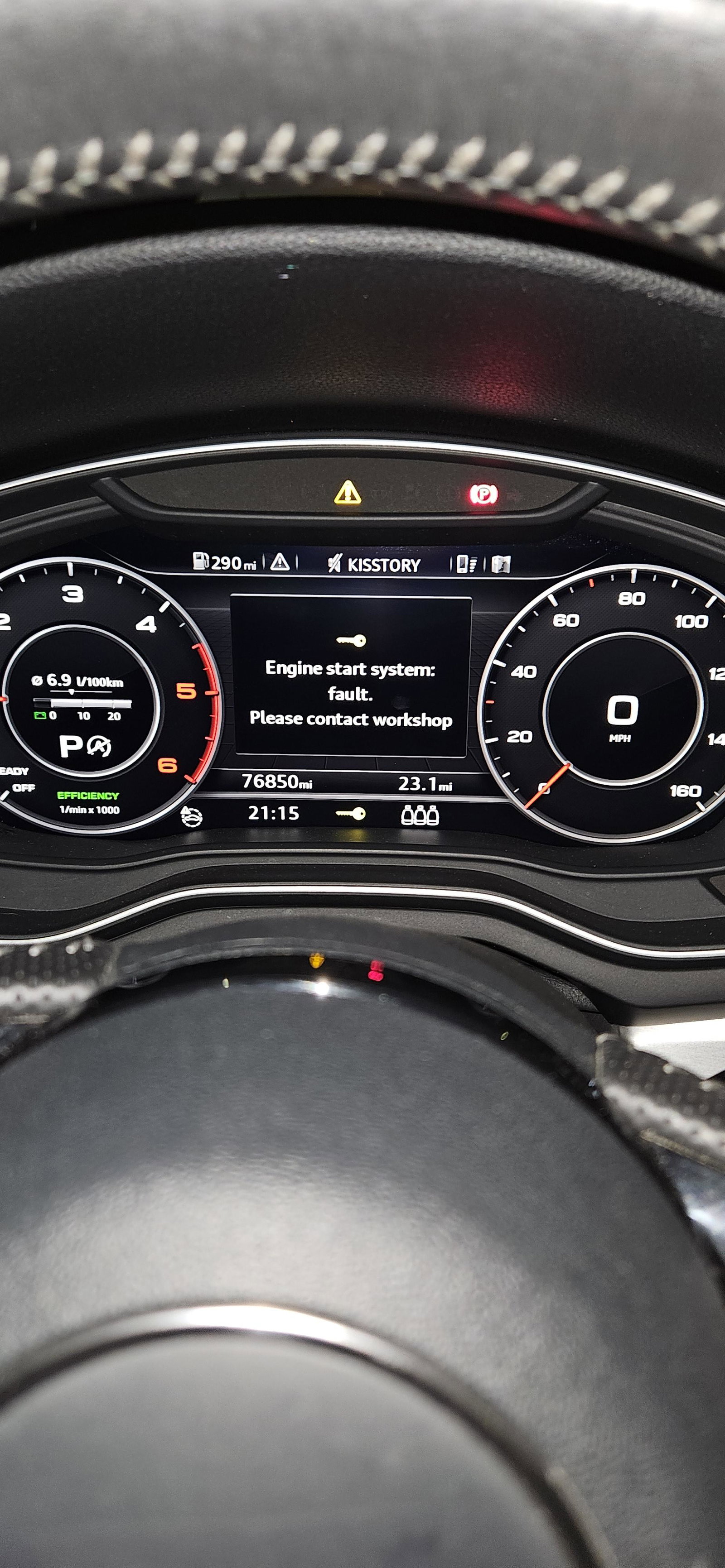

Jose R Posted November 3, 2024 Author Posted November 3, 2024 Hi, thanks for your awnser on this now just appear another light but no advise on the screen only the engine start system fault. Do you think is about the same as no other advice appear?
cliffcoggin Posted November 3, 2024 Posted November 3, 2024 I repeat: get the battery professionally tested.
