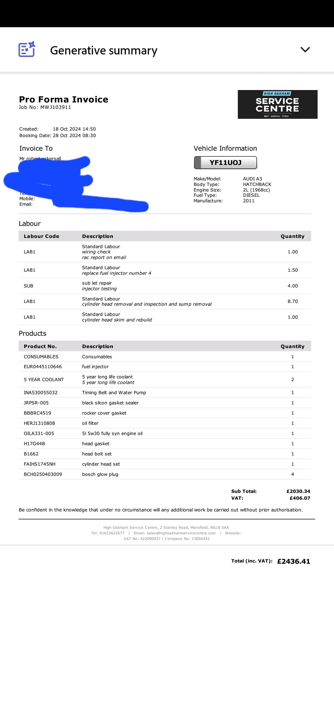

Elvis08 Posted December 18, 2024 Posted December 18, 2024 (edited) Hello. Well after 8 weeks in the garage. My car is finally gonna be ready today. Apparently a bolt head or nut found its way into the engine and went through a vale stem housing and made the valve not open and close properly. And as a result of this this is my bill. Am I getting ripped off???? Edited December 18, 2024 by Elvis08
Magnet Posted December 18, 2024 Posted December 18, 2024 Welcome Robert and thanks for joining. I’m not sure why you have tagged your post on to the one you have chosen, since there doesn’t seem to be any relevance. Anyway….. I’m sorry to hear of your problem, but before discussing prices, I would be far more interested/ worried about where your bolt head or nut came from, but… To try to answer your question re. price and are you being ripped off with 4x ? , which suggests you think you are. You seem to be paying for around 10 hours labour at £x/hour to start with, and I would have thought that 10 hours could have been more. You have had the cambelt renewed together with injectors - I think. Head gasket set , and probably valve/s, head skimmed etc. etc. To me, it’s around expectations, but I could be wrong. It might be worth appreciating Robert that you could be lucky that the garage agreed to undertake the work, rather than write off the engine - as many would. Without further knowledge, I would be interested in your views which lead you to question why you question if you may have been ripped off - as you say. Kind regards, Gareth.
cliffcoggin Posted December 18, 2024 Posted December 18, 2024 £2500 for a head overhaul does not sound too bad on the face of it by modern standards, particularly as the timing belt and water pump were included in the job, but there's something incomplete about the explanation. Firstly, where did this errant bolt or nut come from, and how did it enter the engine. Secondly, if a bolt or nut had found its way into the engine and thereby damaged a valve, the repair would have needed at least one new valve yet there is no mention of new valves on the invoice unless that is what is meant by "cylinder head set".

robert eckersall Posted December 19, 2024 Author Posted December 19, 2024 Right first I tried logging in and resetting my password but it sill didn't seem to work. I have done it again and as you can see it worked this time. Right secondly I do not have a clue where the bold head/nutt came from and neither do they. I have only had 1 injector replaced. The nutt didn't damage the injector but just the stem housing so they have replaced all the valve stems but not any of the valves because they was not damaged it was just stopping it from opening and closing properly. I didn't know if I am being ripped off or not that's exactly why I asked the question. It's just seemed a big !Removed! bill that's all. If others think that it is about right for the work that there doing then I'm fine with that. Thanks for the replys
