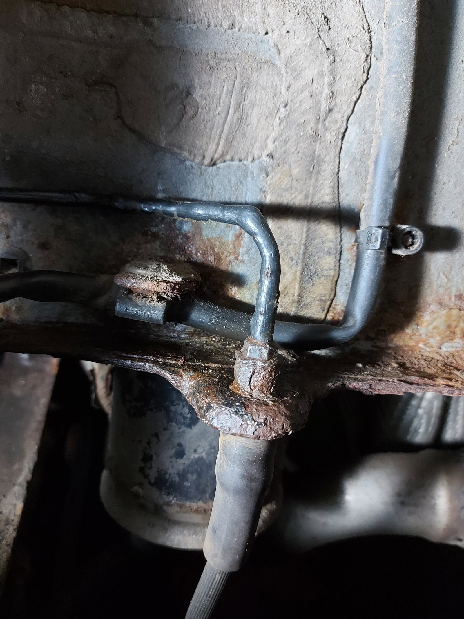

SwaitsySG Posted December 13, 2024 Author Posted December 13, 2024 Well, that's gubbed. Whether it's the cause of the sticky brake or not is still not confirmed. But I'm not going to attempt to loosen it. So the plan now will be to cut that whole end off and replace it with a new piece of pipe.
cliffcoggin Posted December 13, 2024 Posted December 13, 2024 It doesn't look good. Might as well change all four while you are at it.
SwaitsySG Posted December 13, 2024 Author Posted December 13, 2024 Well Cliff, my two mot advisories were for this and the offside rear. So I'll replace the ends on both rear lines. I'm not going to touch the front. Fifteen year old car with 254k miles, I'm not doing any more to it than I need to.
cliffcoggin Posted December 13, 2024 Posted December 13, 2024 Fingers crossed that the rusty brackets don't break off. 1
SwaitsySG Posted December 13, 2024 Author Posted December 13, 2024 I think they'll be ok if I'm honest. They look worse than they are. If I can carefully persuade the flexi hose out, I'll give the lot a good clean and some rust converter. Then get the ol'Dinitrol on it, preserve it for a wee while longer.
Magnet Posted December 13, 2024 Posted December 13, 2024 Hello Chris, By what I can see, the flexible hose end is unserviceable rusty and should be replaced. Others?? Replacing parts of brake lines by piecing in is not a practice I would endorse. I really think this shouldn’t be a case of ‘ not doing any more than I need to…’ , but one where the job is carried out thoroughly, to best ensure your and other road users safety. Kind regards, Gareth.
SwaitsySG Posted December 13, 2024 Author Posted December 13, 2024 Cheers Gareth, appreciate the concern. I have new Brembo hoses there. Beyond that, there needs to be a balance. Replacing the full line (correct me if I'm wrong for thinking the fuel tank needs to come out? I read that on here somewhere) pretty much means the vehicle is probably scrap. Which is a shame as its got plenty miles left in it. I'll give it some thought before making a decision on what to do. I made this very repair to an old Merc once, where I replaced the knackered end of the brake line with a new piece, double flared and joined with a union. It passed its mot without issue and never gave me any bother.
SwaitsySG Posted January 5 Author Posted January 5 Well, first off happy new year to everyone. Hope Christmas was good. For the sake of tidying up this thread with a conclusion, I've since gone ahead with the brake line repair. I cut the steel line just past the corroded end section, chamfered and reamed the end of the line, made it all neat and tidy, threaded on a union nut and flared the line. Corroded section of steel brake line has now been replaced with a new piece of cupronickel line with a flared union to the steel one. To the end of that I've replaced the old flexi hose with a new Brembo one. The bracket itself was solid, it has a quick tidy up but I may return to that and give it some better protection. Brakes re-bled to finish off. So far no leaks at the union, no fluid loss from the reservoir and more importantly no hot wheel or smell of brake pads. It's early days so I won't say problem solved yet. A short motorway run to my nearest services will give me a better idea. But so far, so good. 1
