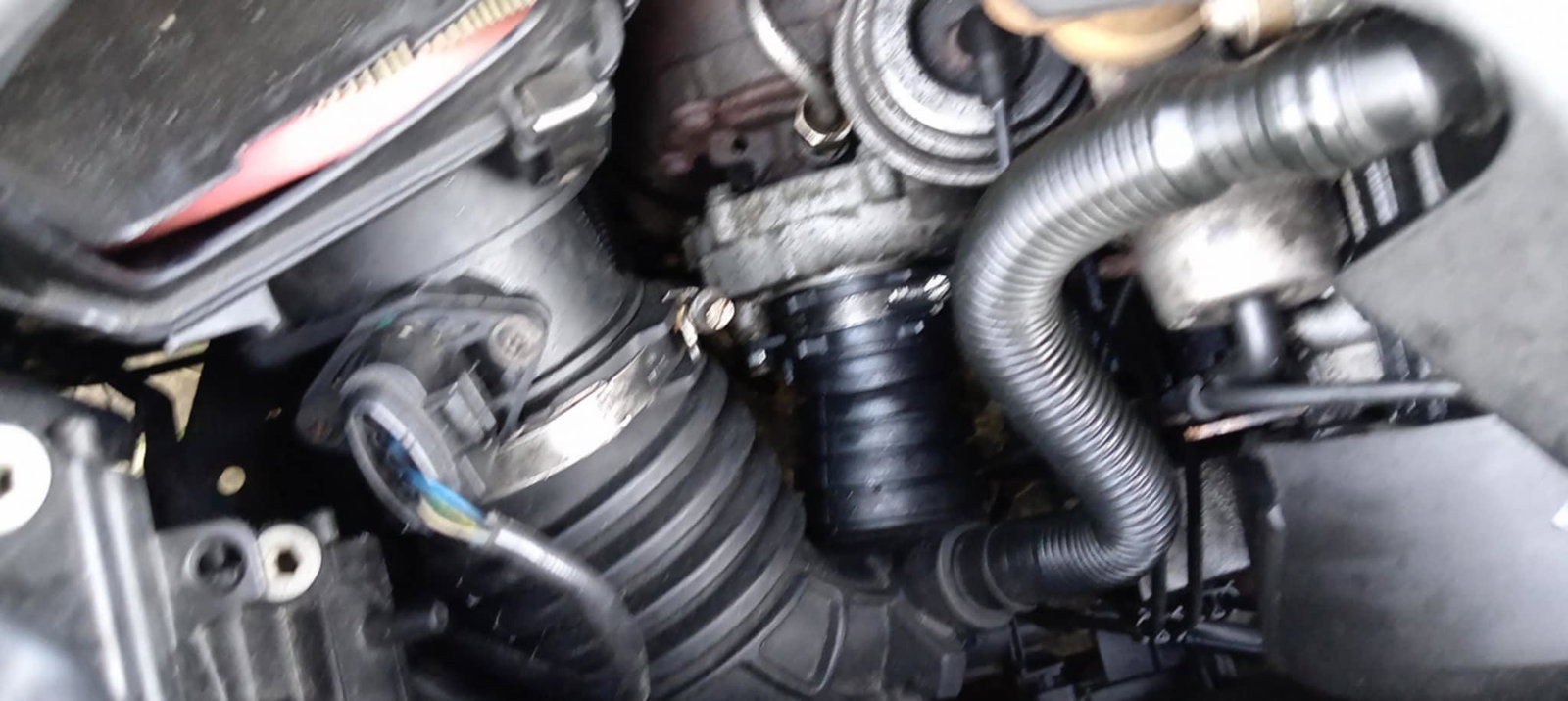

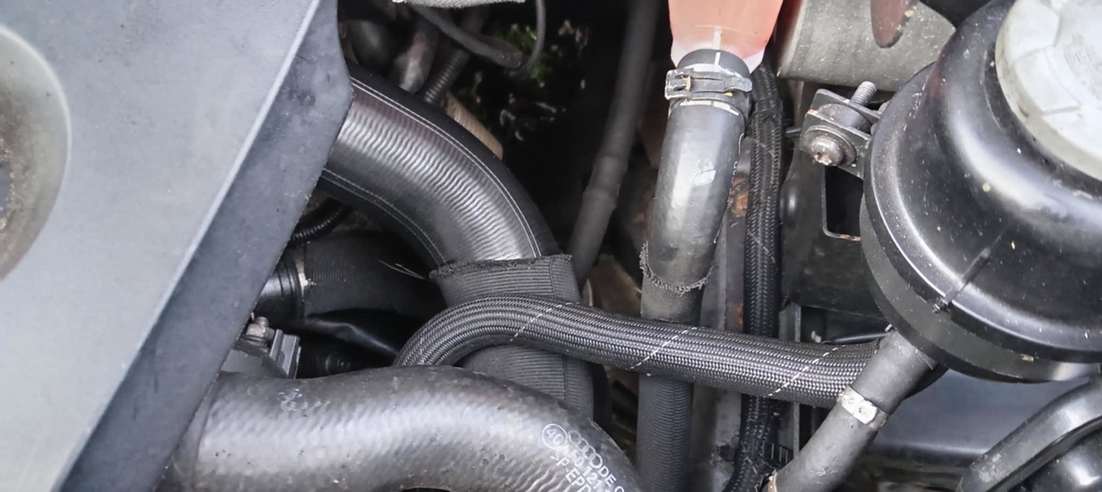

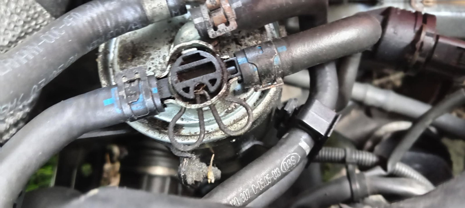

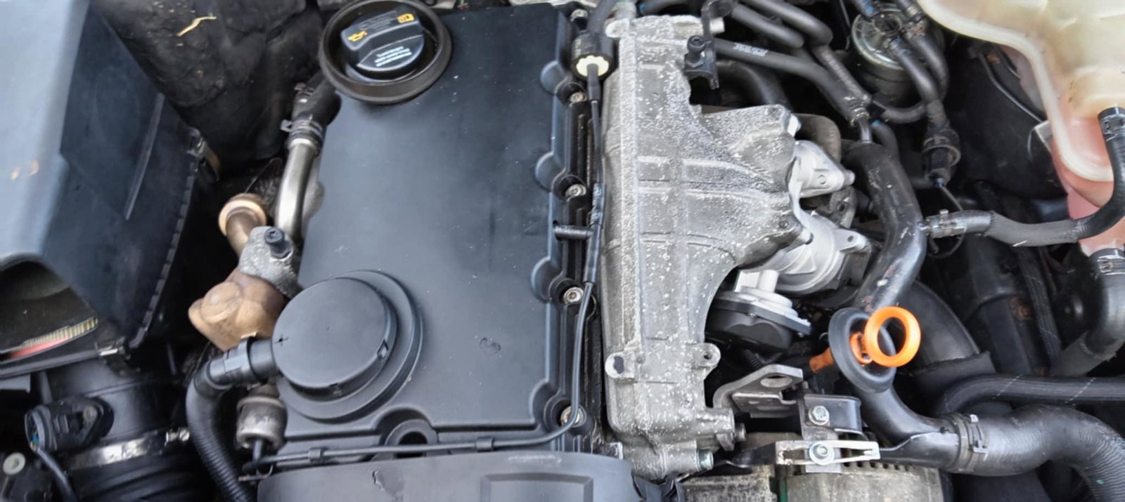

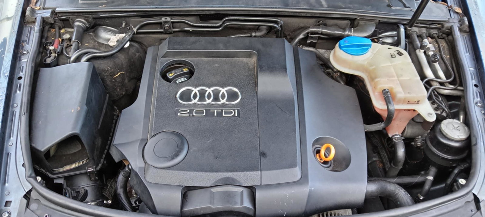

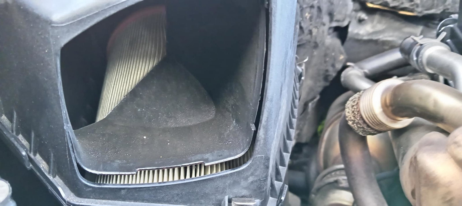

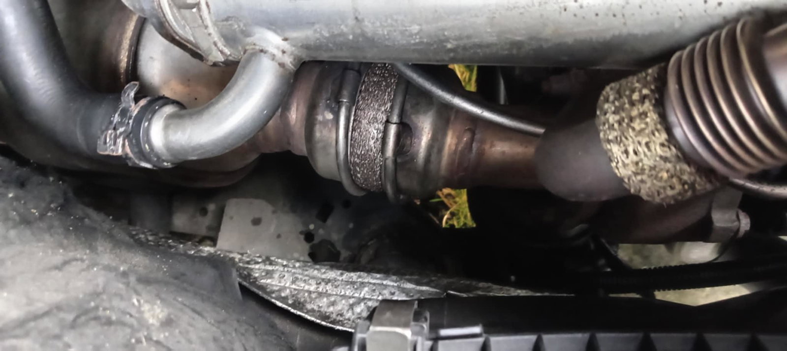

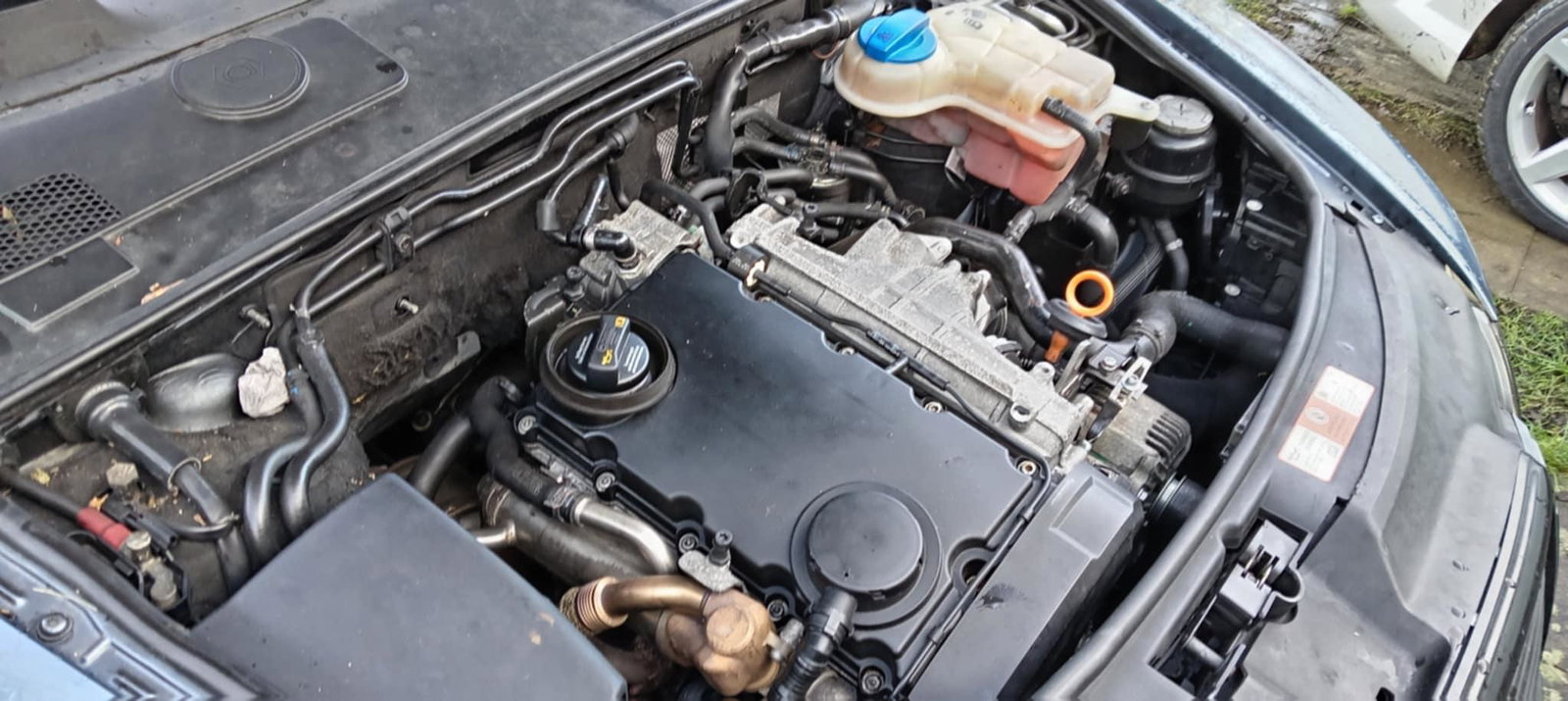

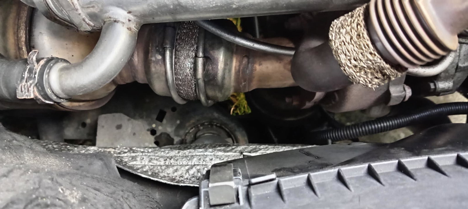

Steve Q Posted November 23, 2024 Posted November 23, 2024 Jay has been messaging me and sent me some further pics of the engine bay. Can anyone determine if and what's missing from this 2.0tdi engine.

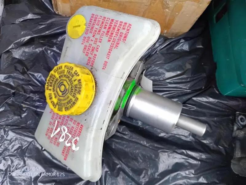

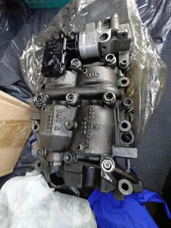

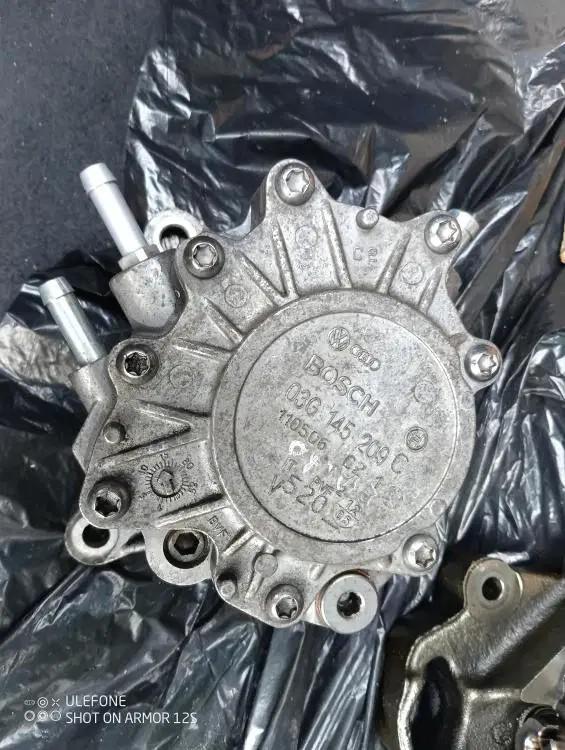

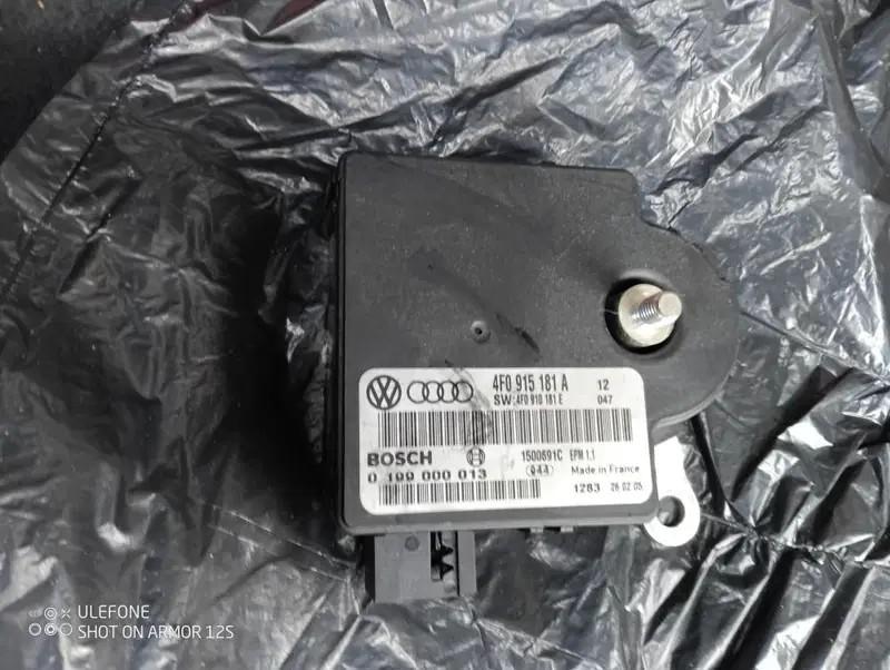

Steve Q Posted November 23, 2024 Posted November 23, 2024 Right I've been researching the parts from the pics. The one below is a brake vacuum pump. Part number 03g145209c. That's probably whats wrong with the brakes. The part below is the balance shaft oil pump with part number 03g103537b. If there's a problem with the oil pump then this could damage the engine if ran. The part below is the brake fluid reservoir and is where you would top up the brake fluid. The part below is the battery control module. Part number 4f0915181a. Theres a fuse that controls the interior lights and rear window heater and this module. So if the interior lights and rear heated window isn't working then it's worth looking at fuses. I'm.nit sure which fuse it is though. This part trickles charges out to all the various components when the car is not running. It's situated in the boot bolted to the "bumper" area. All the images I can't see the part numbers. So if you take pics of the parts showing the numbers then I can help further.

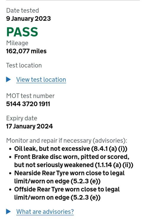

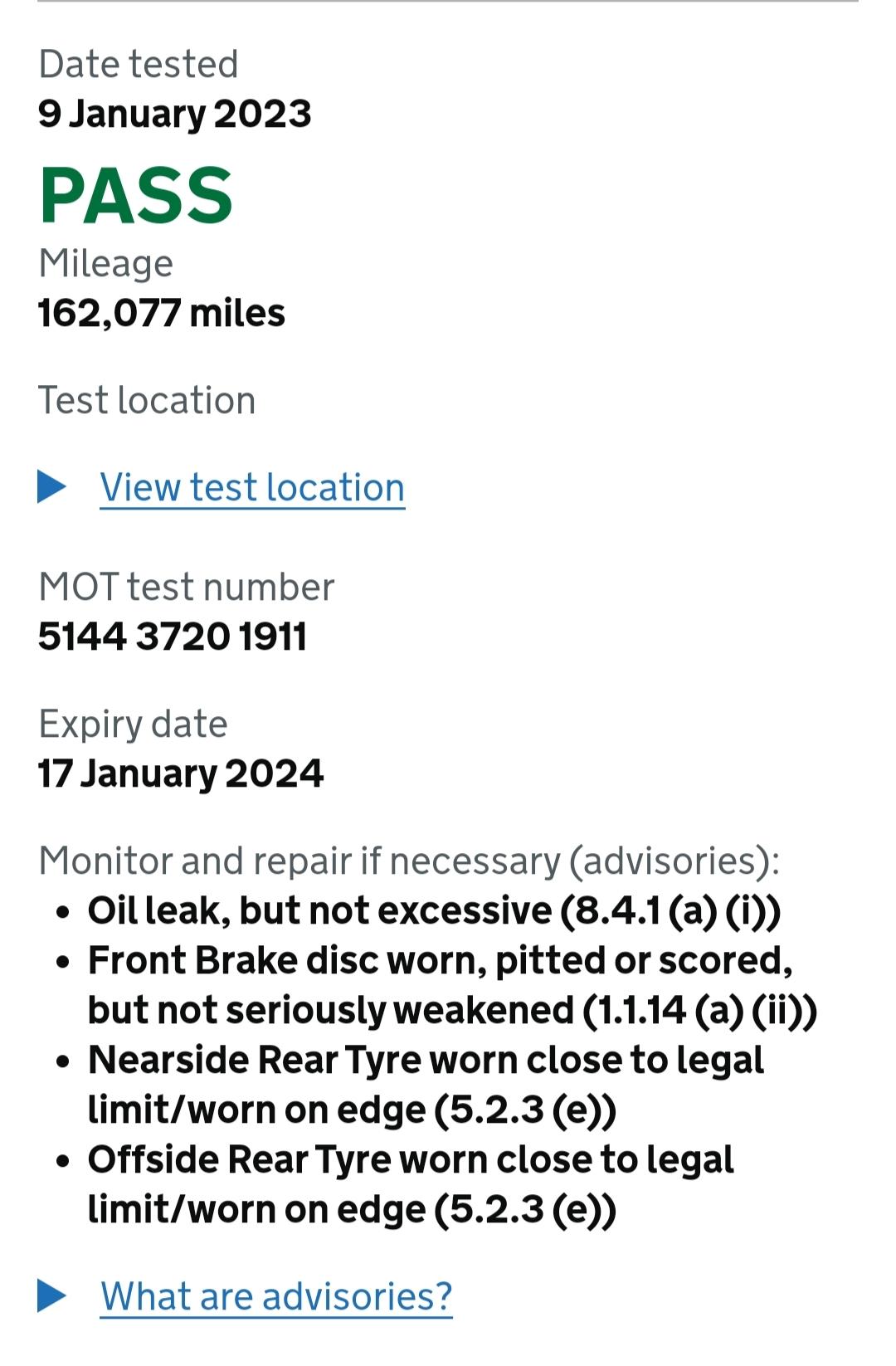

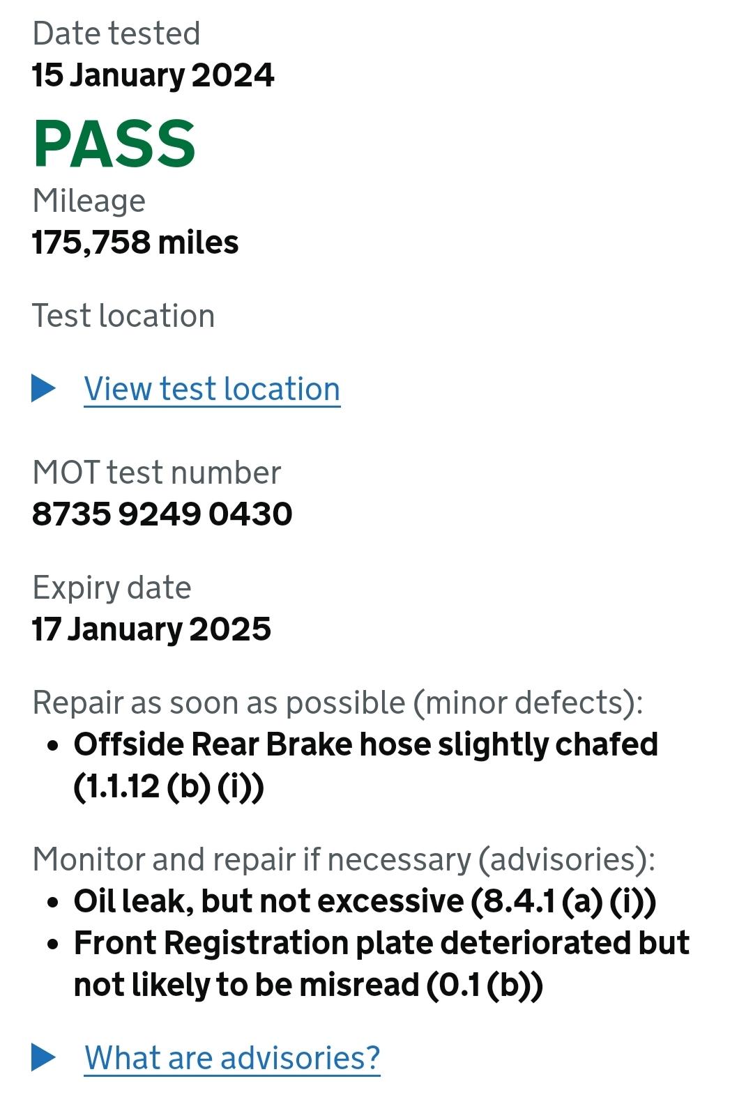

Steve Q Posted November 23, 2024 Posted November 23, 2024 also checking the MOT history tyres were an advisory in 2023 but not 2024 so makes me wonder if they were changed and the ones in the boot are the old ones
audilover81 Posted November 23, 2024 Author Posted November 23, 2024 Hi everybody nobody came with me despite requests that somebody would turn up to help me to get a good understanding of the car there's no history on it he claimed to be Romanian but it seems after talking with other people on here that is clearly not the case I don't know the V5C address matches his address. I've looked online and I can see some service history where the MOT failures have been changed to a pass with some of the advisor is still there the serious ones I think they've been fixed. I didn't know that about the tyres so I didn't know he just said they were new ones they look new but I don't know. It was a private sale from a guy on Facebook I wanted bank transfer so I could trace the money and track it and then it would be evidence like you sent this amount to this person but he insisted it's got to be cash I think he originally wanted about 500 and this he told me is because it was a running car just needed small repairs there was three of them it got a bit intimidating crowding around me telling me this this and this was a bit scary but the other two people went in they were all talk in their own language and that's not me being racist but they were pointing at different things in the car is everything okay he said yes he's just telling me to get my stuff out of the car before it goes on the trailer. I don't know I really wish I'd had a mechanic friend or somebody go with me to try and help me. I appreciate all the comments and guidance it's difficult for me to try and work out what to do with things but with people on here you're all telling me good information so it looks like I've been made an idiot and taking advantage of but it's my own fault because I didn't understand what was going on I tried to video call my friend who advises me on cars before I join the group he said video call me when you get there and then I'll talk you through it and we can have a look over the video call because he's in Wales it doesn't come to Northamptonshire often but he didn't pick up the phone until later that evening he said I'm sorry I was busy so I don't know.
Steve Q Posted November 23, 2024 Posted November 23, 2024 Does sound like you've been caught out by untruthful individuals. In my opinion I think the car needs the brake vacuum pump replaced which is the part that's supplied and id recommend a brake fluid change at the same time. If you scan the obd port with your scanner let us know what fault codes flag up. If one flags up for the battery control module then that will explain why you have one of those as a spare. It's the oil pump that's the most concerning for me, if there's a problem with the current one then it could do damage to the engine.
