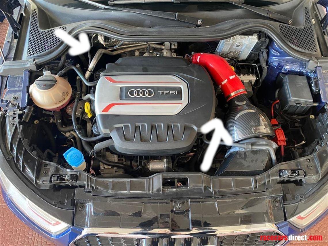

thatukguy_james Posted November 29, 2024 Author Posted November 29, 2024 hi steve, been looking about and i think its right tight on the rear back on the engine under the brake liquid no photos or videos for a a1/s1 , can only see polos and a4 (engine bay not mine )

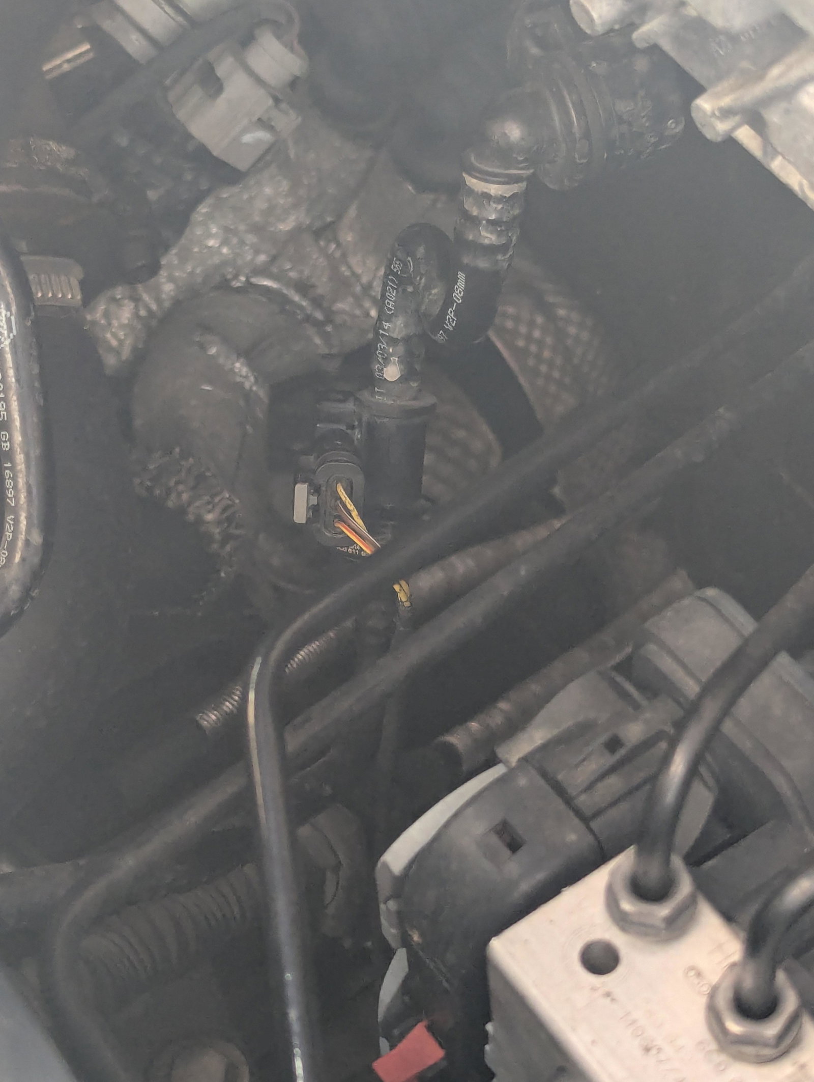

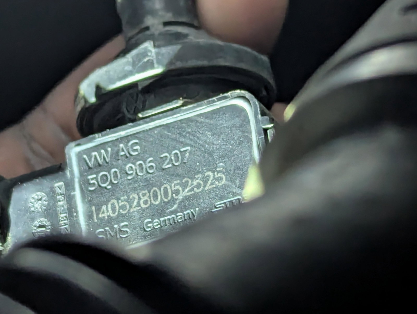

thatukguy_james Posted Saturday at 12:11 PM Author Posted Saturday at 12:11 PM btw all , I found the sensor, behind the air box new one on order 1
Steve Q Posted Saturday at 03:18 PM Posted Saturday at 03:18 PM Glad you've found it 🙂 hopefully that sorts the issue.
