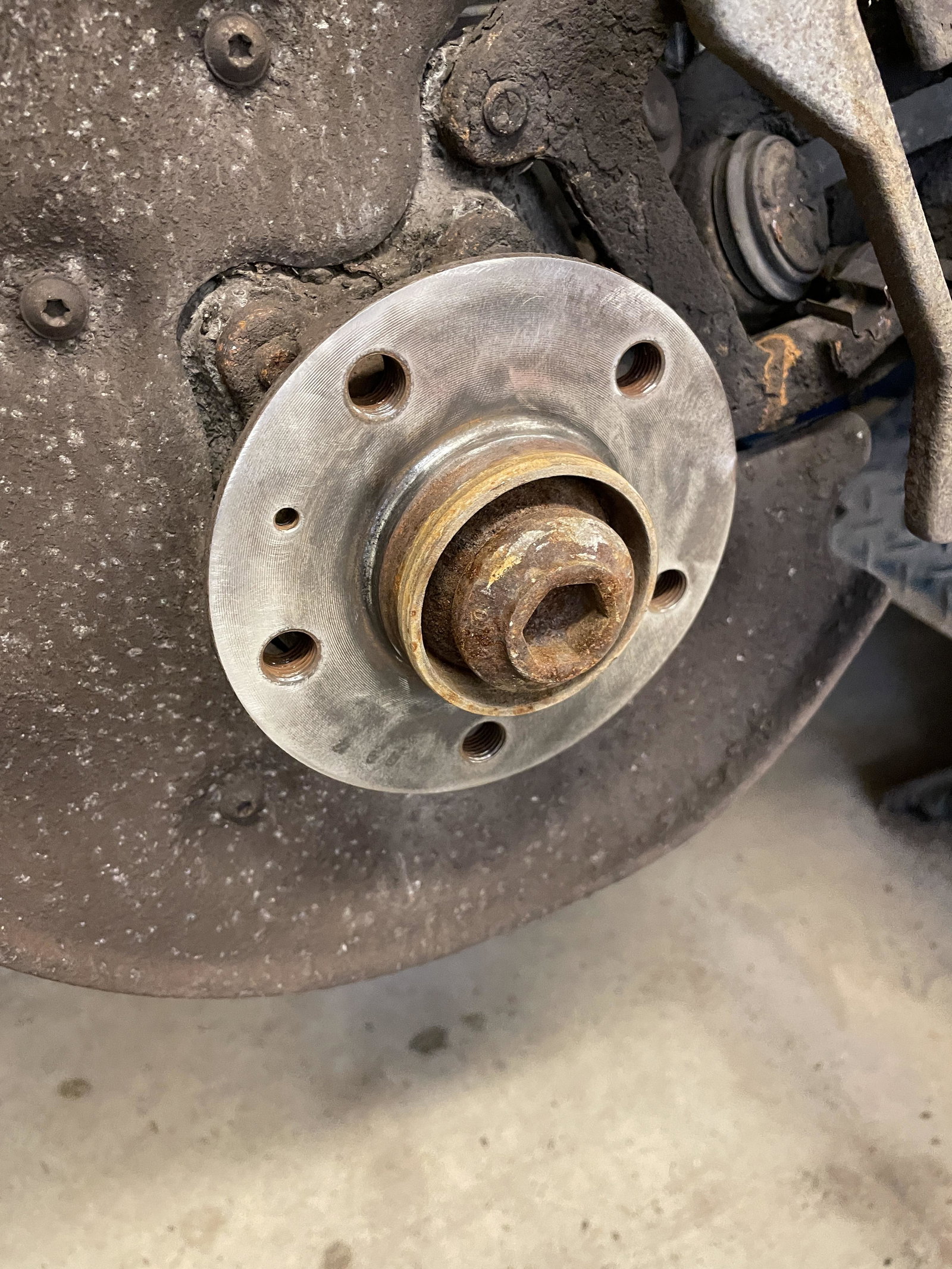

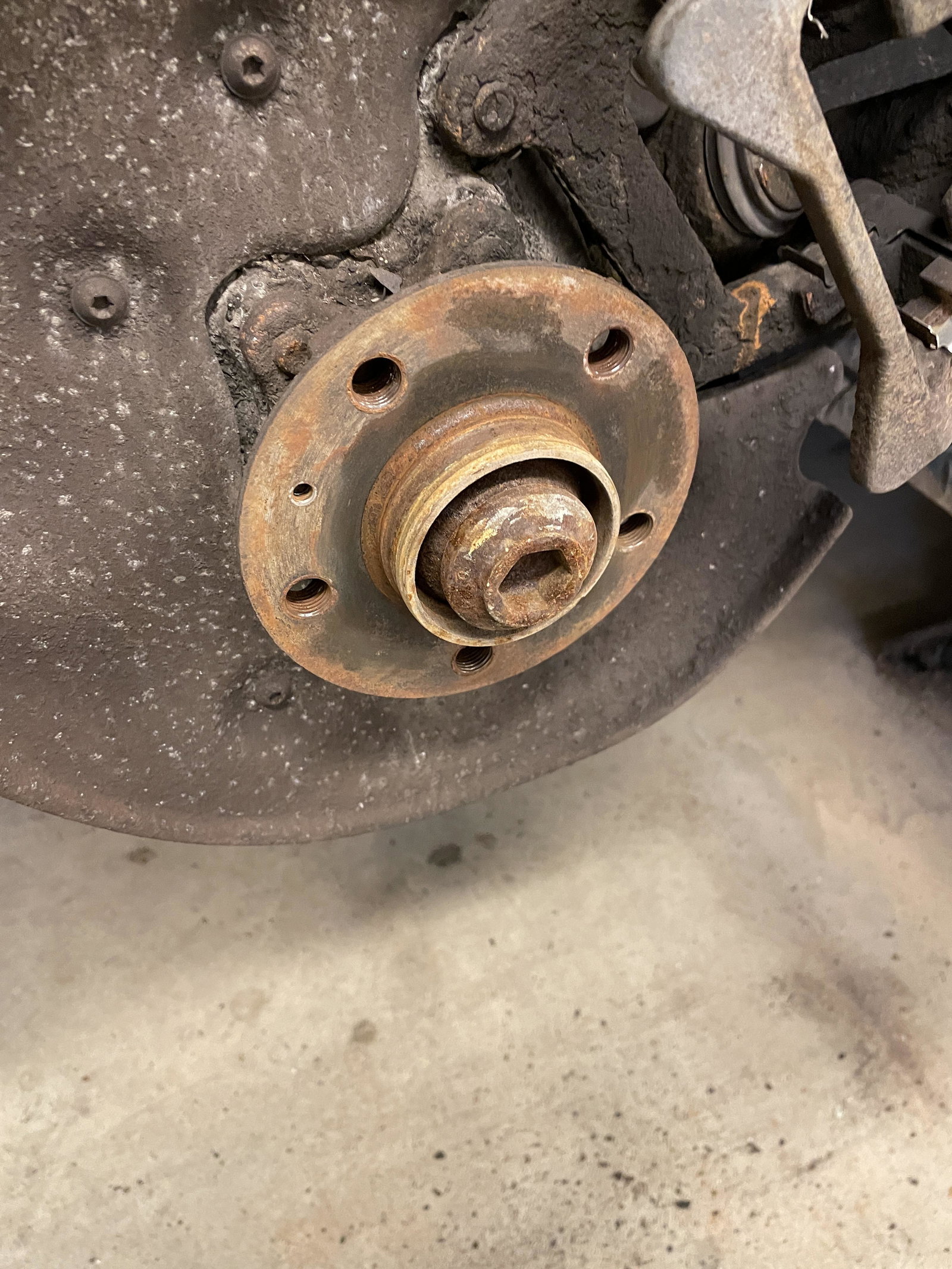

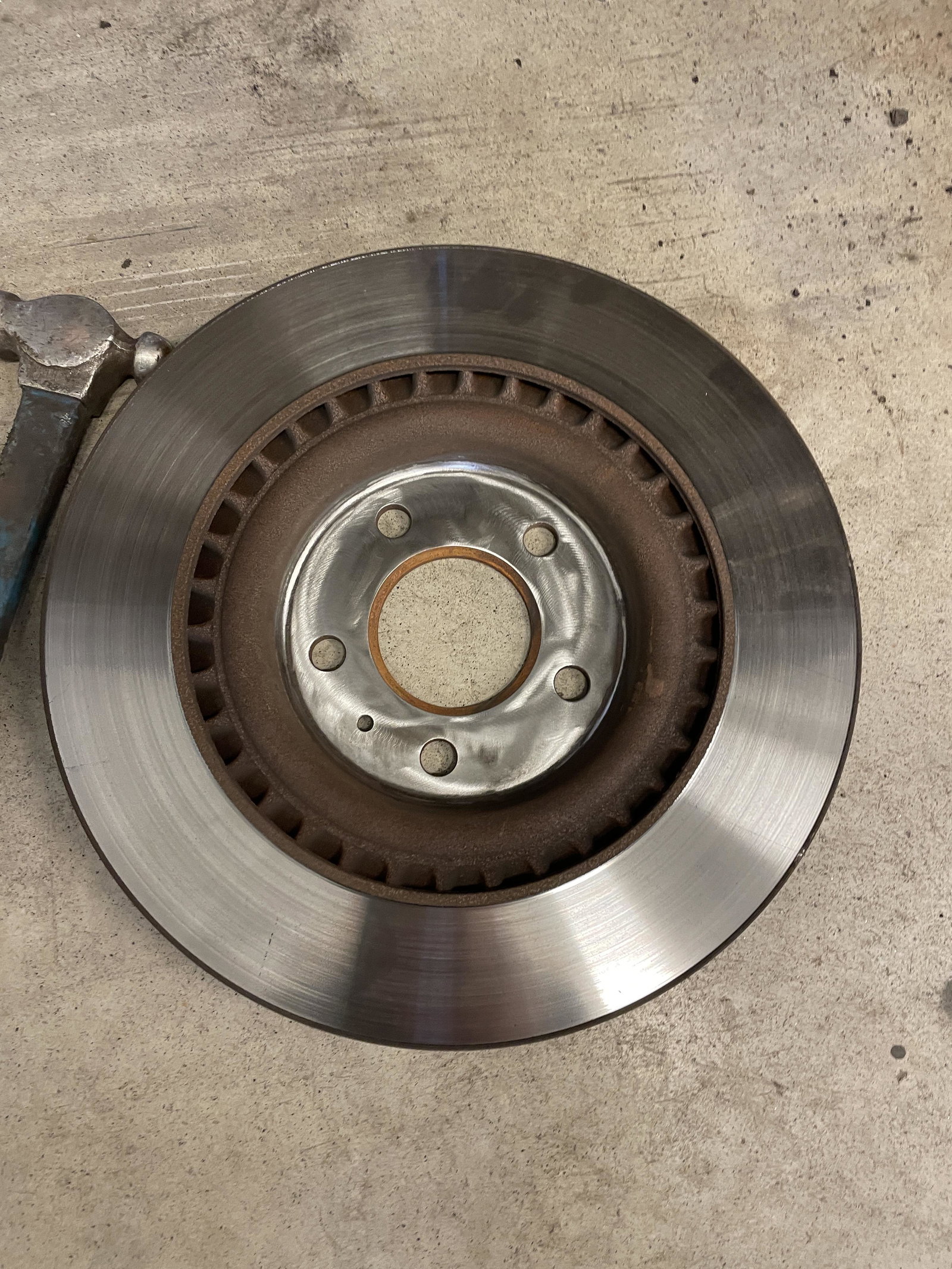

Steve Q Posted December 16, 2024 Posted December 16, 2024 Info credited to Harry Joynes: Hey everyone. Just thought I’d share my hunt for slightly pulsing brakes at low speed and a vibration in the seat at 50mph plus. After much searching the internet it lead me to a wheel bearing however I was thinking warped rear discs. I changed the fronts that stopped the steering wheel shake when braking I thought today I’d just take the wheels and docs off to see if there was anything noticeable and there it was. The hubs between the discs were corroded and pushing the whole lot ever so slightly off straight. Cleans all faces up and now it drives like a dream. Just a free thing to do if anyone is experiencing similar issues. Little before and after pic.
Magnet Posted December 16, 2024 Posted December 16, 2024 Thanks Steve, This is really straight from the book of best practice, and should always be done as a matter of course. DIYer have no excuse for not doing this - apart from ignorance, so certainly worth a mention. Garages not doing it, because it takes a little longer?? Anyway, thanks Steve. Kind regards, Gareth.

cliffcoggin Posted February 10 Posted February 10 55 minutes ago, nitch said: If I'm honest, I'm struggling to see what that corrosion is doing that would cause my symptoms When steel rusts it expands, thereby pushing adjacent parts away from each other. That's why rusty bolts are a swine to remove and brake discs are pushed out of alignment. 2
