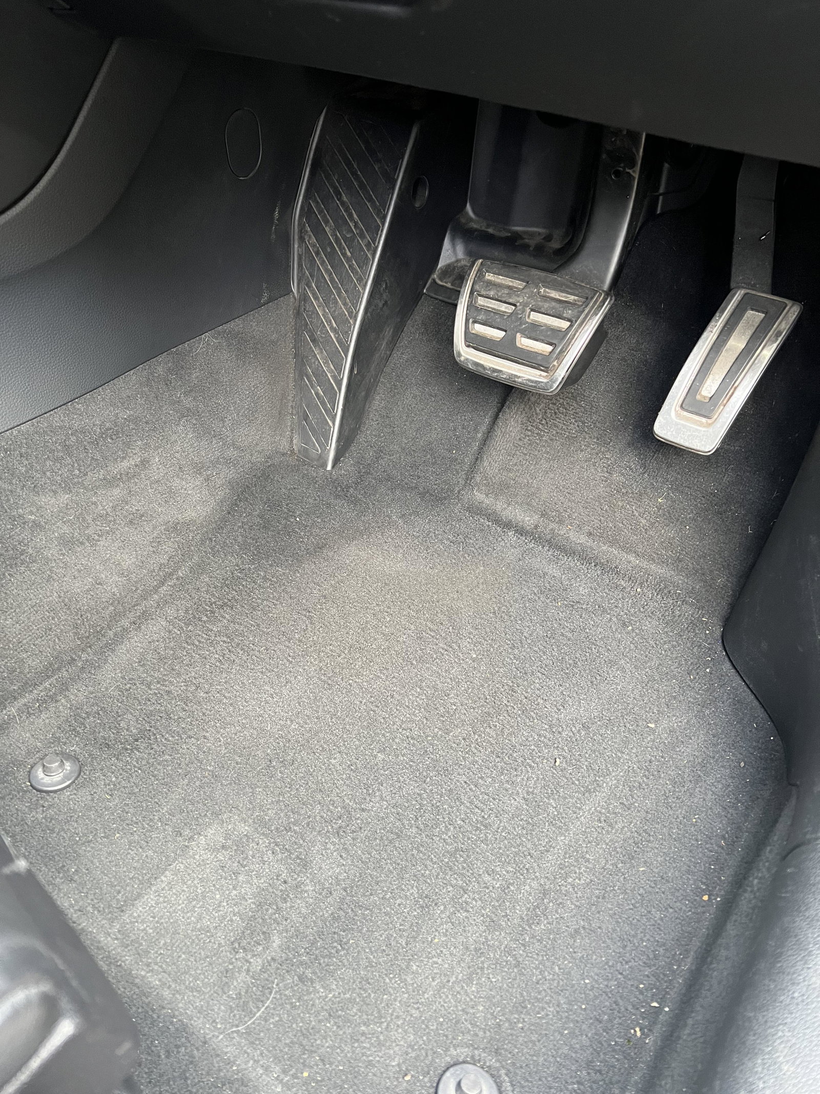

I own a 2017 Audi S3 (right-hand drive) and have noticed that the driver-side carpet is getting wet. The water begins accumulating in the top left corner (see attached photo) beneath the plastic footrest.

  • I dried out the carpet completely and left the car unused for two weeks while on holiday. During this time, the carpet remained dry, which makes me think it’s not due to rain or an external leak.
  • However, since resuming use of the car, the carpet has started getting wet again, which points to something internal causing the issue.
