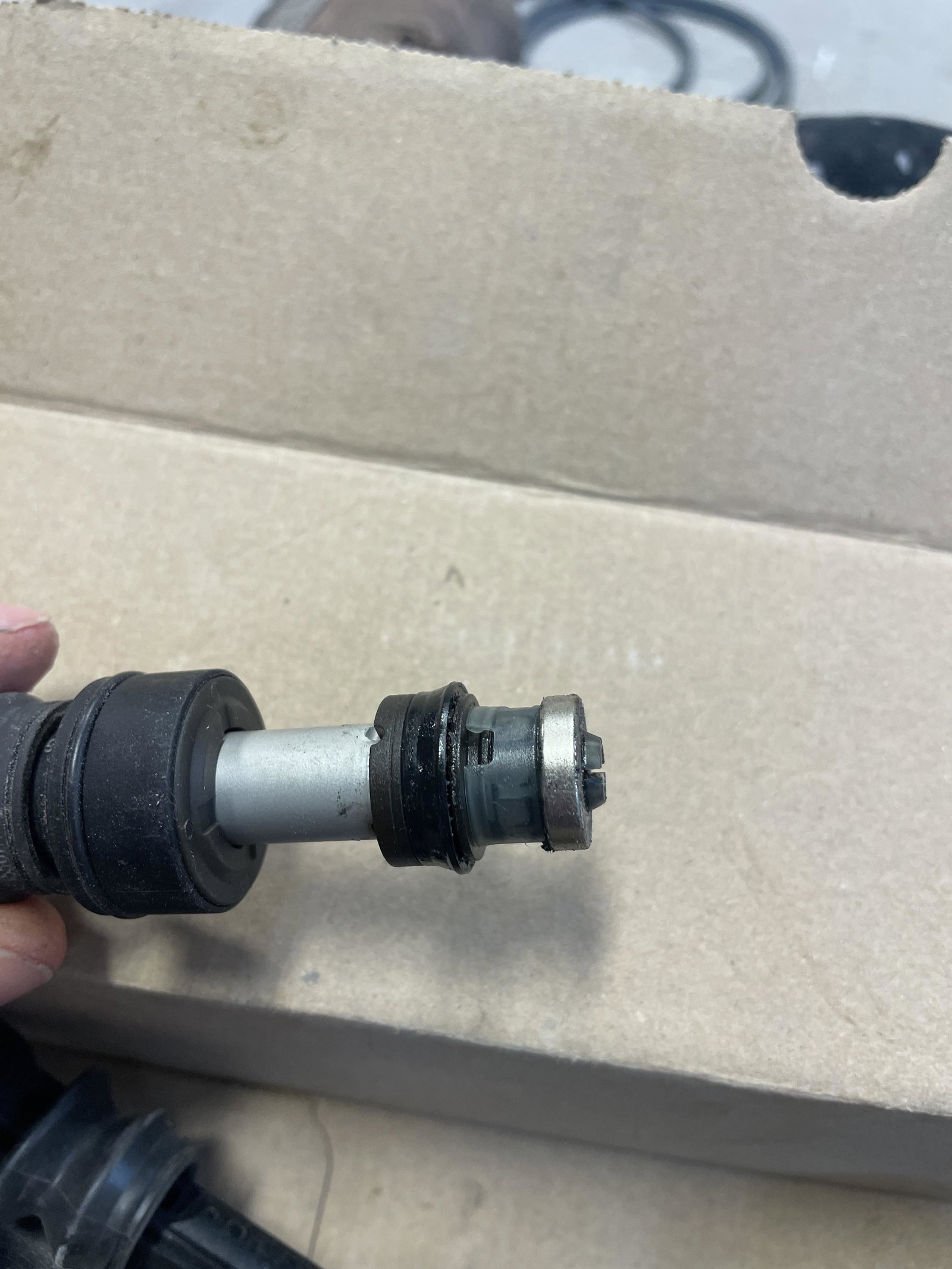

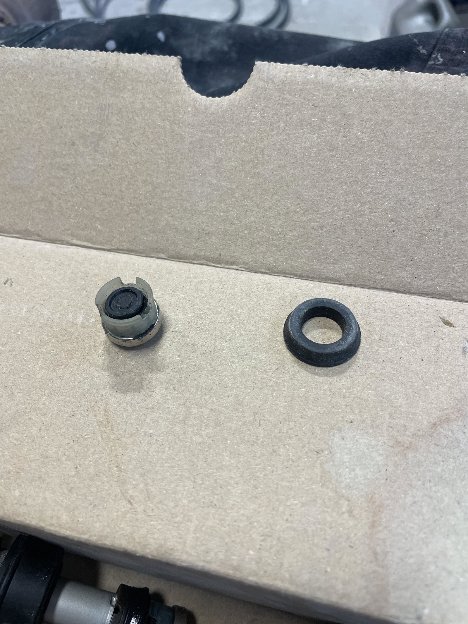

Sid2020 Posted December 31, 2024 Author Posted December 31, 2024 Great tip Steve thank you, il be off out to get some before I start, looking back this makes so much sense, when I replaced the clutch the original master bleed fine but failed a few months later, replaced with Audi unit, gradually developed a dragging clutch and couldn’t bleed thru the master either direction, replaced with febi unit and exact happening again, pulled 2 of the failed units apart and what was obvious is that the rubber in the check valve had swelled preventing fluid from the reservoir entering the cyclinder piston, it was trapped behind it. this clearly didn’t happen to factory installed unit with 90k until I replaced the clutch and used different fluid and have continued to use different fluids since

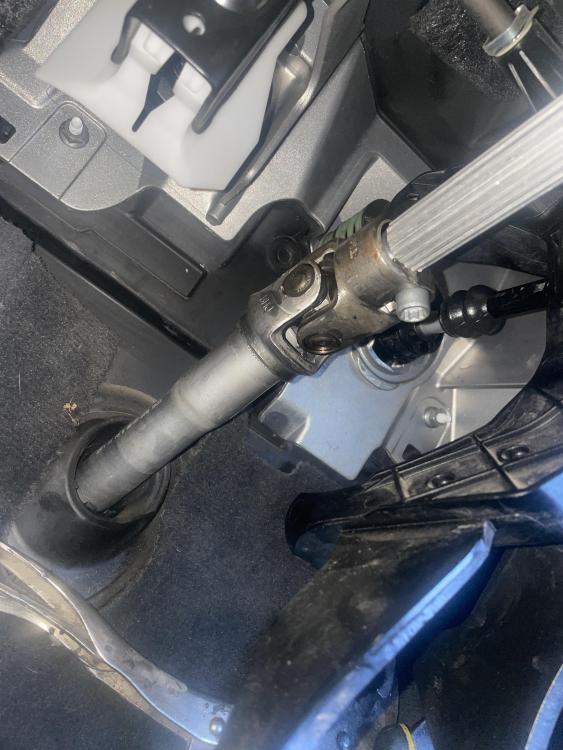

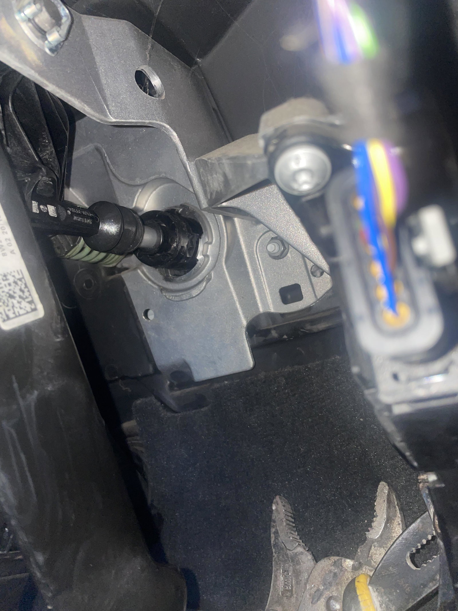

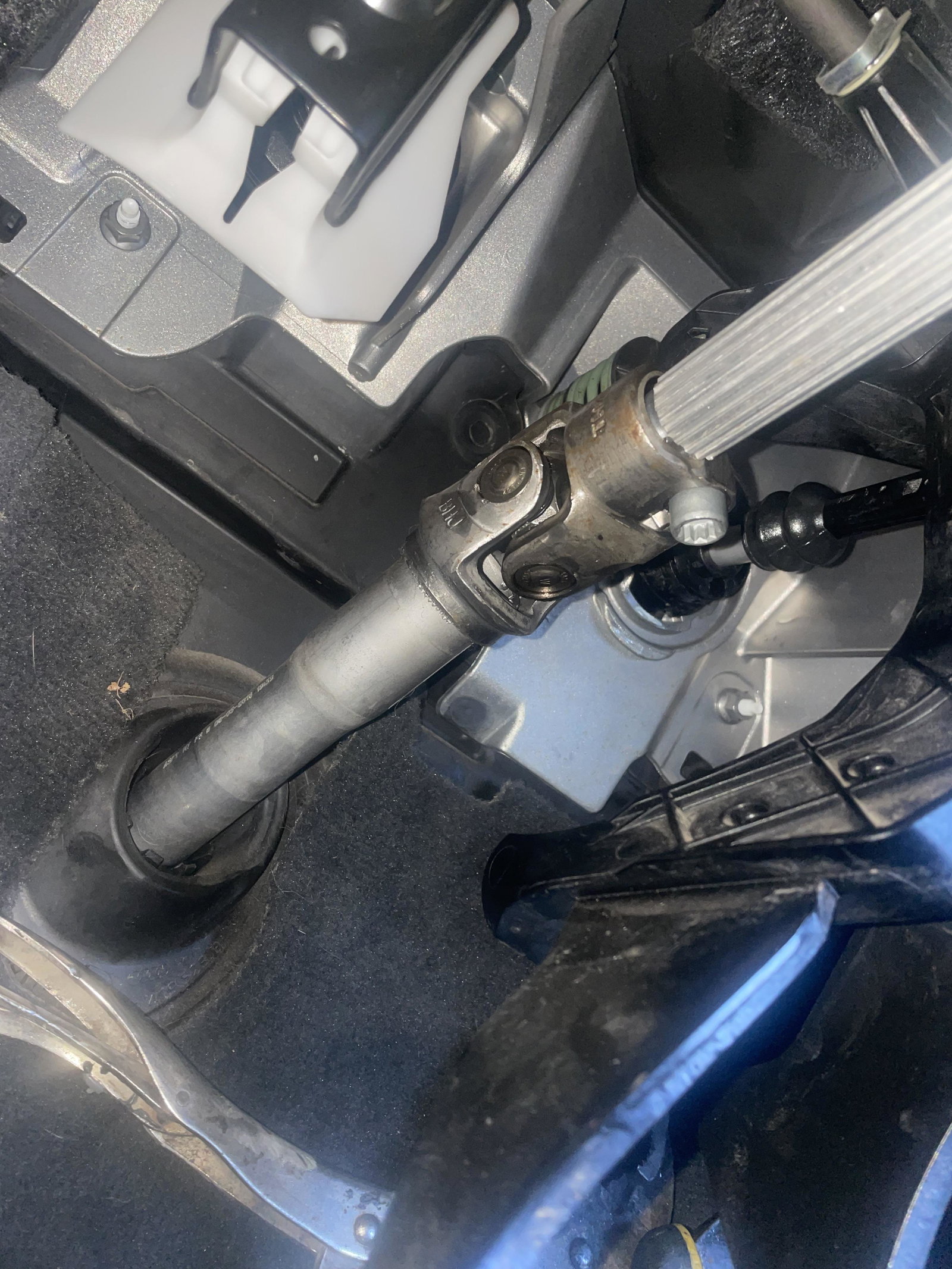

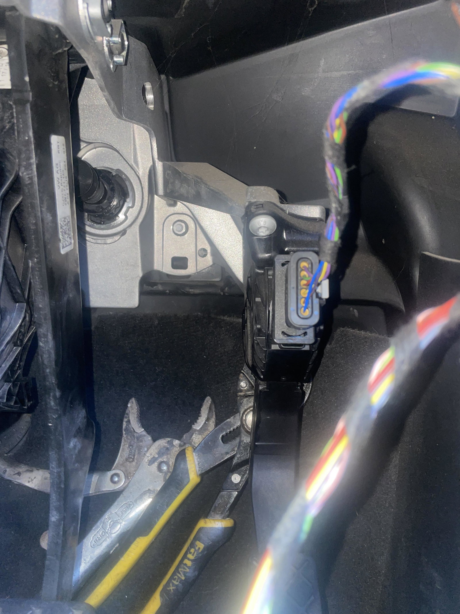

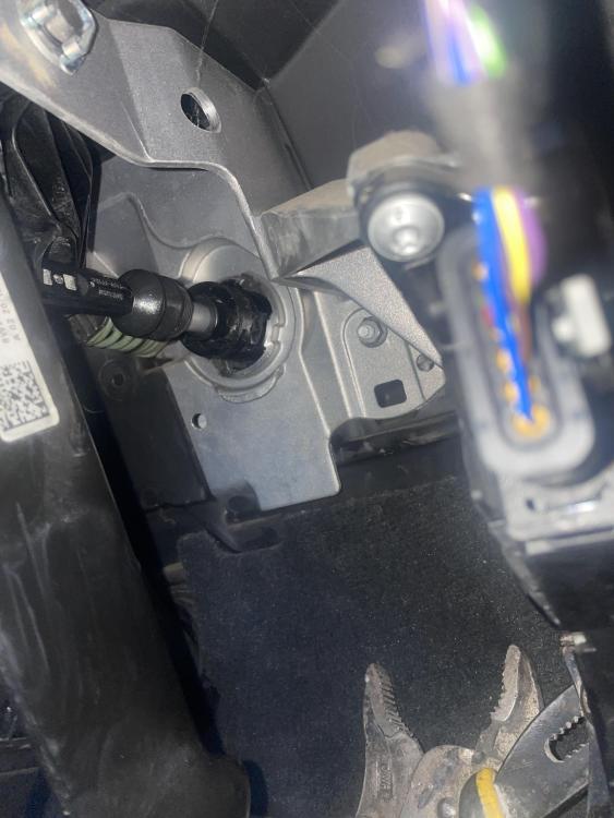

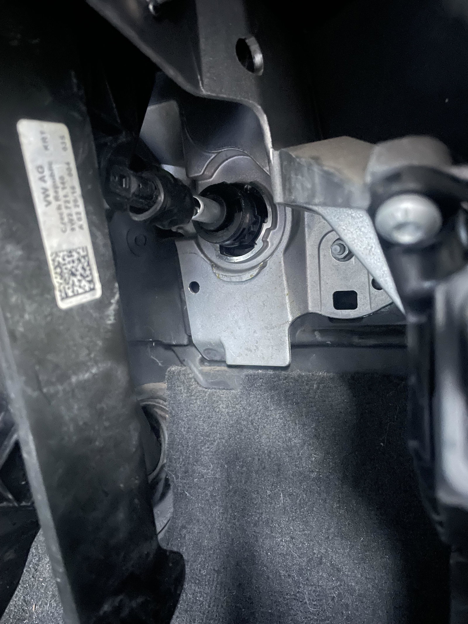

Sid2020 Posted December 31, 2024 Author Posted December 31, 2024 Master cyclinder fitted today, syringed out most the brake fluid in reservoir to save mess and also just normal Dot 4, pressure bleed using Comma Dot 4 esp/Lv fluid so time will tell now, got a few pictures of the mounting plate incase anyone benefits from them

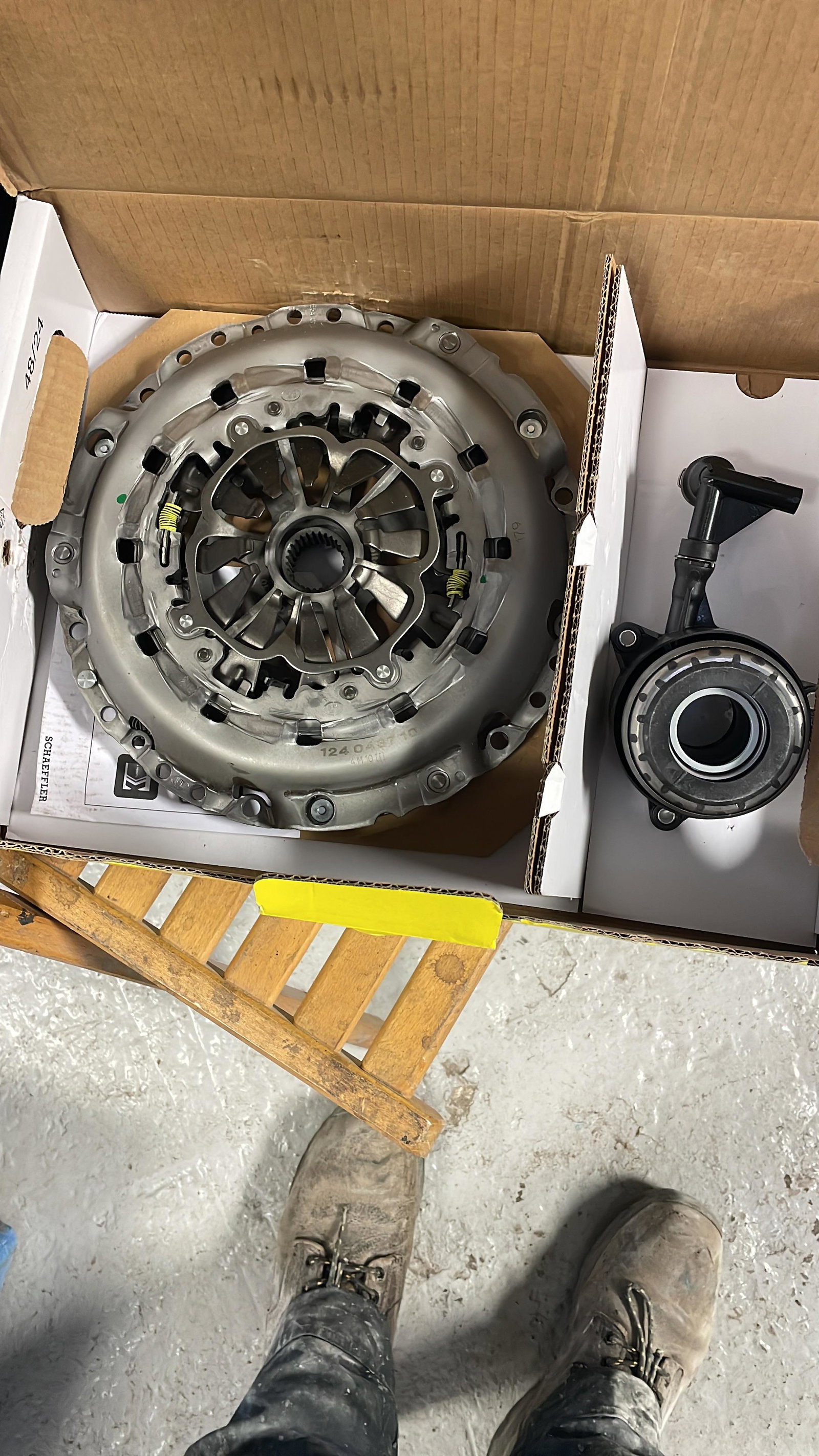

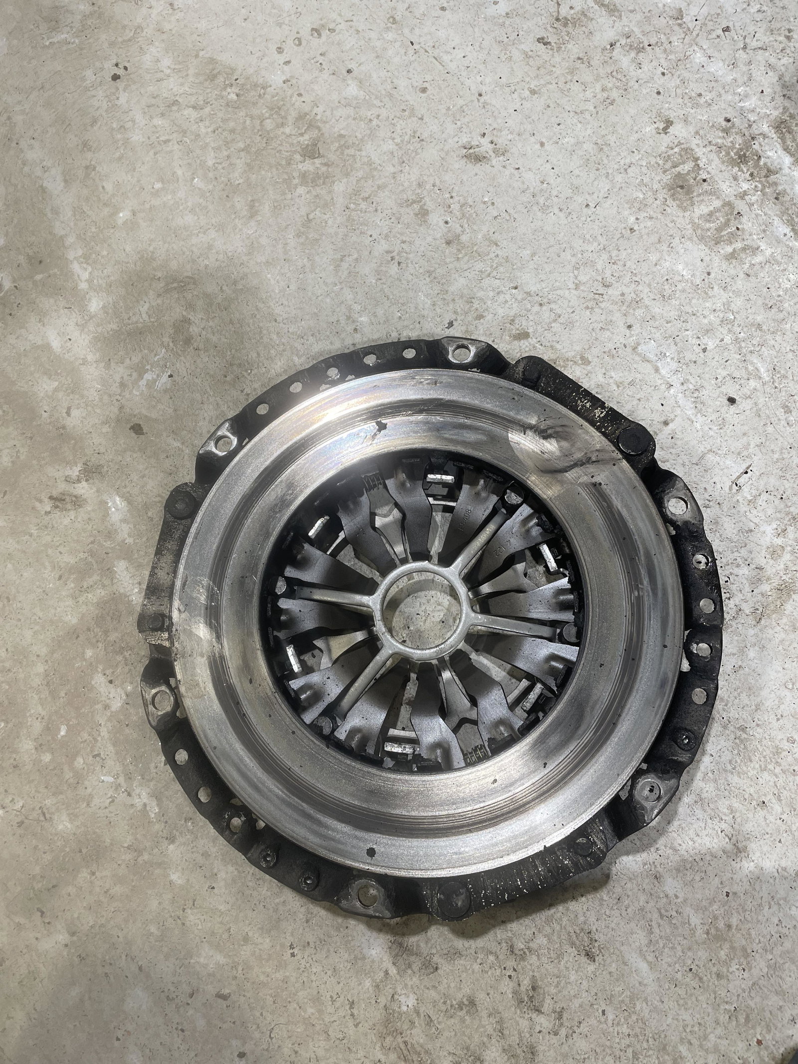

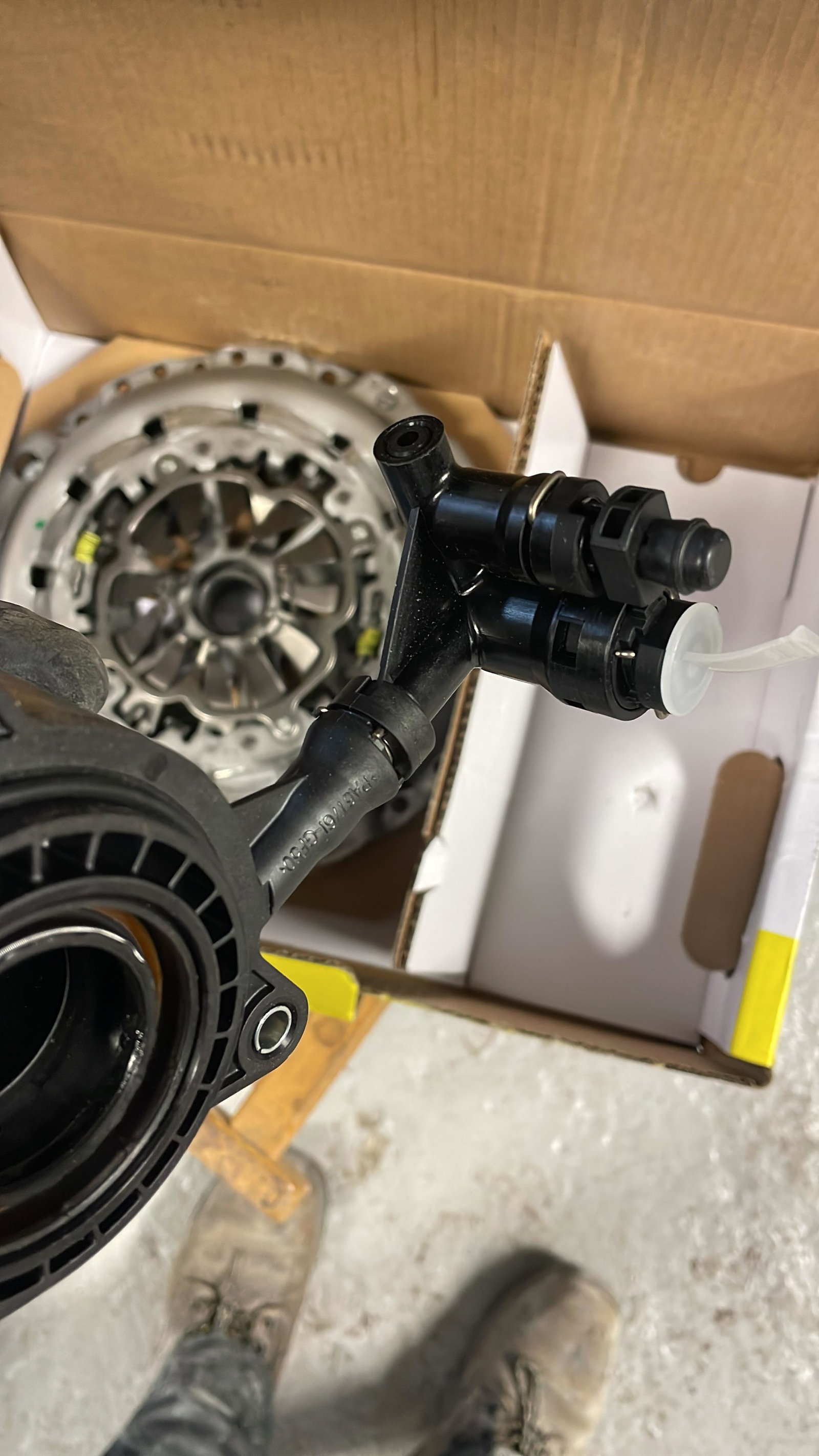

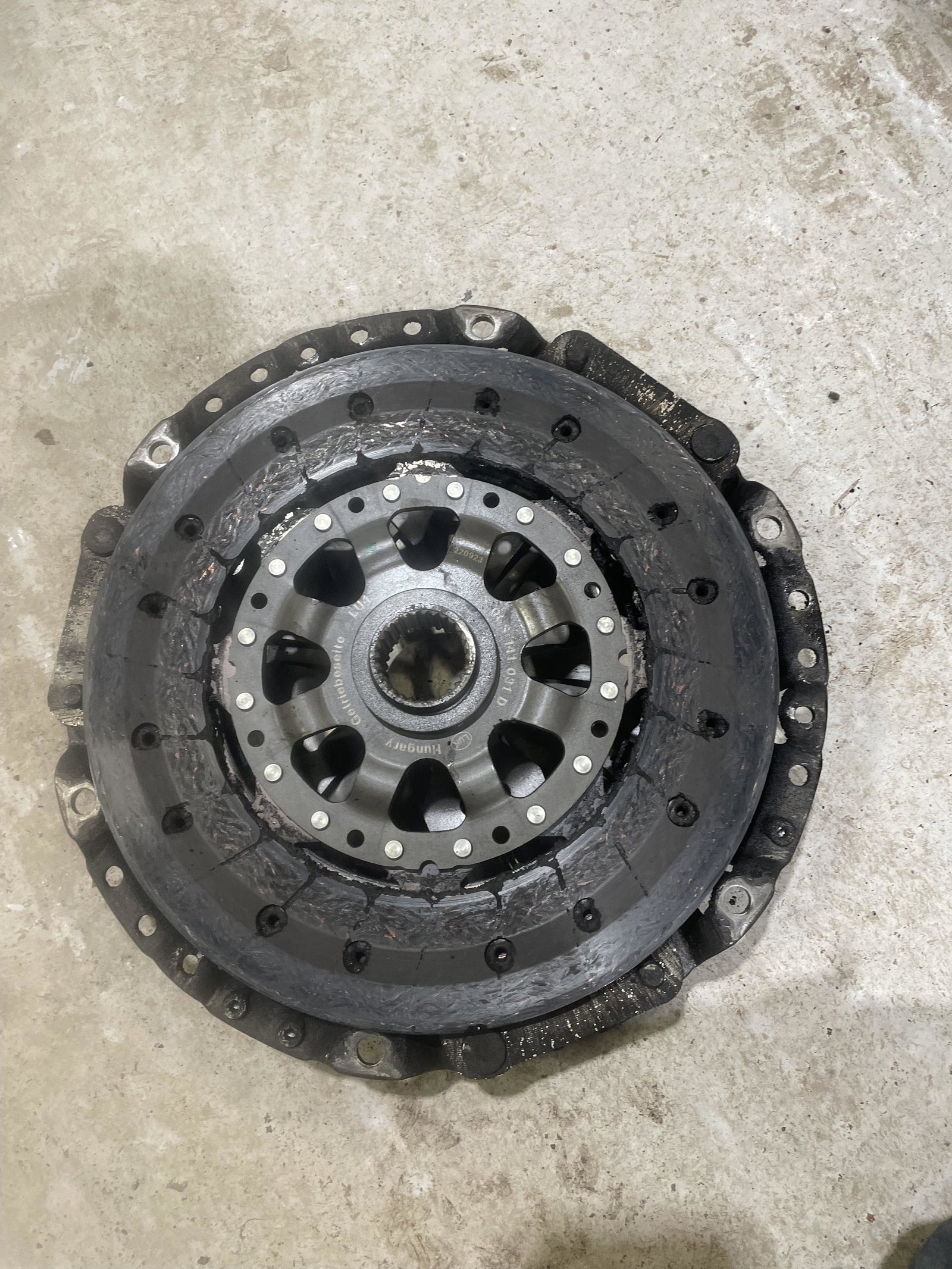

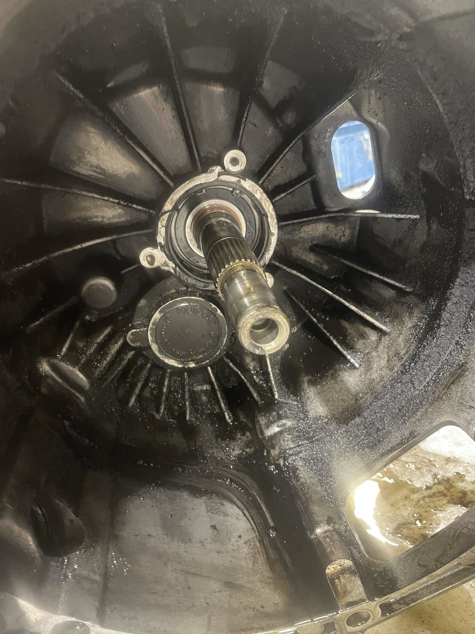

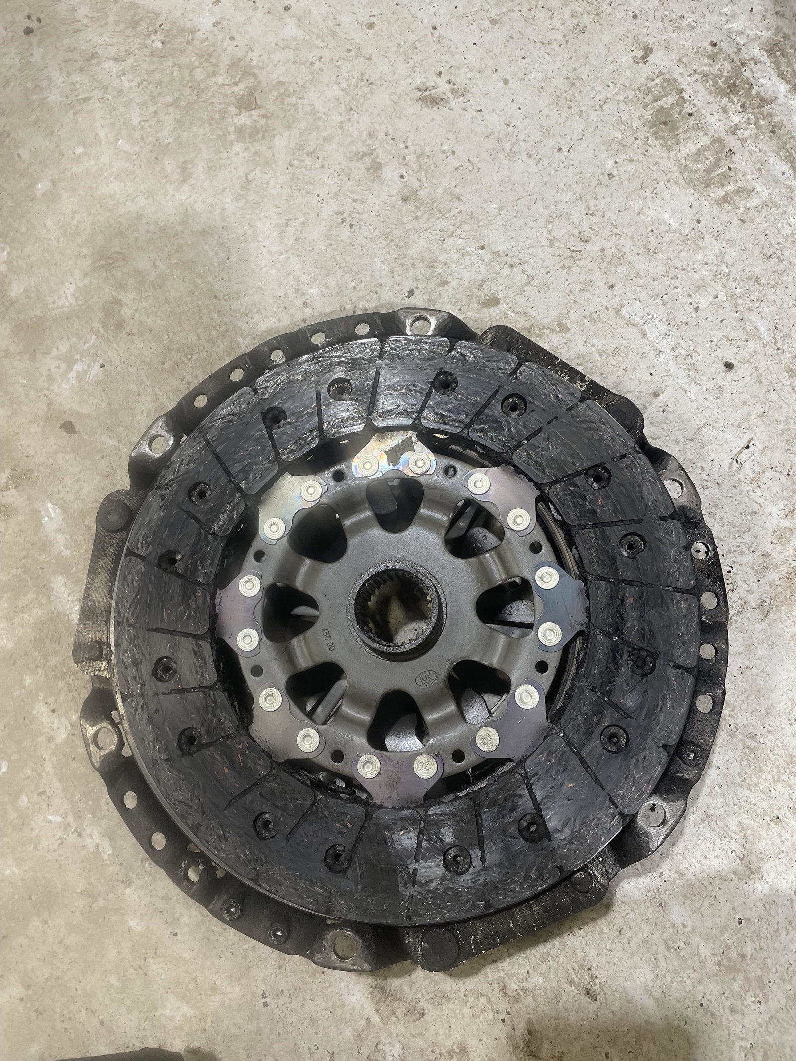

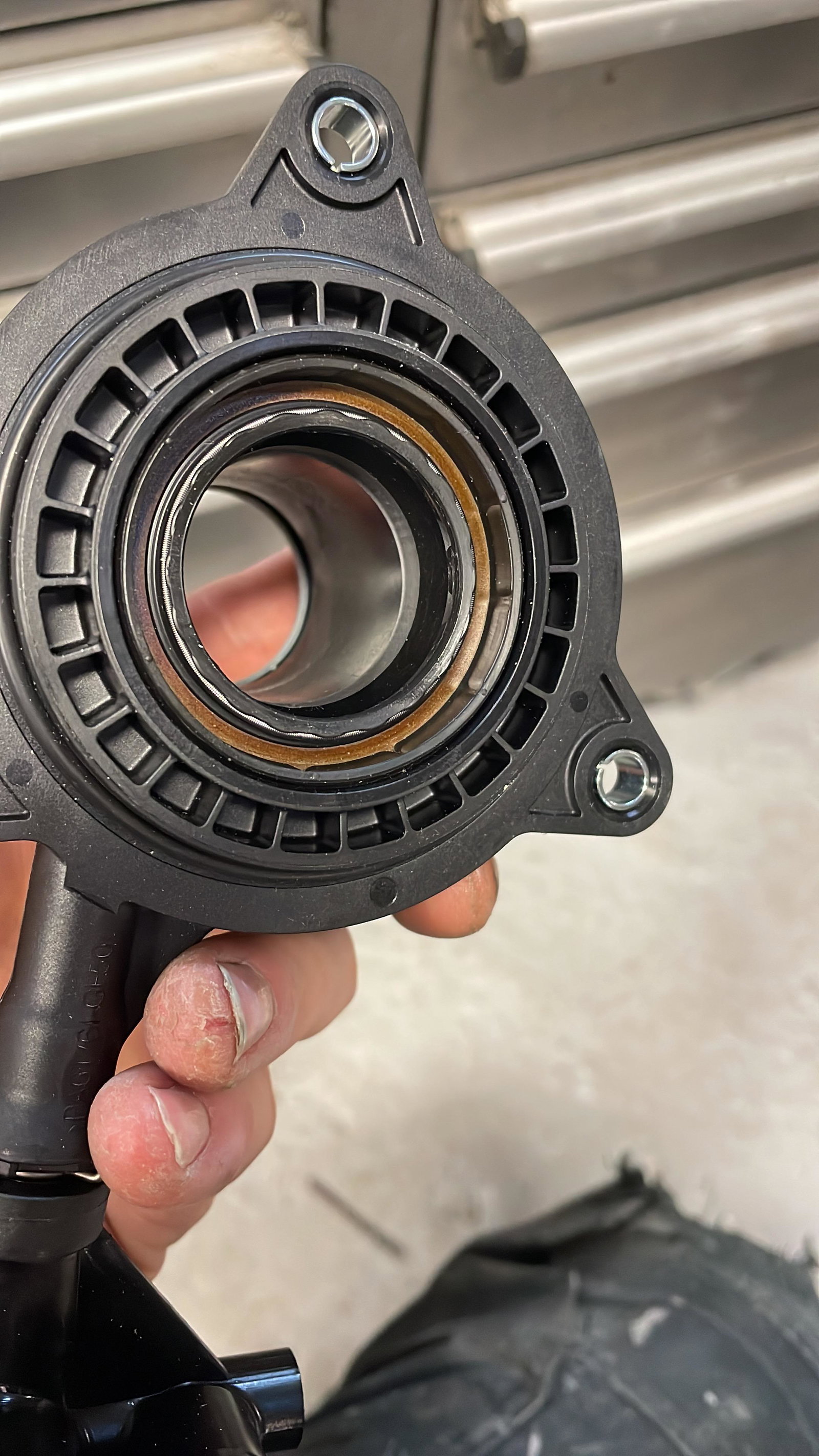

Sid2020 Posted February 7 Author Posted February 7 Late night update as just home from work, last weekend clutch started slipping suddenly even under modest loads so clutch kit ordered Monday thru work. LUK now do a kit for the b9 as previously it was only available thru Audi, kit includes clutch, pressure plate and slave cyclinder with bleeder extension and all seals already fitted which Audi do not include and bleeder extension was £105 on its own last time. wouldn’t describe it as a nice job as lots of stripping required but took about 6 hours in a workshop. the previous gearbox oil leak onto the clutch was clearly to blame as the clutch had started to disintegrate into a tar like substance sticking to everything. Post a few pictures of the items incase anyone is interested.
cliffcoggin Posted February 8 Posted February 8 So the new clutch only lasted five weeks? I have to wonder if it was the leaking oil that wrecked it or the soaking in Coke. Are you aware that Coke contains phosphoric acid? Personnally I would not be putting highly stressed components in an acid bath.

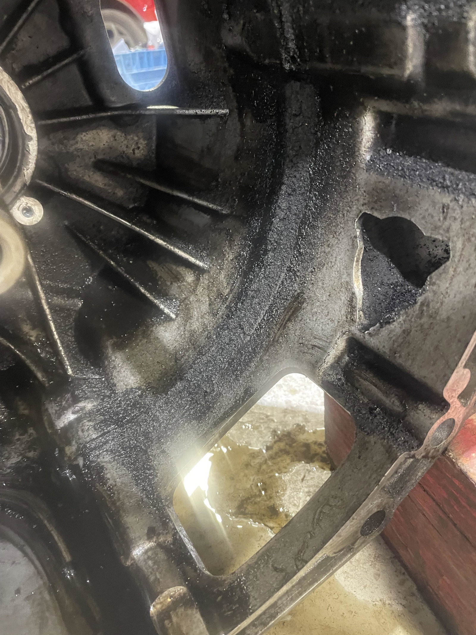

Sid2020 Posted February 8 Author Posted February 8 1 hour ago, cliffcoggin said: So the new clutch only lasted five weeks? I have to wonder if it was the leaking oil that wrecked it or the soaking in Coke. Are you aware that Coke contains phosphoric acid? Personnally I would not be putting highly stressed components in an acid bath. That’s the clutch that has been in for 2 years and suffered with getting a bath in gearbox oil for 3 months and then cleaned in coke when new seal was fitted so think it done well, regarding coke I drink it so not losing sleep washing my clutch in it 1
Sid2020 Posted February 8 Author Posted February 8 3 minutes ago, cliffcoggin said: Ah, I thought it was the new clutch that failed. Only fitted it last night so fingers crossed, replacement 2 years ago was a nightmare, parts only available from Audi who supplied the slave cyclinder with no rear oil seal which I didn’t notice as usually always come pre fitted, 3 months later and gearbox oil dripping from bell housing I sent several emails to Audi questioning this and there reply was that nothing on the parts list about inner seal which they emailed thru to my work, 3 days later Audi uk sent a updated parts break down showing the seal which the supplied FOC. As my labor costs me nothing I cleaned the clutch plate and thought it was worth a try. The oil in the picture inside the bell housing is just what came out the driveshaft hole when moving the box around last night
