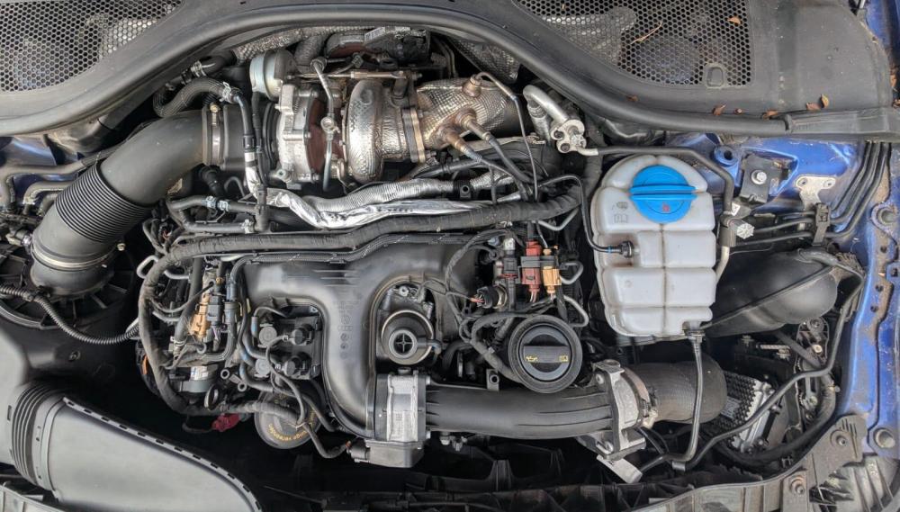

-MONKEY- Posted December 29, 2024 Posted December 29, 2024 Hi from a newbie. Can someone please tell me wherebis the Adblue (/DEF/SCR) injector? Having all sorts of issues with Adblue so wanted to check the injector to see if it's leaking or whatever. I'm getting through about 10 litres of Adblue a week (!) so I'm assuming there's either a major leak somewhere or the injector's stuck open with crystallised Adblue. Can't see any obvious leaks under the car so it's more likely the latter I'd think. Getting engine P20E8 faults, Adblue low level warnings etc. I keep clearing the codes, SCR lock and level with VCDS after topping up. It only makes the errors go away for a few days at most each time. I've been Googling forever and can't find any relevant info about where it is. Most relate to non Euro 6 versions which I guess don't have Adblue systems (?). All I know is that it's apparently somewhere in between the cat and dpf (wherever they are!). Pleeeeease someone clue me in before I go nuts! Can't afford to take it to a dealer and no warranty left. Any help much appreciated. Thanks! If it helps, here's an overhead pic of my engine bay...

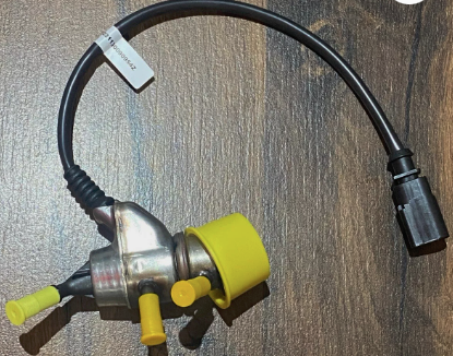

-MONKEY- Posted January 5 Author Posted January 5 (edited) On 1/4/2025 at 9:02 PM, K3v said: Hi, Iirc, it's one of those. Top one maybe. Have you looked on you tube? There are videos of it. I've seen a photo of the pipe leaking to the intercooler and it was covered with white crystals, should be easy to spot if it's a big leak. How long has it been using 10l a week? Reason I'm Asking is that mine had spells of needing filling up a few times over a short spell then it would calm down. My tank packed in a few months ago and now mine is turned off, couldn't bring myself to pay the big bill. Expand Thanks for the photo. That's exactly the same as mine (3.0 BiTDI). Guess yours is also RH drive (in the UK)? However, I'm pretty certain it's neither of those 3 connections into the exhaust. The SCR injector apparently has 4 attachments: 1 for the electrical connector, 1 for the Adblue feed and 2 other pipes (whatever they're for). See the attached pic. I've put about 40 Ltrs of Adblue in over the last couple of months and done no more than say 3,000 miles in that time. Also been using the Wynns de-crystallizer each time in the hopes that might clear things up. The last time I put another 10 Ltrs in last week, the warning light disappeared but was back on again within only about 20 more miles. Either there's a mighty leak somewhere or maybe the injector's stuck open (?). Inside the tailpipes looks clean & dry though. Really don't want to put it with a dealer. Countless posts show they don't really know what the issues are either and will just blow your money replacing expensive parts like a new tank, injector, nox sensor etc and still not sort it out. This whole Adblue issue is an outright disgrace. Audi should solve it and offer a free fix for ALL cars, even out-of-warranty. I'm getting very close to an Adblue delete now. Would rather not go that way though. If I can finally find out *where* the injector is I'll try cleaning it as a last resort. Edited January 5 by -MONKEY- typo
