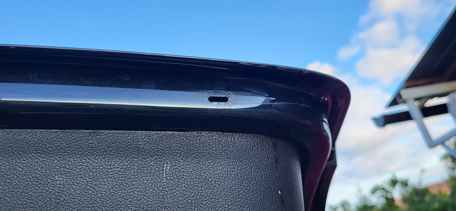

ACel Posted 5 hours ago Author Posted 5 hours ago So I had a quick look today - I’m not really hugely skilled so I didn’t know what I was doing. At the bottom of the bootlid itself there are two tiny 1cm is black feet that I took out (I have obviously managed to break one as I’m useless) but a decent amount of water drained from one of them. The car is going in for a service in a couple of weeks hopefully they can sort it out. Quite annoying for a car that’s only 4 years old.
Sid2020 Posted 3 hours ago Posted 3 hours ago They can become blocked with sludge on the doors but the tailgate should not get a ingress of water as everything fitted to it has seals and the rear window is bonded into place so something has failed
spartacus 68 Posted 3 hours ago Posted 3 hours ago Acel they are bungs for the tailgate only. The bump stops are on the rear quarter near the lights.
