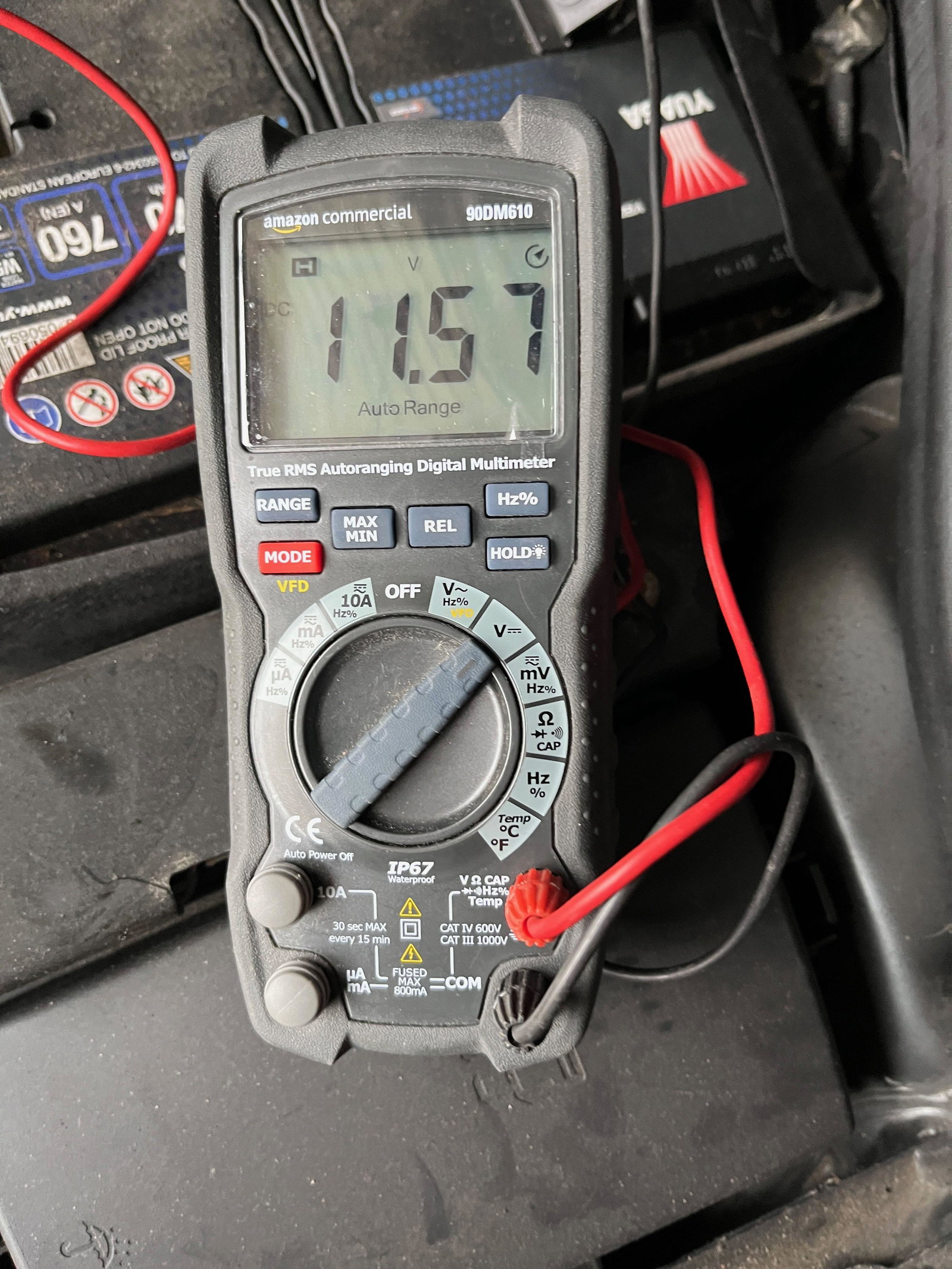

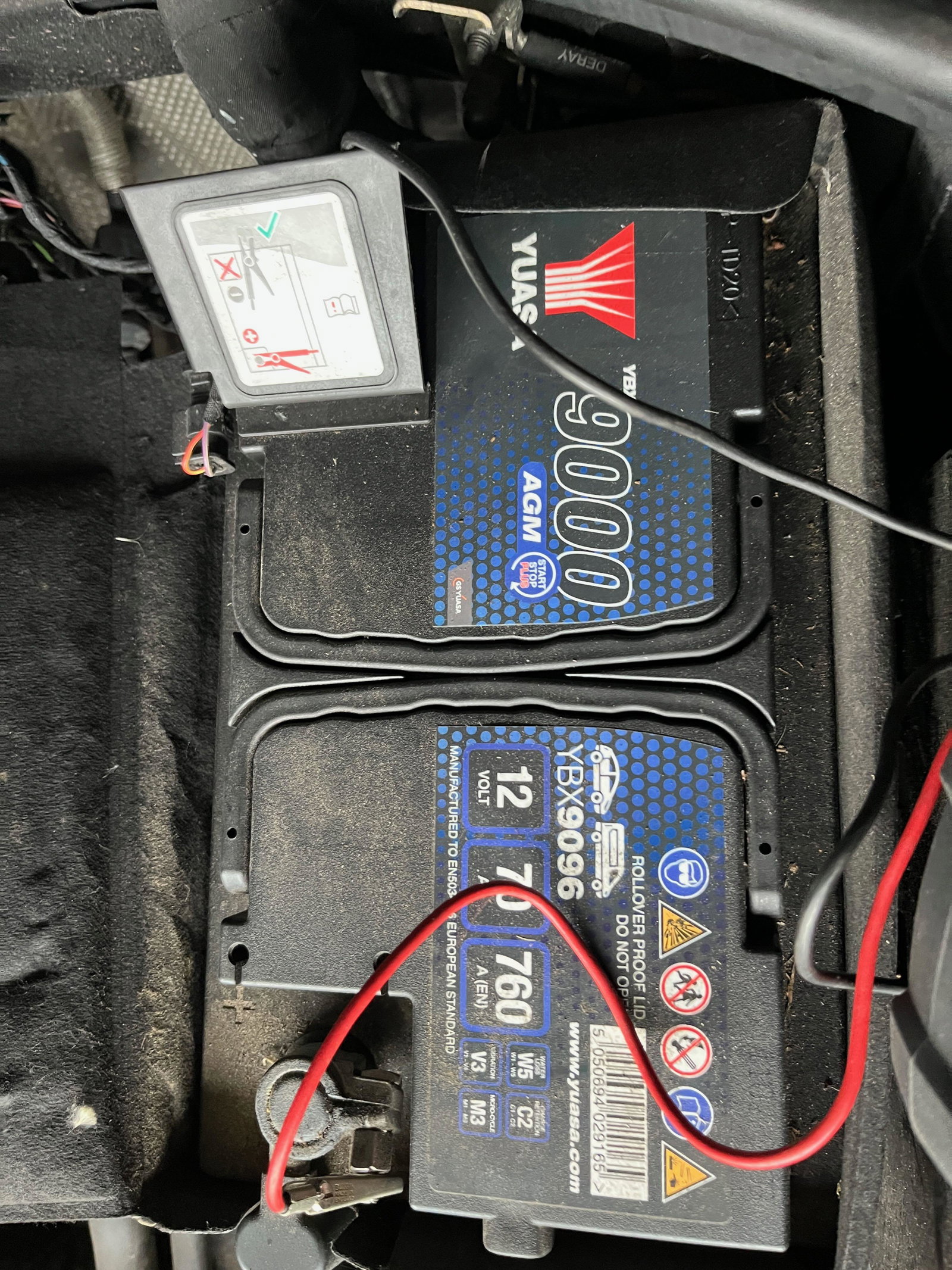

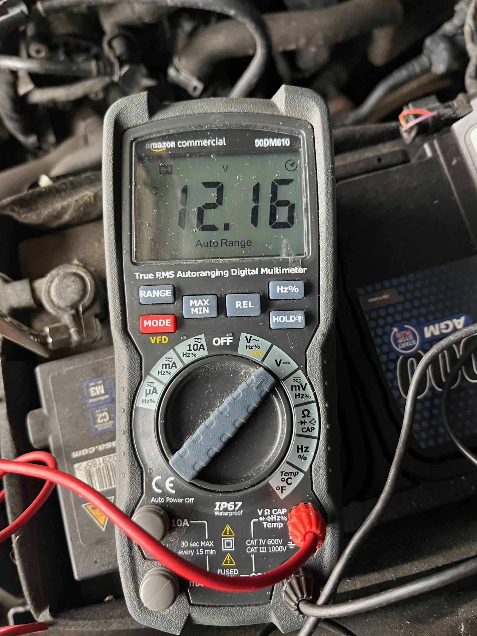

etaf Posted Sunday at 11:45 AM Posted Sunday at 11:45 AM (edited) I get a "Battery LOW warning, battery will charge while driving" Warning, after leaving the car a few days - then once i take for a drive , its ok , until left a few days again took it to the garage and they tested the battery (replaced 5 years ago ) and the alternator and could find nothing wrong I suspect something is slowly draining the battery ben left for exactly 7 days - and got the error message Car started first time I should have measured the battery without the car on at all - But didnt Went on a 20mile run keeping high revs and then i thought of measuring the battery every few days so straight after the 20mile run its 12.16 V DC I see that 12.6 should be the nominal, maybe i should go on a much longer run .... and see if i can get the voltage higher The garage did test the Battery for any drain , thats what they said , for condition as they know its 5 years old and changed it for me 5 years ago - also they thought maybe an alternator fault - but that was fine I have no idea how this drain would be found I had the nearside light repaired , they found an issue with the control unit and took the light out and replaced the control unit and bulb - as suggested by a mate of the garage in Audi (saved a hundreds £££££ ) as a new light would cost about £700 and not sure what that included !!!!! I have a post about the HID light here Edited Sunday at 11:59 AM by etaf
cliffcoggin Posted Sunday at 12:08 PM Posted Sunday at 12:08 PM I very much doubt that power is draining from your battery, but why not check for yourself with the multimeter shown in your photo? That's what it is for. More probable is that your battery is clapped out, and needs to be renewed. After all it is five years old, the same age at which the original battery was renewed. (The simple voltage test after a run that you showed is meaningless.) Make sure you buy a decent quality battery, and get it coded to the car.
etaf Posted Sunday at 12:11 PM Author Posted Sunday at 12:11 PM thanks so much for the reply That was the discussion i had with the garage when they looked up the age and they said they would check it all OUT yep, they did get a decent battery and coded it into the car , as its an autostop/start thing I wonder why the garage said the battery was fine last month , best ask them next week
spartacus 68 Posted Sunday at 03:13 PM Posted Sunday at 03:13 PM 5 years is kind of average for a battery. That said cars now are very susceptible to weak or worn batteries and your dash will light up like a Christmas tree. Especially with start/stop, air conditioning, heated seats, etc. Better to replace than risk being stranded. Cold weather adds another factor so cold cranking amps are reduced and you’ll find the car may not have the power to start it. You can check with a multimeter at cold before a run. I’d expect 12.6v or so. At running, this can go up to 14.7v, but that’s important because it shows how it’s handling load. Most modern batteries are AGM, so I assume that’s what has been fitted as it handles start stop. 1
etaf Posted Sunday at 03:17 PM Author Posted Sunday at 03:17 PM thanks I did say that to the garage , when they looked up when they changed the battery and said it proably needs replacing - BUT they tested everything (£51 charge) and said all was fine, clearly its NOT so i guess i will call again tomorrow it seems to start fine , no issue , in a garage but cold yep, you can just make out AGM in the image i posted
