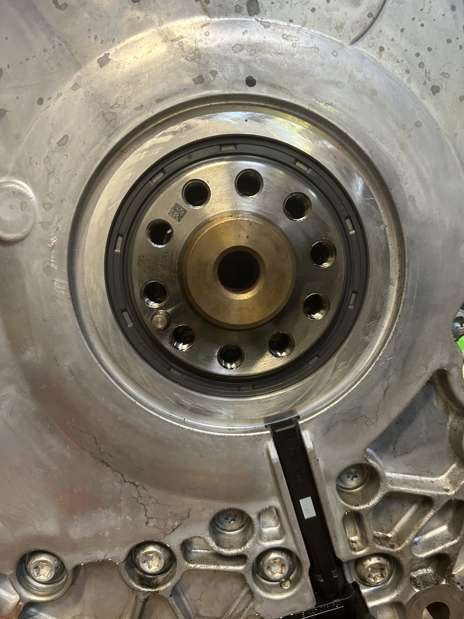

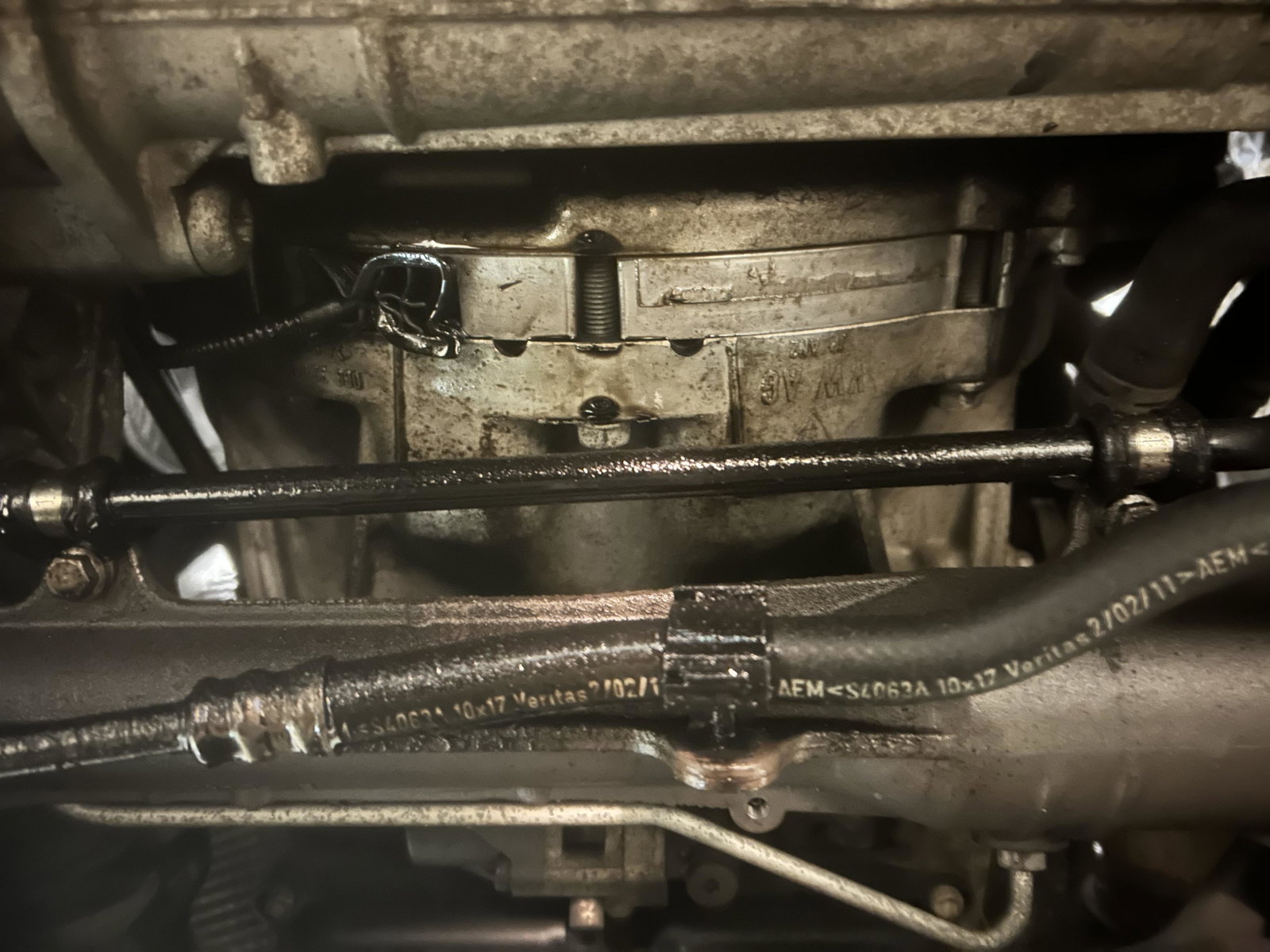

Last Boy Scout Posted Saturday at 08:00 PM Author Posted Saturday at 08:00 PM Anyone changed this seal…? Interested to know what type of thread lock used…. Seal changed but still got a leak from somewhere…. 👀🤦♂️
Magnet Posted Saturday at 09:27 PM Posted Saturday at 09:27 PM Hello Stuart, So you have already replaced the seal once ( in recent past?) and it still leaks?? If so, if the new seal used was of a reputable brand, then it’s probable that the rear main bearing is worn to an extent that allows to crankshaft to whip slightly and keep wearing the seal. Kind regards, Gareth.
Last Boy Scout Posted Sunday at 02:20 AM Author Posted Sunday at 02:20 AM Hi Gareth. Yeah I changed it but the same problem I had before was still there….as if the seal wasn’t the problem.

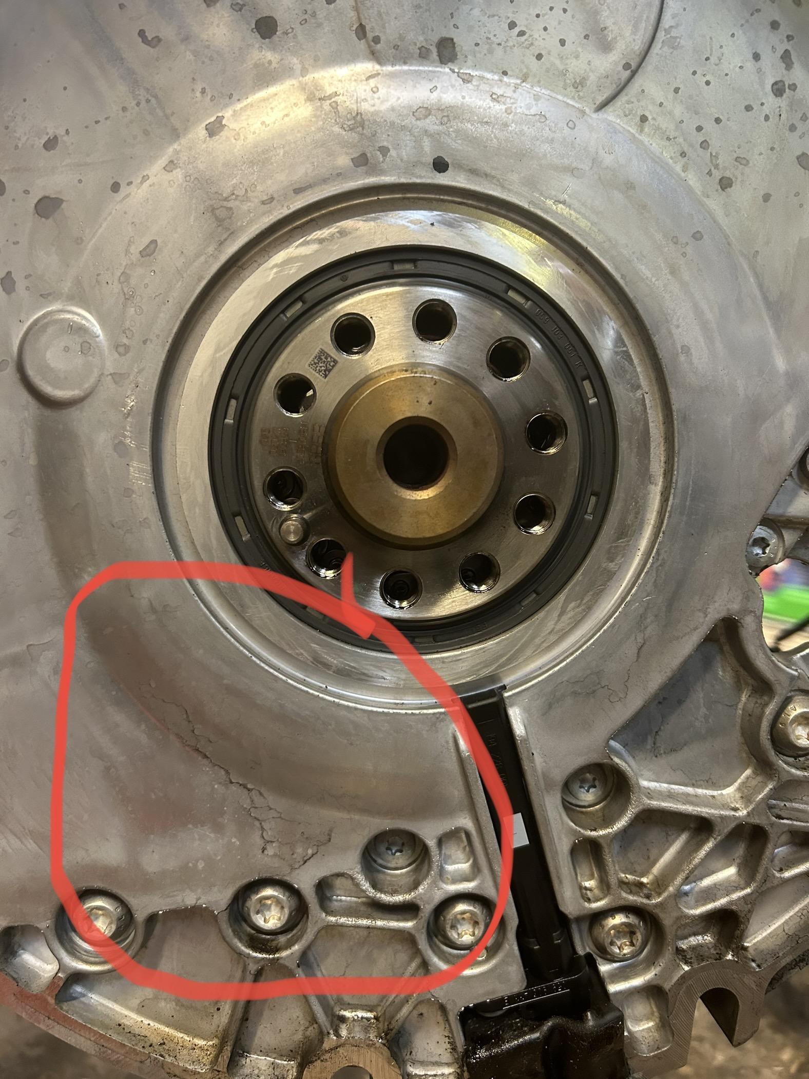

Last Boy Scout Posted Sunday at 02:23 AM Author Posted Sunday at 02:23 AM Looking through pics and seen the Timing cover looks like it may be cracked….have you ever seen this? What is the recommended thread lock for the Flywheel bolts…anyone know?
