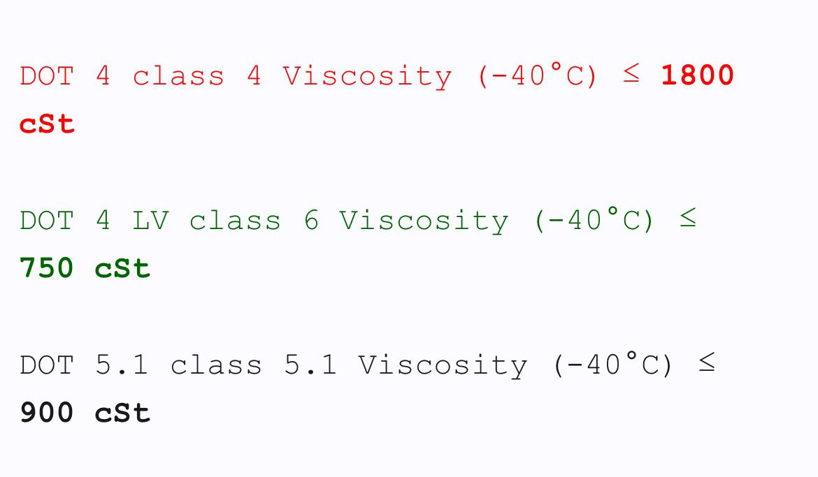

Sid2020 Posted January 13 Posted January 13 The clutch pedals on the b9 don’t lend themselves well to a resting foot due to the way the master cyclinder connects to it. The master cyclinder uses a portion of its travel just to fix it into the rear of the pedal so any pressure on it has a direct result on the slave cyclinder, Steve Y gives great advice, give it a real good bleed using comma Dot 4 ESP, standard Dot 4 has a higher viscosity and the master cyclinder and clutch delay valve really doesn’t cope well with it.
Sid2020 Posted January 13 Posted January 13 Dot 4 LV is same as Dot 4 ESP just different name for different countries
