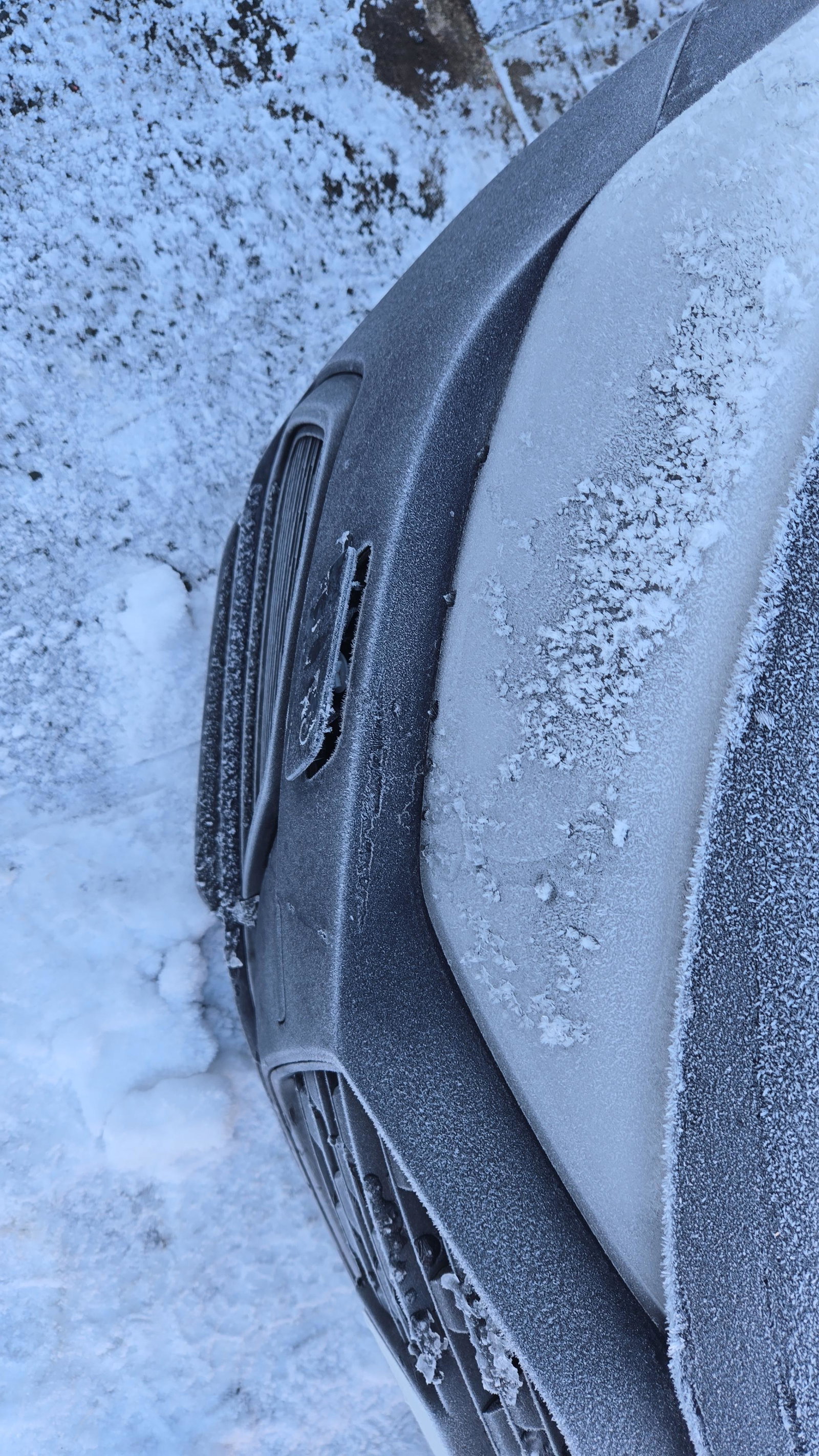

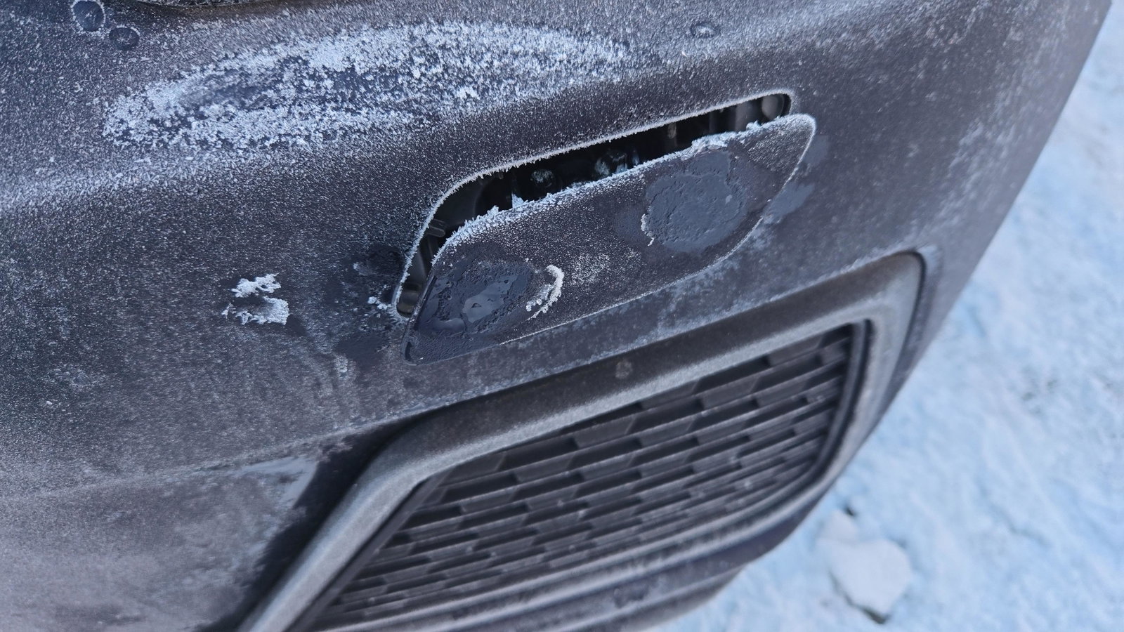

Good morning. I trust you are all well. I have noticed two on either side popped out on my front bumper; could anyone advise on the cause and how to repair them?
I believe it's for the headlight washer
It's definitely headlight washer. This can be quite normal in these very cold conditions. Don't push them back in as you can break them. Let them go back in on their own once it's warmed up.
Perfect thank you for your help
