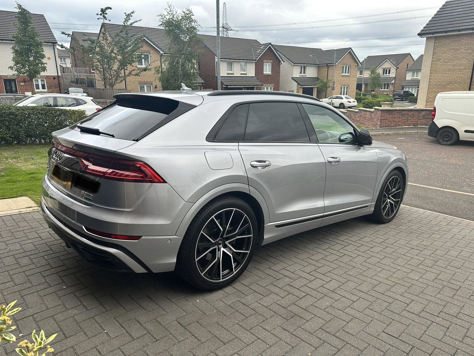

Nicola25 Posted January 21 Posted January 21 (edited) Audi Q8 - I’ve noticed the passenger side front suspension drops when the car is off. No warning lights and suspension moves up when the car has started and it’s fine to drive. It only seems to be when sitting for a long time. Could that be an airbag leak or defective pipe? Has anyone else had the same problem? Thanks Edited January 21 by Nicola25
