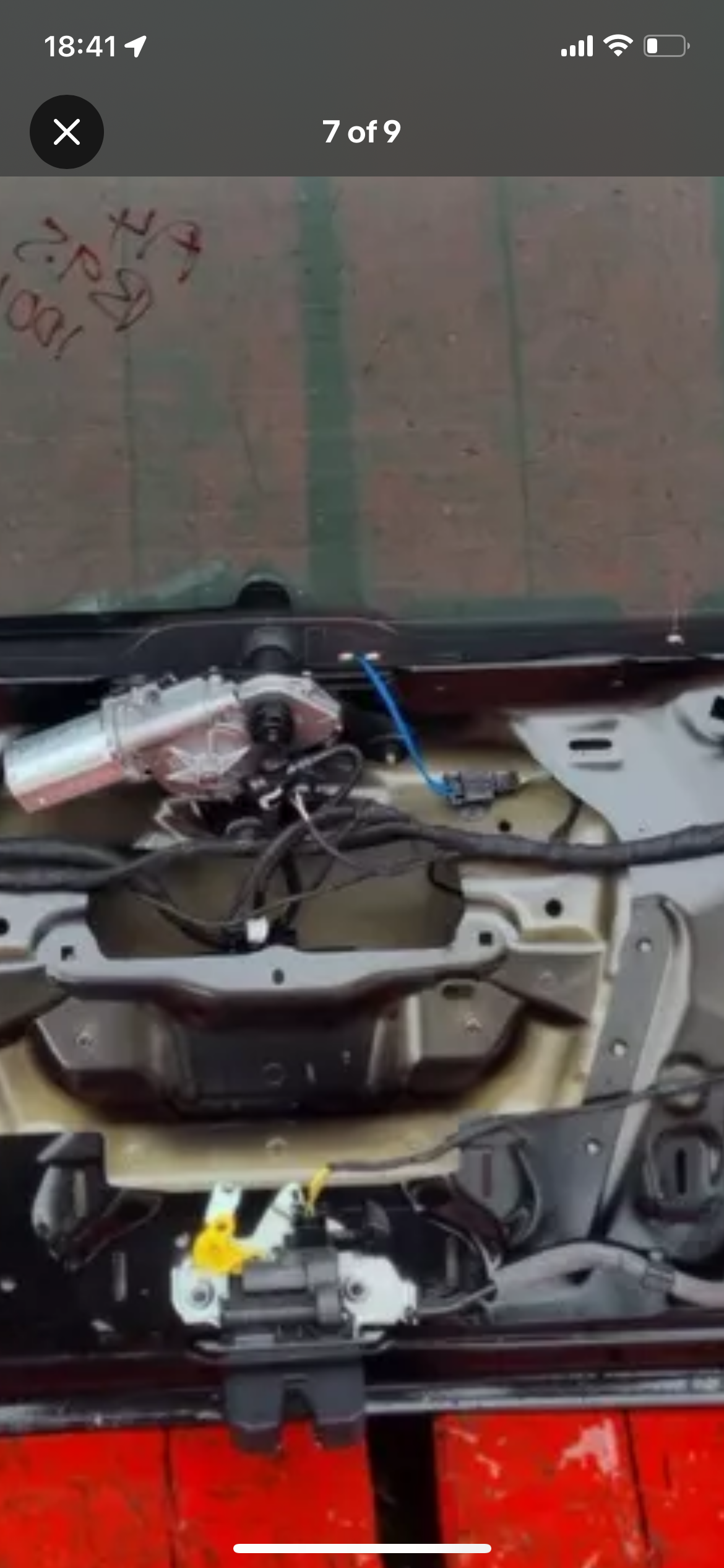

sburt93 Posted January 25 Author Posted January 25 16 minutes ago, Sid2020 said: From memory it’s the blue wires attached to the screen. You can just bridge the wires together to make a circuit. Some models also have these on the qter glasses Ahh! I noticed that i have two! One thats plugged in and one thats not but i cant see no cables to plug into 🤔

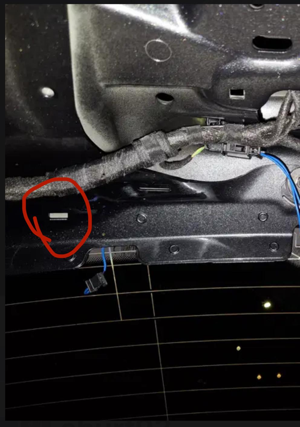

Sid2020 Posted January 25 Posted January 25 If you’ve had a replacement screen it’s possible that Audi only sell one spec glass for each tint and that would be the top spec so any extra connectors are just left unplugged as there would be no wiring in the tailgate for it. Upload a picture of what you have if you can. A diagnostics should also show up if it’s a glass sensor
sburt93 Posted January 25 Author Posted January 25 15 minutes ago, Sid2020 said: If you’ve had a replacement screen it’s possible that Audi only sell one spec glass for each tint and that would be the top spec so any extra connectors are just left unplugged as there would be no wiring in the tailgate for it. Upload a picture of what you have if you can. A diagnostics should also show up if it’s a glass sensor Ive just ran out and dismantled the boot

Sid2020 Posted January 25 Posted January 25 29 minutes ago, sburt93 said: Ive just ran out and dismantled the boot This is the hole that some modules slide into to secure to the frame and that spare wire would plug into that module. Might be for different markets depending on radio frequencies used
sburt93 Posted January 25 Author Posted January 25 Yeah i tried to look in there but nothing in there unfortunately🤔
