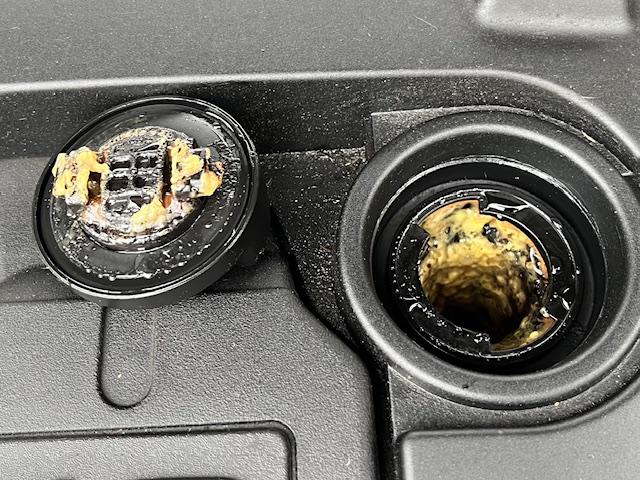

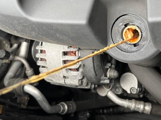

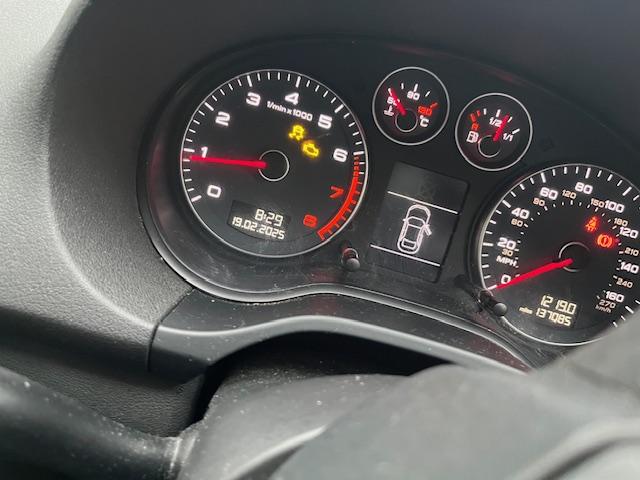

edd_jedi Posted Wednesday at 01:17 PM Posted Wednesday at 01:17 PM (edited) New member here, will try my best not to be one of those annoying people! Our 2011 A3 1.6 Sportback is running horribly and showing both the engine light and ESP light. A couple of weeks ago I noticed on a long drive it wasn't getting up to temperature (sitting at about 1/3 on the temperature gauge after an hour) and afterwards I checked the coolant level, which was fine so I thought maybe the water pump or thermostat may need attention, but didn't get round to it. The car has always had white smoke from the exhaust on startup and had a small amount of "mayo" on the oil cap, but we use this car almost exclusively for ~1 mile school runs, so apparently that's to be expected. BUT today the engine was running really poorly, idle was all over the place, and the attached engine lights came on along with an ESP error on the display (didn't get time to photo that before it disappeared.) I opened the bonnet, again coolant level was fine, but I checked the dip stick and was greeted with the attached! Way more "mayo" than normal. Obviously my first thought is head gasket, but I've spoken to multiple local Audi specialists this week and they've all said that is incredibly unlikely. None could look at the car til next week, hence why I'm asking here for opinions in the meantime. I don't have a fault code reader for this car. I'm mainly interested in opinions on whether this amount of water in the oil is normal (I assume not!) and what may be causing the rough idling and engine lights. The two may be completely unrelated and just a coincidence. Any help appreciated! Edited Wednesday at 01:21 PM by edd_jedi

Magnet Posted Wednesday at 02:38 PM Posted Wednesday at 02:38 PM Welcome Edd, and thanks for joining. There is a lot of conjecture about ‘mayo’ and jumping to the conclusion that it is a definite indication of head gasket failure. I would say in your case that it is certainly due to/ aggravated by unacceptably short runs, and the fact that the engine doesn’t reach operating temperature - even if the thermostat was serviceable - which it isn’t! The fact is Edd, this engine is having a hammering, and is likely to suffer from the equivalent wear that would be encountered on a car operated on motorways and having done say x10 times the mileage of yours. Before going any further let’s start with an important question:- how often is the oil changed and when was it last changed? Kind regards, Gareth. 2

cliffcoggin Posted Wednesday at 05:19 PM Posted Wednesday at 05:19 PM Edd. The normal amount of water to be expected in oil is none, zero, nil, nada. That you have had some emulsion from the time you bought the car 18 months ago indicates the engine was defective when purchased, so it is not surprising it is now a lot worse and is in urgent need of attention to avoid complete seizure. I suggest you stop using it immediately. Head gasket failure is the least probable cause of the problem, and would usually show itself with other symptoms. 1
Magnet Posted Wednesday at 05:55 PM Posted Wednesday at 05:55 PM Thanks Edd, Does the car lose any coolant? If not, then the emulsion cannot be arising from any head gasket issue, and is probably serious condensation due to short runs and a failed thermostat. If it were mine:- Get the thermostat renewed ASAP ( don’t know why you would suspect the water pump because the car doesn’t get up to temperature). Treat the car to an engine oil flush, new filter and fresh engine oil - I use VAG’s Quantum Longlife 3 , but change it every year on an average usage of c7K miles). Get the car read for fault codes. Please let us know how you get on. Kind regards, Gareth. 1
