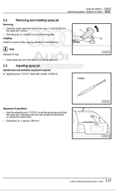

Steve Q Posted February 23 Posted February 23 Remove gently the cap from the back eof the nozzle is just slid inside, easy to remove with a Plier they are cheap in Amazon or similar. When you reinstall you can use a pick to adjust the stream so it lands perfectly ahead of the wiper.
