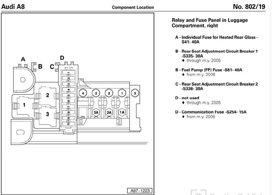

Kev-P Posted February 27 Posted February 27 Hi Jeremy, Does the below help? Not sure what year this is for but might be worth a look.

Jezzer46 Posted March 1 Author Posted March 1 On 2/27/2025 at 7:58 AM, Kev-P said: Hi Jeremy, Does the below help? Not sure what year this is for but might be worth a look. Excellent- will look tomorrow.

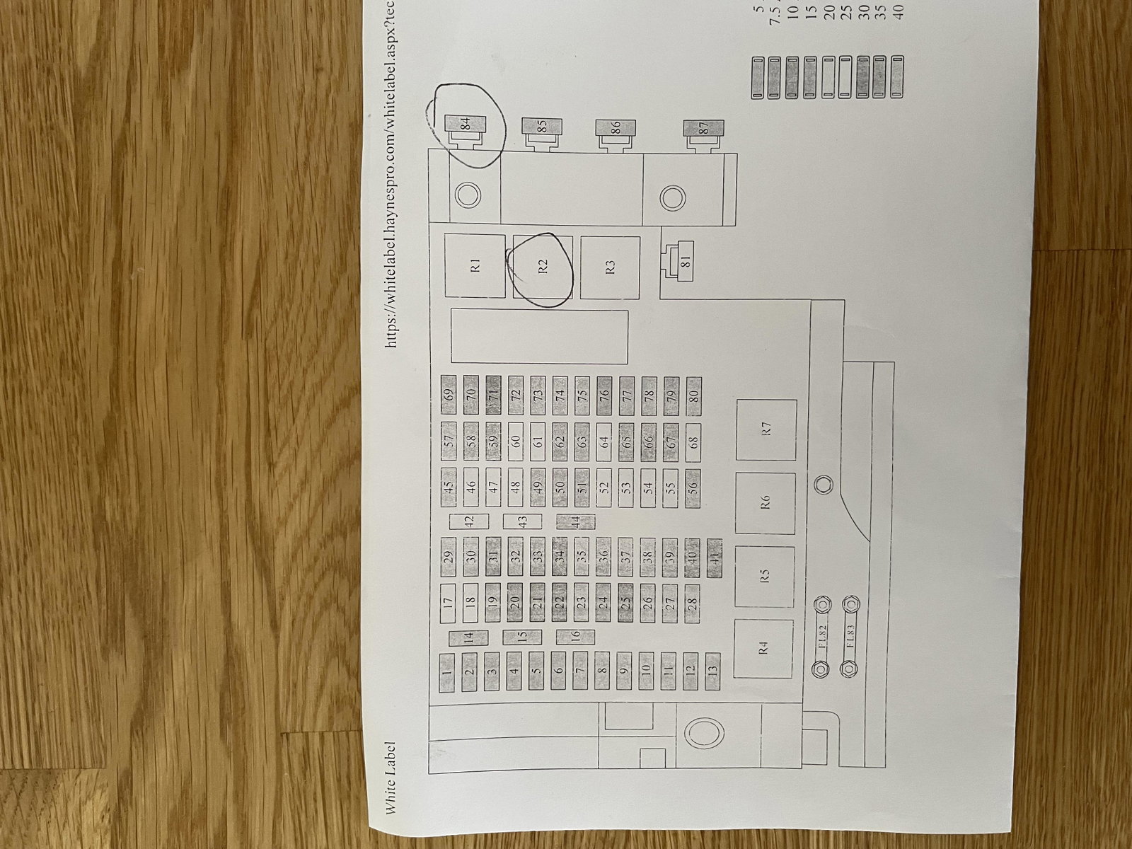

Jezzer46 Posted yesterday at 09:30 AM Author Posted yesterday at 09:30 AM I found out from my trusted local garage who printed out the attached layout (at no cost!) the locations of both the 40amp fuse and the appropriate relay. None of this info is in the owner’s manual. The fuse was OK so relay was the fault.
