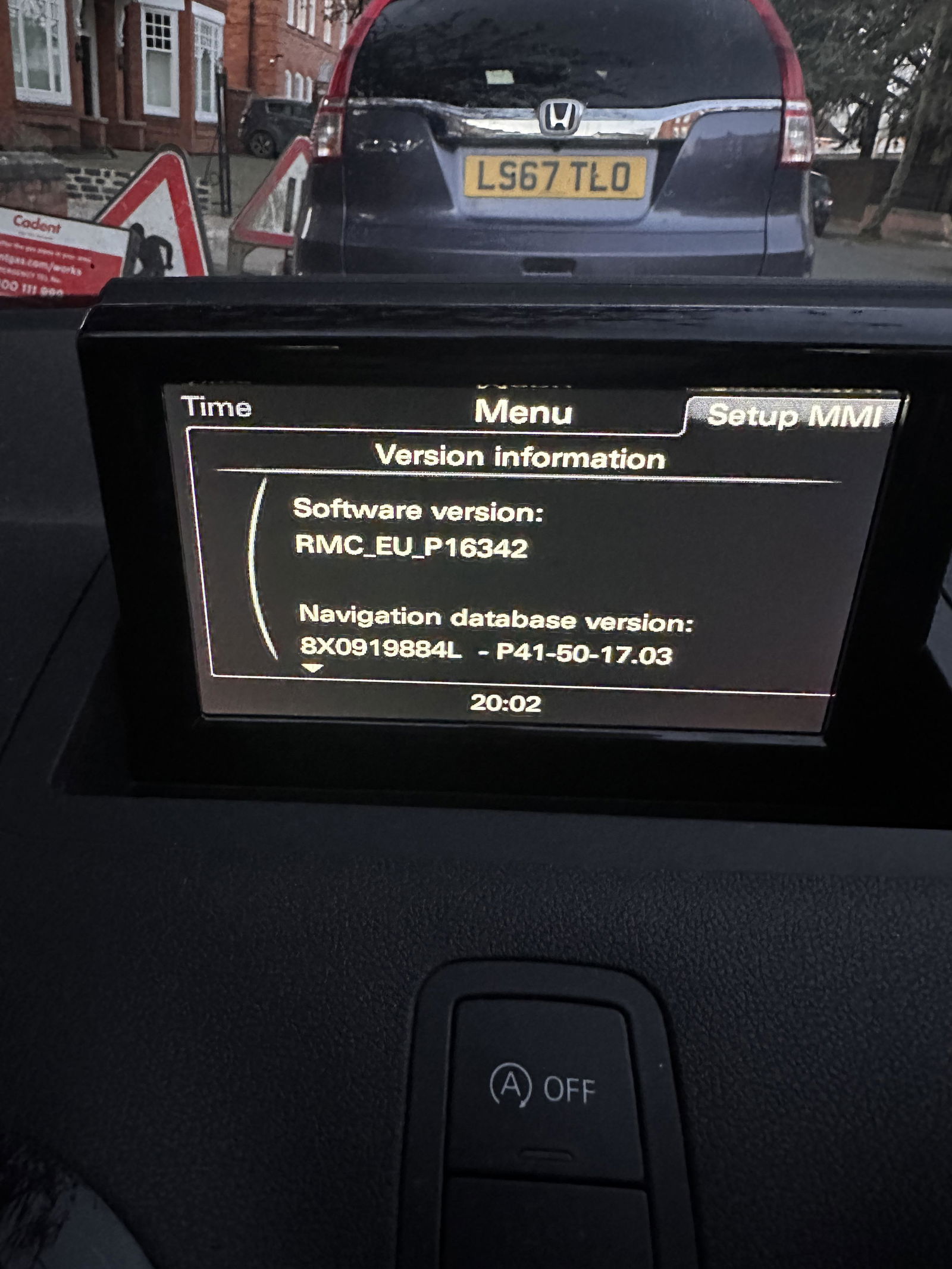

raycox Posted Monday at 05:27 PM Posted Monday at 05:27 PM (edited) This is my software version year is 2018 Edited Monday at 05:28 PM by raycox 1

Smithers01 Posted Monday at 08:22 PM Posted Monday at 08:22 PM (edited) Has anyone got newer software than 'RMC_EU_P16342'. My suspicion is that it is this firmware and lower having the issue. Seems like RMC_EU_P16342 is the latest RMC firmware. 😬 End of the day, the cars were sold having DAB support. If this is now not available due to a specific software issue. Audi need to come out and fix this free of charge. It happening on various car models 2014-2018. I will try and raise a support case with Audi UK tomorrow. Edited Monday at 08:40 PM by Smithers01

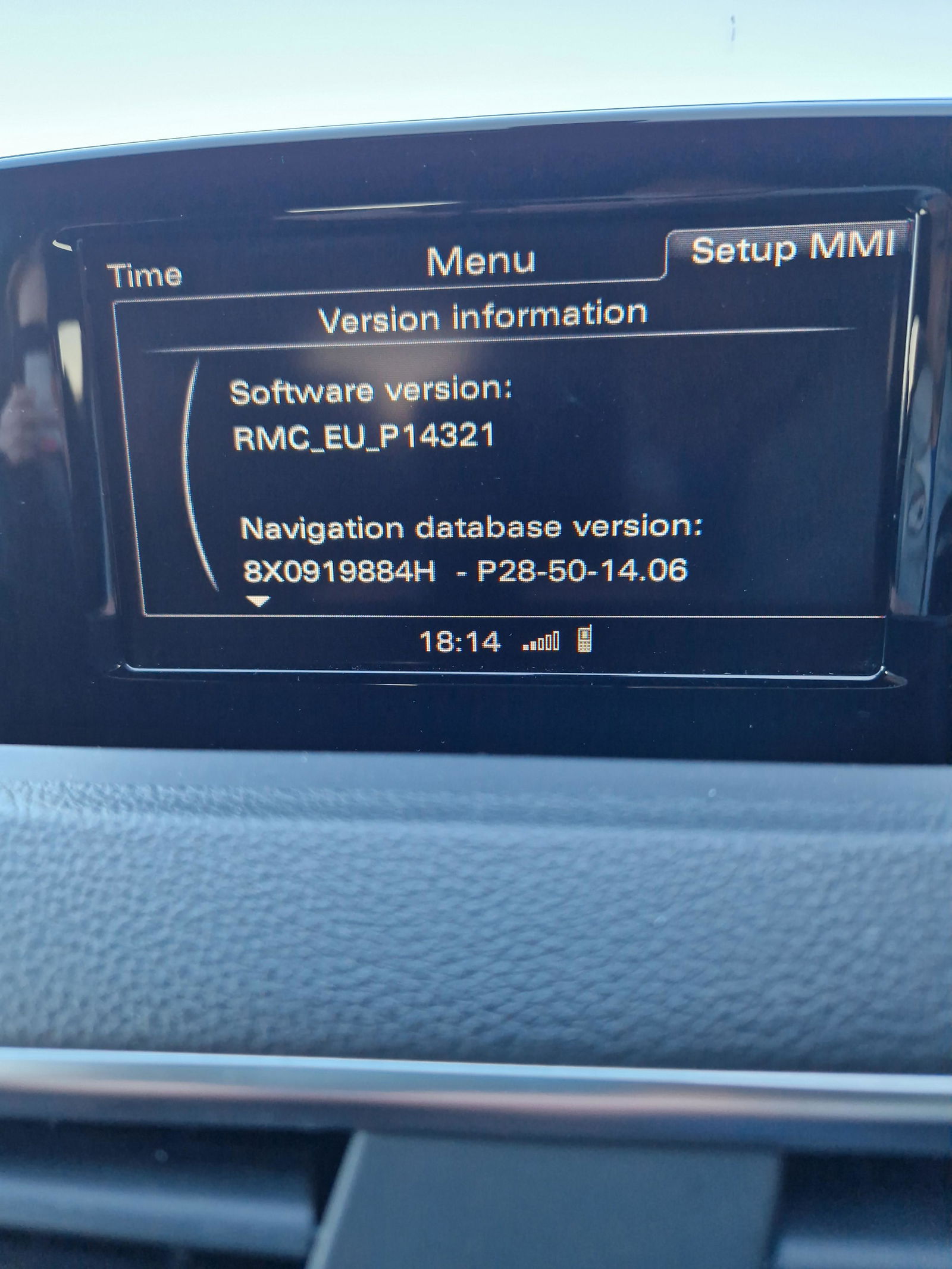

Mthom Posted yesterday at 06:11 AM Posted yesterday at 06:11 AM (edited) 2015 Q3 so looks like the software version is older, but same issue if no D1 national DAB stations Edited yesterday at 06:14 AM by Mthom Additional info

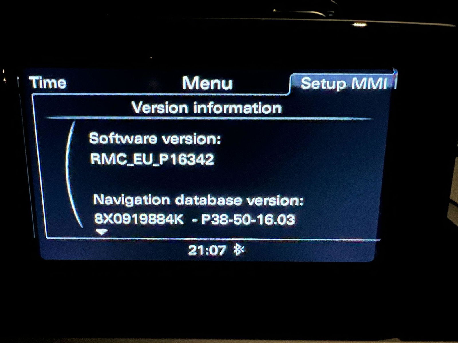

ROBK1985 Posted yesterday at 12:07 PM Posted yesterday at 12:07 PM Just to add I have a 66 plate Audi A6 SE Executive and mine too has had the same issue since early last week. Incredibly frustrating. Spoke to our local Audi Specialists where I take my Audi for all my maintenance works and they've heard of nothing so far. They logged onto their portal with Audi to check their latest bulletins, but there was nothing on there yet. Will upload a photo of my Firmware/Software Version later. Rob
