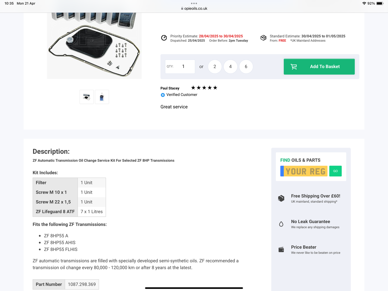

I am posting about the 2014 Sq5 gearbox, Audi claim it is a sealed unit and doesn't need servicing, but I am getting mixed opinions as to whether or not this does/doesn't need an oil and filter change ?
The car has done 98000 miles and I would much appreciate any feedback or experience with this 'grey' area!
