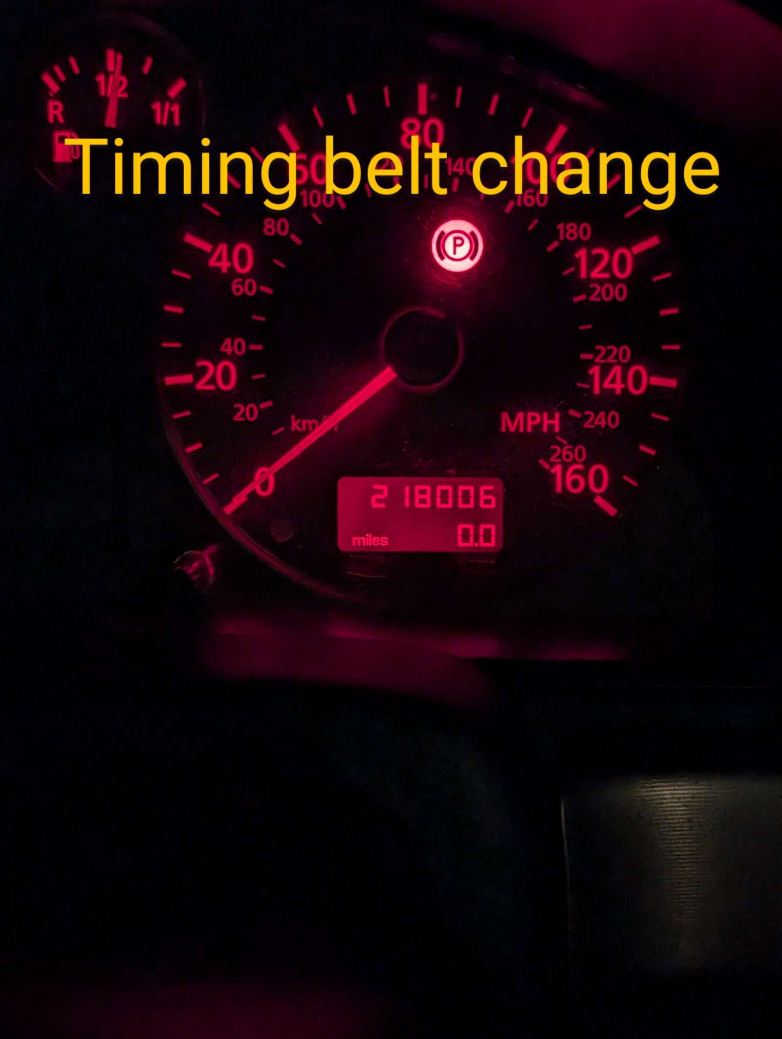

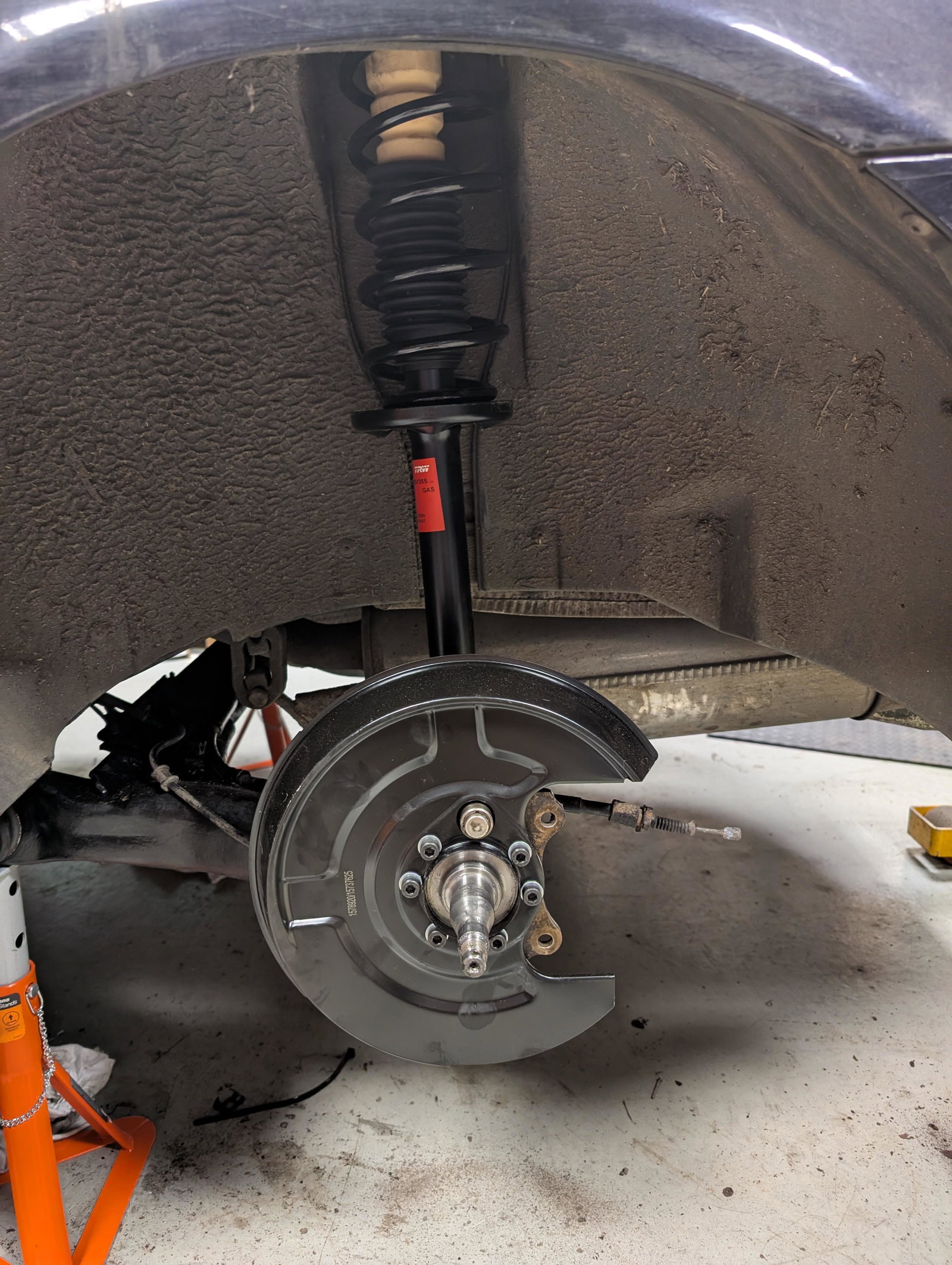

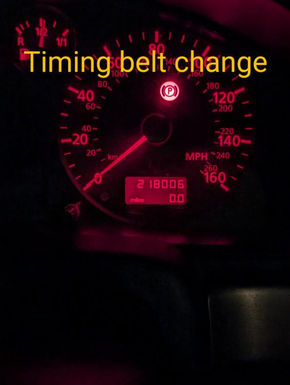

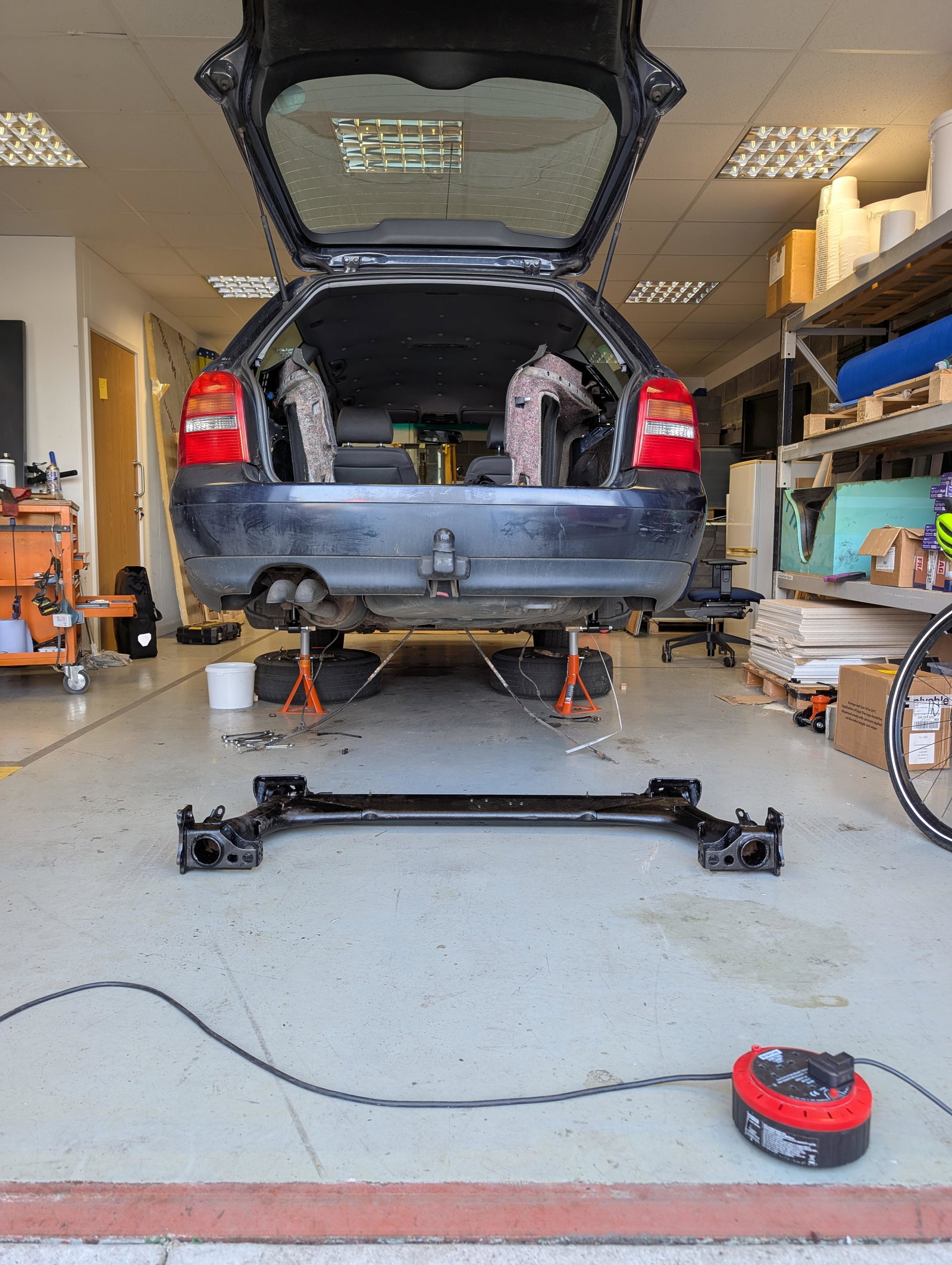

Thanks for the info. Timing belt done couple of months ago. Entire rear axel out and refurbished. Front is getting same treatment next week.
