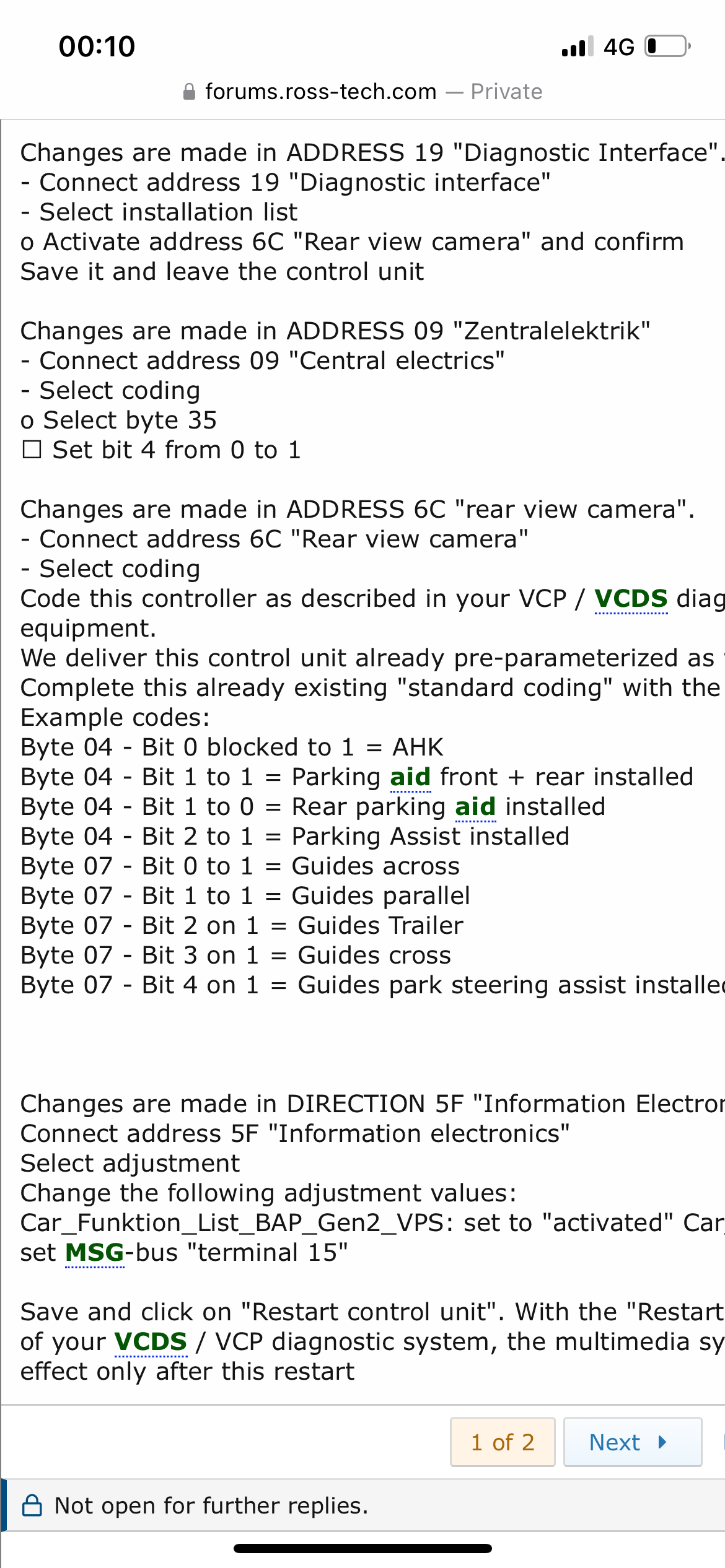

Sid2020 Posted yesterday at 10:35 PM Posted yesterday at 10:35 PM Most company’s include the coding in the cost of fitting the kit so the £300 starts to look abit better, I fitted a reverse camera to my b9 and have the equipment at my work to code it in but getting the parameters set correctly was a right pain
joe6 Posted 8 hours ago Author Posted 8 hours ago Thanks for your response. The camera kit I am thinking of buying has already been calibrated with the superimposed grid lines in the reverse view on the screen. I can do the coding and sdf acceptance using obd11 Pro. It is the cable routing and trim removal and refitting that makes me a bit nervous - so easy to break clips and crack trim.

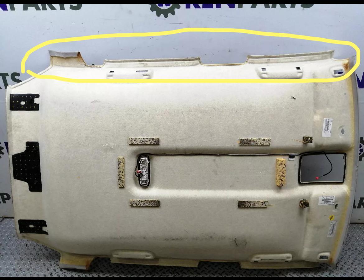

Sid2020 Posted 23 minutes ago Posted 23 minutes ago Think it took me a couple of hours but that’s what I do for a job, I would pop down the centre roof trim at the back to secure the wiring to the factory loom at the hinge. Il post a picture of the coding that got mine working properly eventually
