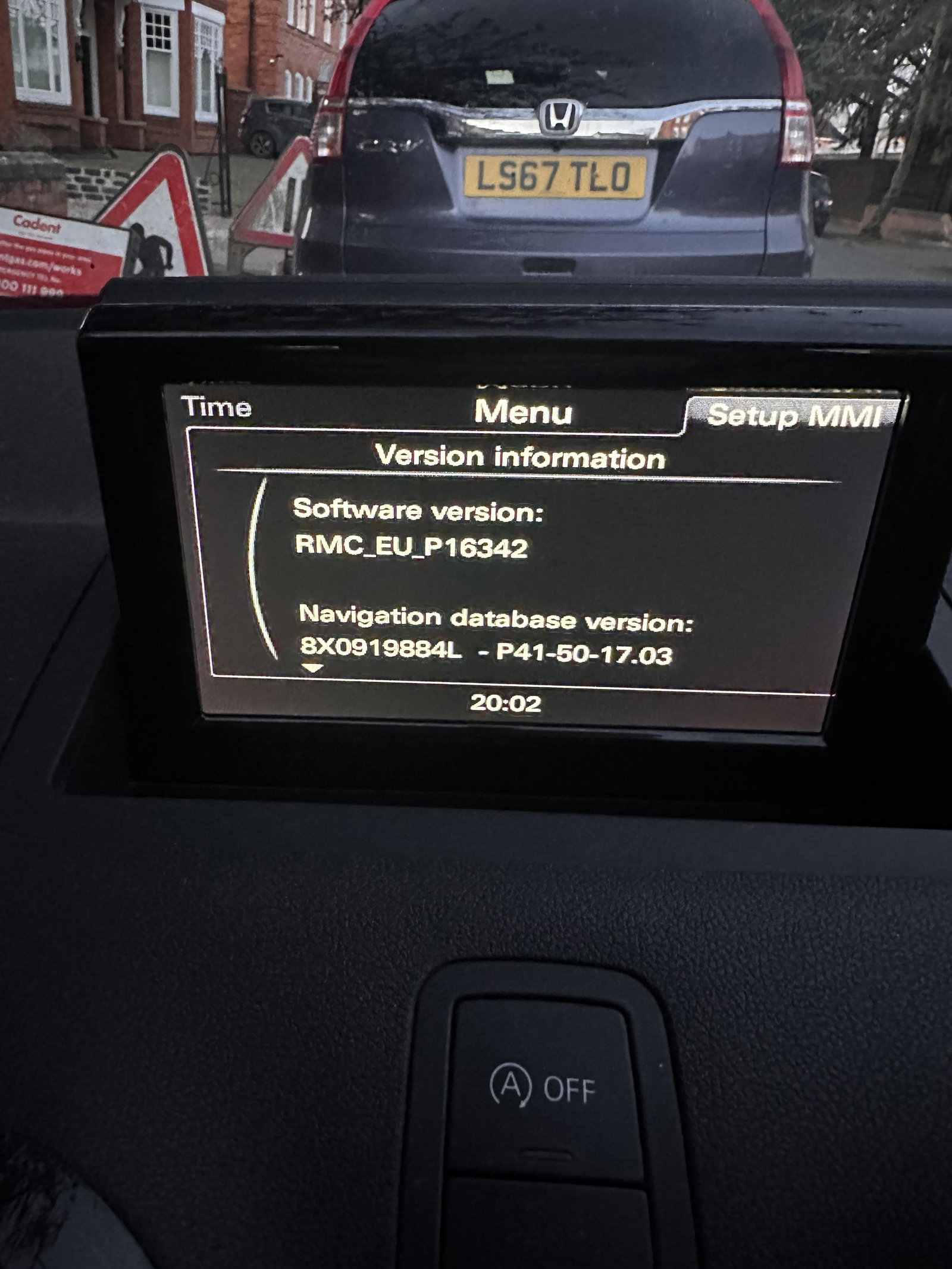

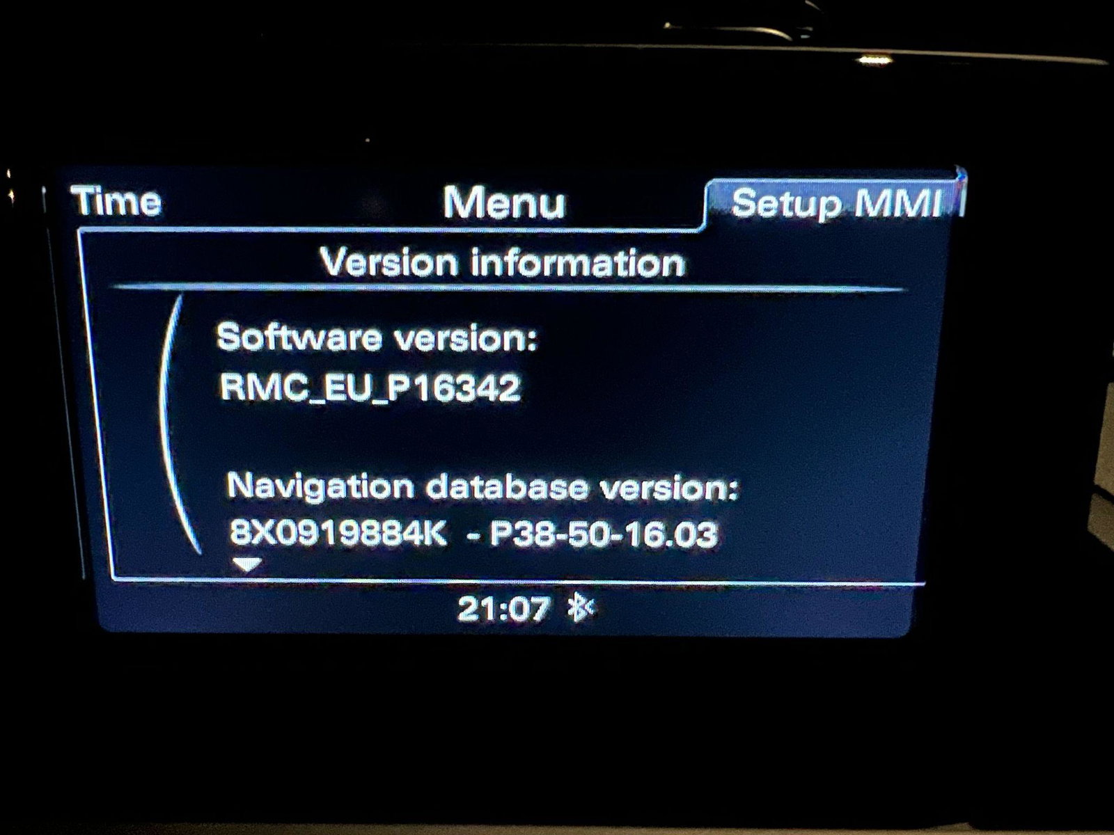

Please list your MMI software version and the year of Audi vehicle.

This is my software version year is 2018
Edited by raycox
Exact same software as Raycox
Posted (edited)
Has anyone got newer software than 'RMC_EU_P16342'. My suspicion is that it is this firmware and lower having the issue.
Seems like RMC_EU_P16342 is the latest RMC firmware. 😬

Will upload a photo of my Firmware/Software Version later.
