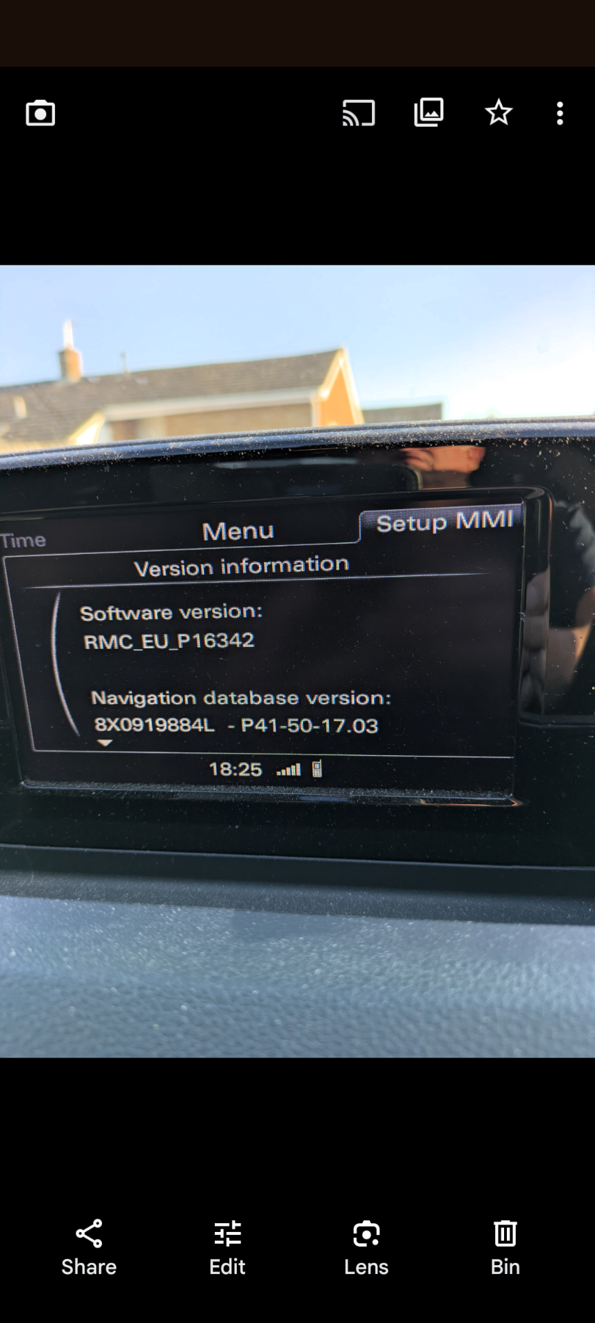

Chris Q3 2018 Posted April 8 Posted April 8 20 hours ago, raycox said: This is my software version year is 2018 I have exact same software as
