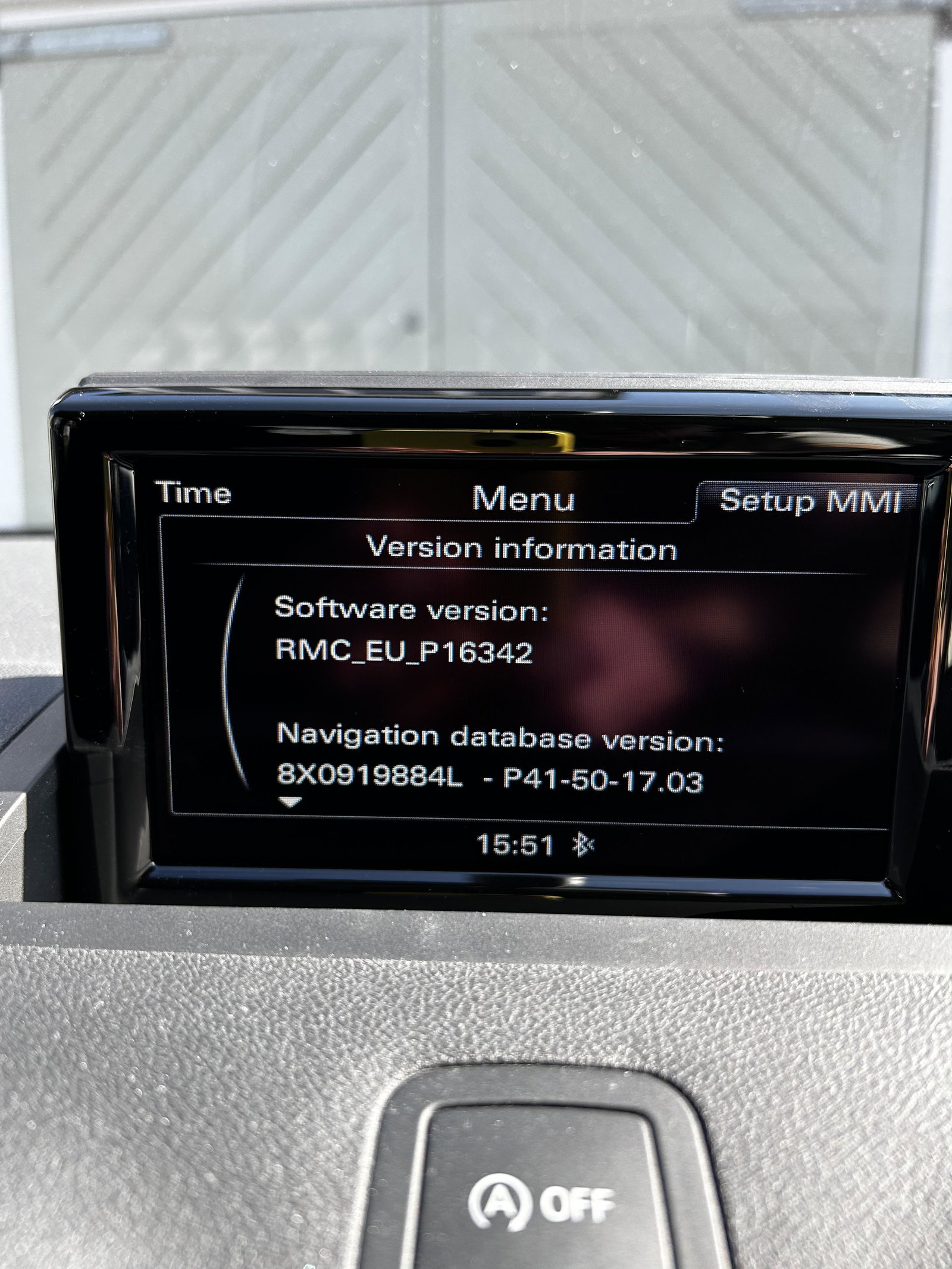

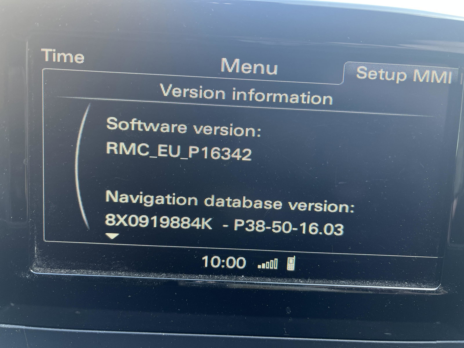

Richard E Posted April 9 Posted April 9 Just joined. Exactly the same issue here, DAB SDL stopped working about three weeks ago. Reception had been sporadic since 2023. It seems the radio fitted (Bose system) isn't DAB+ compatible. Mentioned it at my last service and was told no faults recorded. Like others here I'm on software version RMC_EU_P16342. DAB+ stand alone adapter under consideration ...

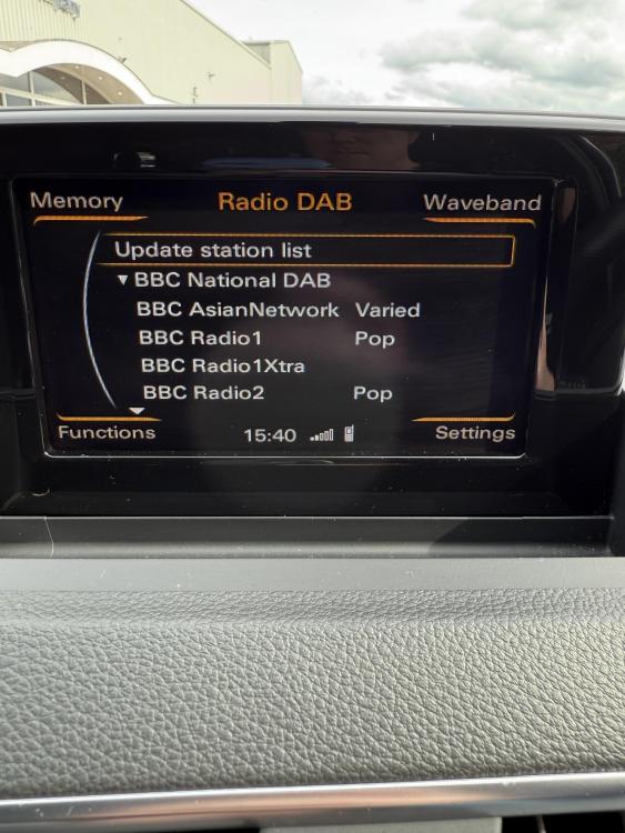

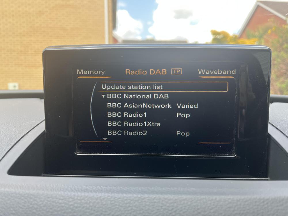

IanNI Posted April 9 Posted April 9 Same for my 2016 A6. I live in Northern Ireland so had assumed it was a geographical issue as I can still get local stations and all the BBC National stations but no Talksport/Radio X etc.

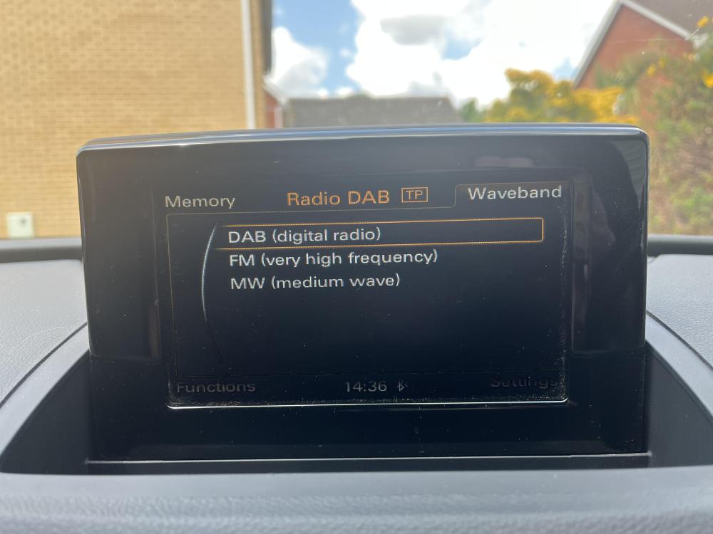

TonyF25 Posted April 9 Posted April 9 Just joined this group as I have exactly the same problem with the DAB radio on my wife’s 2018 A1. All the national DAB stations, with the exception of the BBC versions, aren’t available. I have been pulling my hair out trying to sort the issue out and it appears it isn’t just me! Let’s hope Audi UK can help. 🤞 1

DavidLincs Posted April 9 Posted April 9 Just joined having seen a link earlier and reading the messages . Exact same issue 2018 Q3 , drove to work 25 March parked up a week and when on return drive ( 1st April) not getting any of my favourites on D1 National or SDL National DAB . Still getting the BBC and some local ( ish ) stations on DAB . Very frustrating 🤬

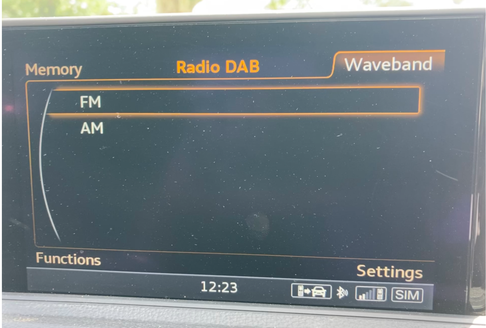

Rish Posted April 9 Posted April 9 My Audi Q3 2018 has the same issue - tried everthing- can't get LBC and few other stations. Volume control faded out whe trying to up volume. Other stations are ok ! Has anyone else had any luck with a solution? any help greatly appreciated. Thanks - Audi Q3 2018.

dmck12 Posted April 10 Posted April 10 im also experiencing same issue mines is an audi A1 sline year 2017, all fm channels seem to be working just fine but my dab channels randomly stopped working about week and a half ago, i booked in with my audi dealership for a diagnostics check which cost £150 plus vat and they have came back saying the dab antenna is on the back windscreen left pannel disguised as 2 small copper wires and as i have my window tinted this and general wear and tear over the years has caused this problem i would need to replace my back windsceen and was told roughly it would cost between 700-800 pounds if i wanted them to deal with it, i explained to them my car came with the back windscreen tinted and iv had the car for well over a year now and never had this problem until lastweek not to mention loads of other audi owners are experiencing the same problem all round about the same time so dont think this is what caused the issue but audi was certain in what they were saying, Then after reading posts on different forums etc its clearly nothing to do with having the back windscreen tinted or even general wear and tear as it is a widespread problem with audi owners at the moment so doing some further research on my own i found out the problem lies with dab changing to dab+ so audi was clearly wrong and just looking to gain £700-800 out of me ontop of the £150 +vat for a diagnostics check. Thankfully i refused for them to carry out replacing the back windscreen and saved myself being out of pocket as this would not have solves the problem regardless

Paul_UK74 Posted April 10 Posted April 10 Hi All, My 2015 A6 avant and my partner 2016 A1 avant have the same issue. I have done a bit more research into this and have even updated the firmware on both cars to RMC_EU_P16342 from RMC_EU_14321 on the A6 and RMC_EU_P1432B on the A1. Both units are also Hard Ware H61 My brother has a 2013 A6 avant and he has no issues at all, this does appear to be Audi vehicles that have the RMC MMI and I suspect it is going to be HW H61 specifically affected. I haven't checked my brothers yet, but his RMC MMI is definitely an older HW version than H61. I have been emailing a German company KUFATEC and they have responded back to me that their information held is that all RMC units have DAB+. I suspect that this is going to be a codec software issue needed to enable our units to encode the MPEG-4 High Efficiency AAC v2 profile (HE-AAC v2) The A1 and A6 MMI manual both state that DAB+ is supported.
